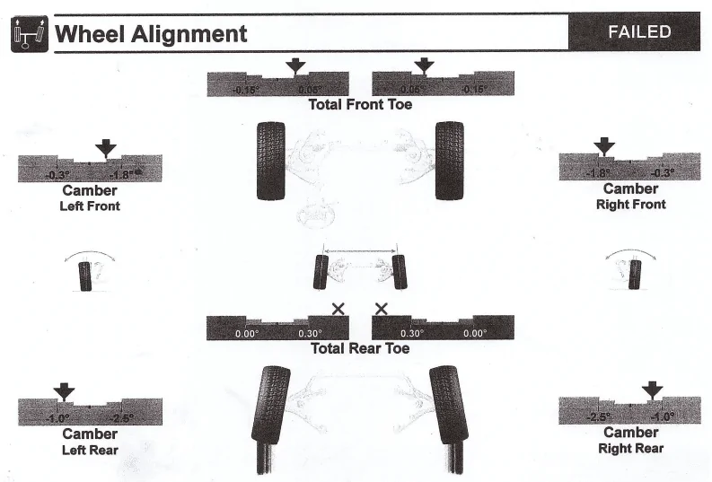

My favorite part of this whole mess was what the dealer tech put on the front of the invoice when we asked to have the alignment checked after being made aware of the condition of the rear tires.
S650 Mustang WARNING: Check Dark Horse alignment on delivery nonsens
While providing us with this printout (compared to Mach 1 Handling package as the Dark Horse was not in the computer yet)
S650 Mustang WARNING: Check Dark Horse alignment on delivery nonsense2
"The alignment of the vehicle is correct. Vehicle designed as a track car"
OASIS and the follow up alignment check with a 3rd party vendor has shown this to have been a lie. Just get your alignments checked people.

Here are the specs from OASIS. Dark Horse with Handling Package on the 2nd page. Feel free to compare to the spec as delivered in the first post. Tires may be soft and expected to have a short life, but the deck is stacked against them having any chance for longevity with an alignment so far out of spec.

And they wear more than twice as fast when your alignment has about a degree of toe in. I am trying to let people know the cars are shipping with jacked up alignments. Toe setting more than 3x's out of spec, caster about a degree different on either side, front toe setting ready to do right turns only. Don't assume the car being darty or twitchy is because it is wearing track tires like I did. And ask for an alignment check before you leave the dealership upon purchase. My front Trofeos are at 6/32, my rear are at cords. At most, if the car was aligned right, with the tires being soft, the rear would have only wore about 1/3 to 1/2 faster. If I would have taken these off and put on anything else, I would have a terrible wear pattern on the tires I would have spent money on. So then my $1800 worth of Michelins would have been on start to be ruined.

I think we all need to check... my Ecoboost was well out of alignment too. Rear toe was more than 3 times the spec! Also front toe to the right. I got everything set where it should be... except caster is still not the same on both sides.
