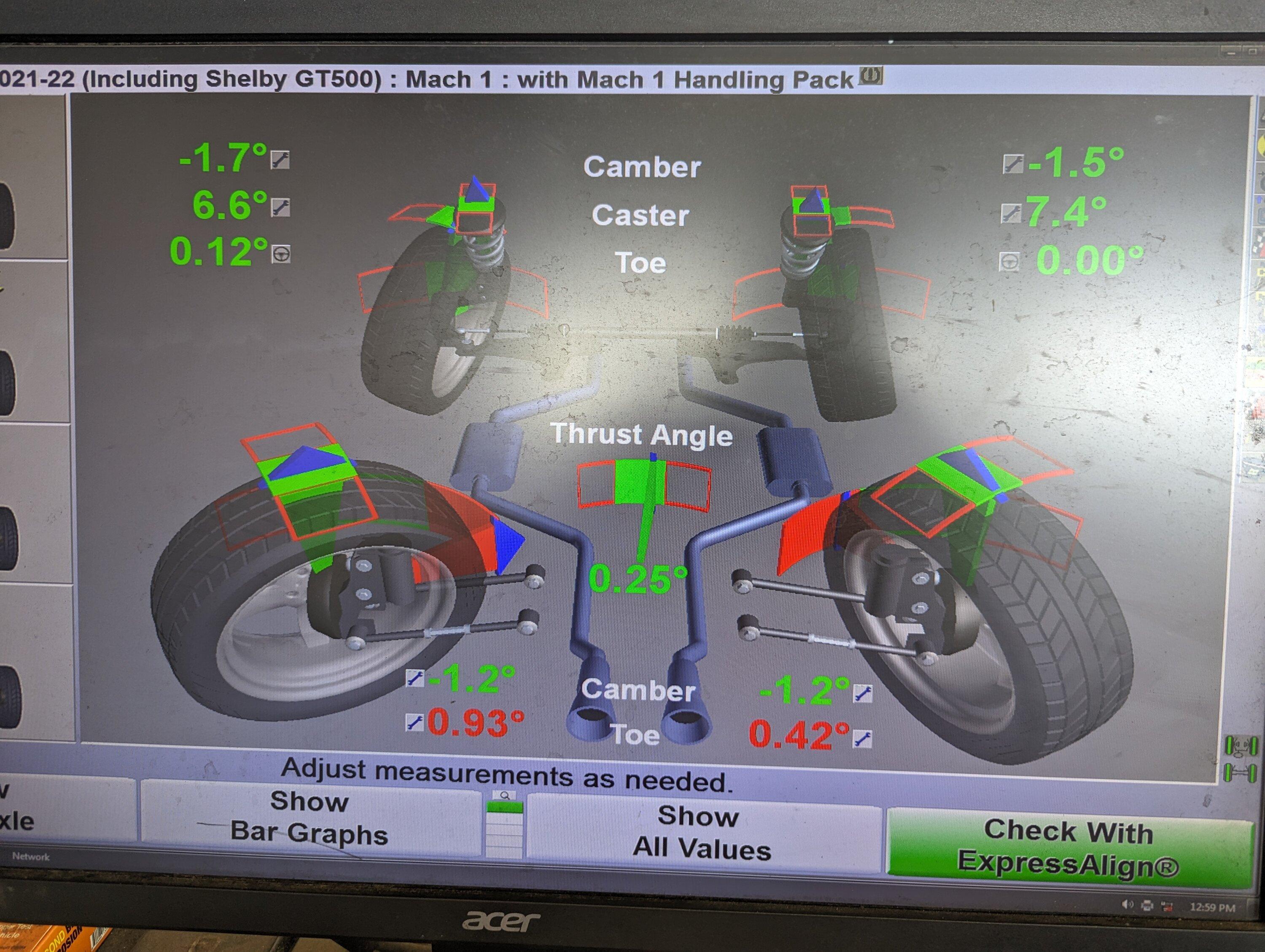

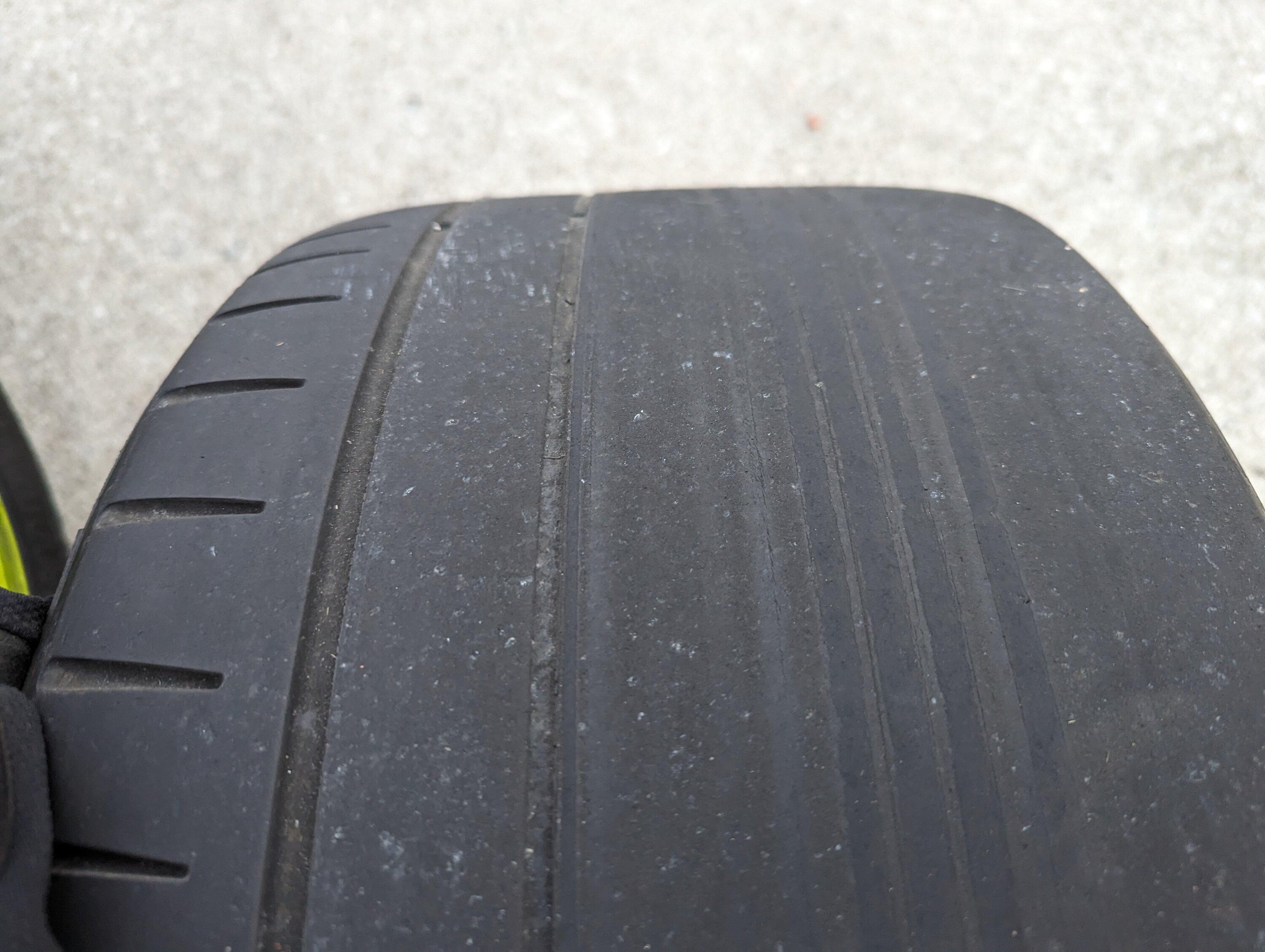

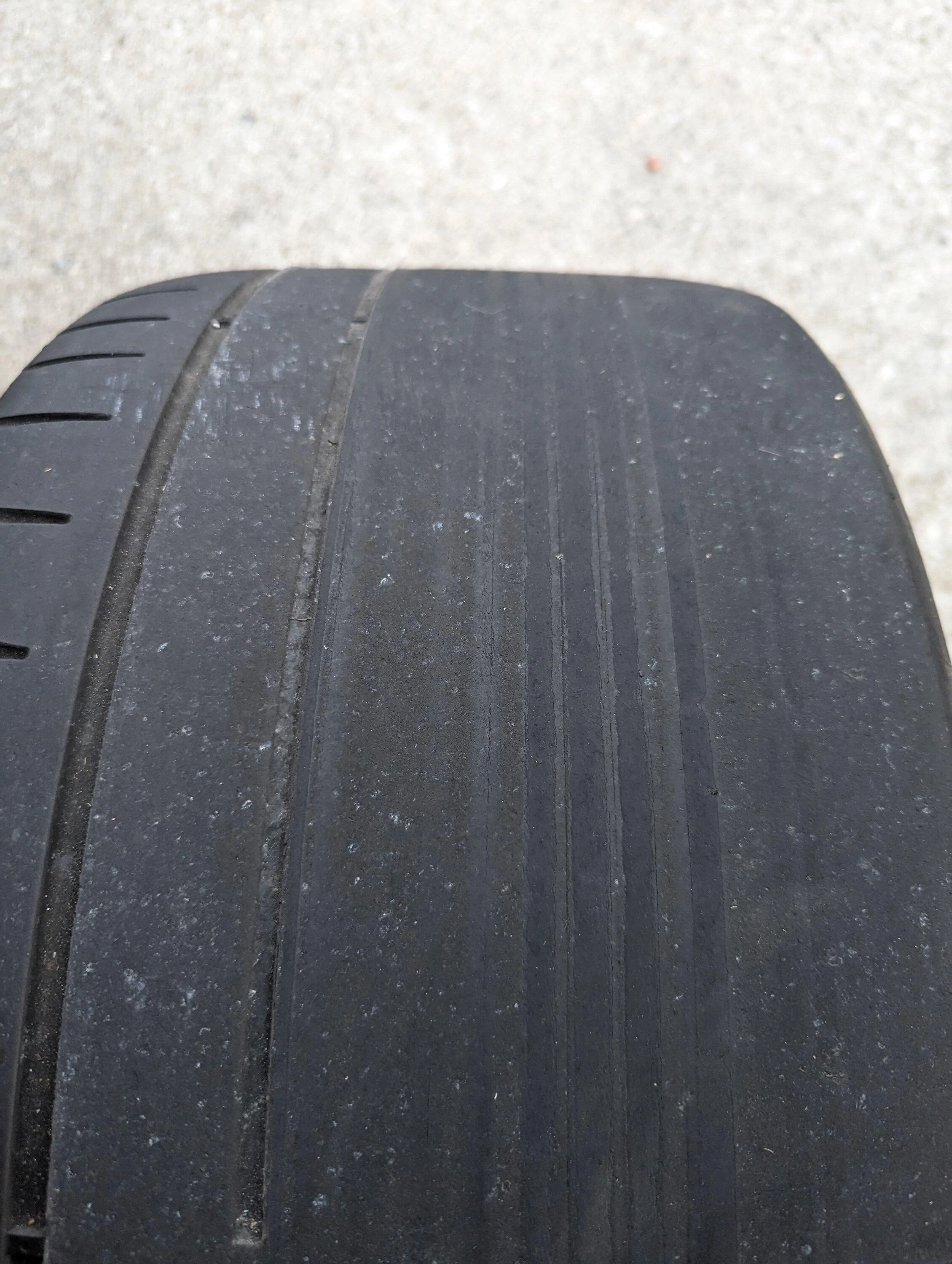

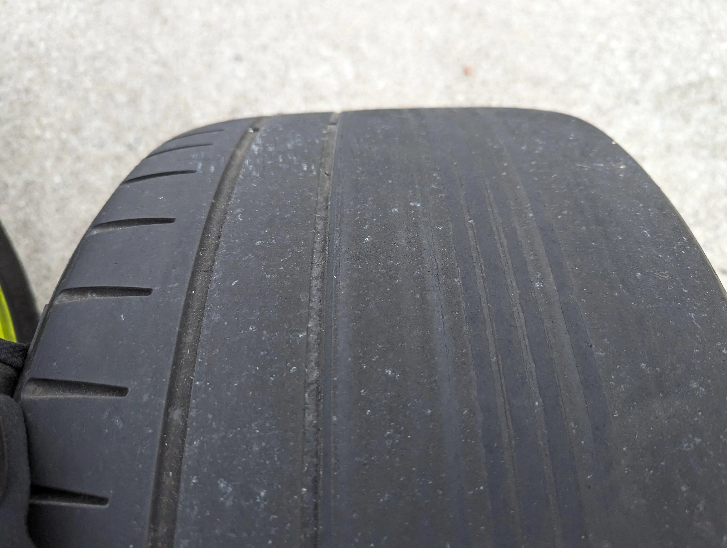

I will preface this by saying I am a 50 year old mom. I got my car 9/19/23. My husband drove it on a trip to his hometown for Founder's day and to visit family. 700 miles. I then drove it on a trip with the kids to the mountains to see the trees and to some other sites. Another 700 miles. The owners manual said 1000 miles for break in. Since I was now at 1400, I took it for an oil change for after break in and they told me I needed 2 new tires. I hadn't even gotten to redline yet, definitely not spinning them. Sure enough, the rears were wore except for the inside edges. So I took it back to them again and asked to check the alignment. They said they couldn't get it on their rack. They hooked it to a quick check that showed it was out. Then told me it wasn't even a street legal car and the alignment was set up for drifting and it would just wear tires. I am now about to show cords, so I can't drive it. Haven't even made a payment and I am needing $1300 in tires. These should have lasted at least 5k miles. I took it to a tire store, they hooked it to an actual alignment rack and it is nearly a degree and a half toed in in the rear. I found another dealer that can fix the alignment tomorrow, but it still has no tires now because someone screwed it up at factory or shipping. I want to find a regional rep to show, and at this point, I think I need to tow it to be safe. @Ford Motor Company any suggestions?

Either way the alignment didn't kill those tires that quick. Those tires would have been done even with a perfect alignment.
You need a different compound, or youre going to be replacing tires very often, even after your alignment.

Dont let the outer edge fool you into thinking that your tires would look that way if it was properly aligned.
Your tires would have looked slightly better, but they would have been on their way out

That is the INNER edge of the tires that have tread still.

Looking at your photos and judging the wear patterns only, the alignment does seem a bit off, but not horribly so.
If it's any consolation, you did fine. You took those track tires for everything you could.

I actually sold tires, wheels, alignments, suspension for 6 years. I know the difference between types of tires. I also know irregular wear patterns. What you can't see in the picture is a feathering happening on the last inside tread patterns indicating toe issue. That's why when I looked at them, I went back to the service and asked for alignment check. That is nearly full tread depth on the inside. As we were following break in, we did not drive aggressively or spin. Hell, I have a nearly 20mpg average to prove it. (gas guzzler tax my ass, better than my F150). The fronts are measuring about 6/32, so these started at least there, maybe a bit more. There is some feathering of them from that toe out. Toe settings are supposed to be .15 +/- .20. When you start going to a degree instead of a tenth, it will wear excessively. And the difference in what these looked like at 1400 miles versus 1500 miles proves it. (I have more pictures). Also, that front caster is nearly a degree split side to side. This car has been very darty on the road, I figured it was the aggressive tires tramming the lines. I think it will be way more fun to drive when fixed. I know the alignment Ford covers for first 12/12k. So no questions there. I do feel they need to help me with some tires since those were not all my fault.

No matter how bad you think the Trofeo RS tires wear, the issue is the alignment shown. ANY tire would be destroyed in short order with the rear toe settings that the car had on it from the factory. They are WAY out of spec for what is shown in OASIS. Like the title said, get the car aligned when you take delivery.

Here are the specs from OASIS. Dark Horse with Handling Package on the 2nd page. Feel free to compare to the spec as delivered in the first post. Tires may be soft and expected to have a short life, but the deck is stacked against them having any chance for longevity with an alignment so far out of spec.
