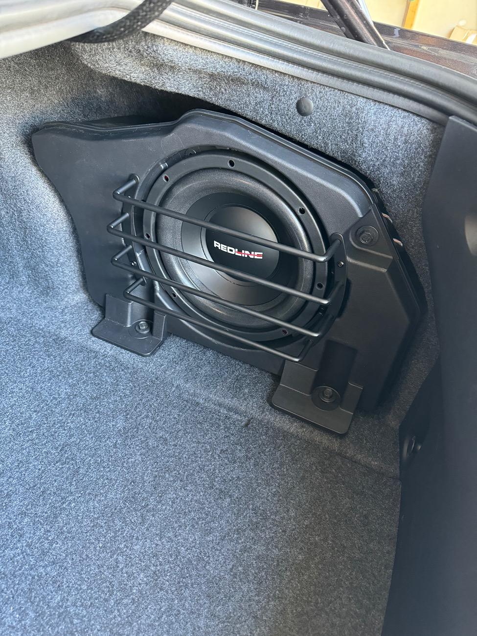

anybody here swapped the B&O Sub for a Pioneer? If so, has anybody noticed a difference? Swapping the speaker should be plug and play right (with minimal wiring)
The setup is identical to the S550 in the thread mentioned above. Very simple cheap upgrade which improves the sound quality considerably.

Think it’s worth it to run a 2 channel amp with a 10 inch pioneer in the stock enclosure (w polyfoam) and grab signal (LOC converter) from the subwoofer wires?
The enclosure is the weak link. I have polyfil in mine but it still cracks at higher volumes. I’m taking it out this weekend to dynamat it to see if that helps. If not I will have a custom enclosure made.
You will get a significant sound QUALITY upgrade. If you want thumping bass you will need an additional amp.
Your idea of sound quality must be extremely low. Just adding a sub is not a significant sound quality improvement, lmao.

I know, I need an aftermarket 4 channel too. The B&O isn’t too bad. I know a better 4channel can probably get me better highs but I don’t want to mess with the system too much. Just want simple upgrades to make a bit of a difference. I pulled a custom made box I had in my 15 mustang w 2 12 inch subs. That bass used to be nuts….. but I had to remove a deck lid speaker and space the seats to hear it.
i guess my main question is if it’s even worth it to swap that sub out and reuse the OEM enclosure?

I’ll get back to you regarding the factory enclosure this weekend after I dynamat it and test it. The enclosure is pretty thin plastic and it does flex enough that you hear the difference. I’m not sure how much the dynamat will help but it’s worth a try

So, adding the dynamat to the enclosure and removing the factory grille is definitely an improvement. Now it sounds as it should, without the flexing and popping at high volumes. It hits hard enough you feel it through the seats.

Are you running a separate amp or just the sub?

how about adding a 2" port with a tube extension?
I don't think it would give you the desired effects due to the small size of the enclosure.
Fruitstang
Jan 7, 2018
209
100
2016 Mustang GT Convertible
Such a tube normally should be calculated to increase volume at a specific narrow frequency range.
Then it can actually help smaller enclosures to be louder.
Check the net for speaker calculations and find the so called Thiele-Small parameters and others for your specific sub speaker.
Also size of the specific enclosure should be known.

You won’t get much of a difference without adding a amp
I definitely disagree with Stangerous on this. IMO, replacing the stock sub with 10” options from Pioneer or DD makes a huge difference. Stock amp is fine to drive either of these units.
Will it sound better with a dedicated amp- of course. I understand completely the quest to produce top-notch sound in a car. But dropping in a 10’ aftermarket unit takes less than 45 minutes and about $100-120 bucks and makes a dramatic difference in bass volume and quality versus the stocker.
