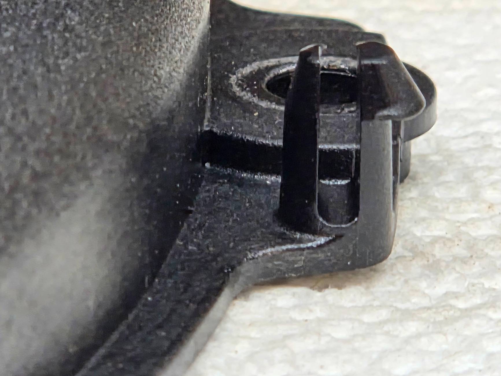

I am going to try to use my headlamp to pop the cover clips at their point of contact with hopes they do not break.
If your not going to use the orginal grill, it doesn't matter. You can attach the trim ring using double sided tape and the 4 bar grill will hold it in place. However, if you are going to use the orginal grill, this is the pin (1 of 6) that you need to release. A small flat screw driver and push on the side of this pin, then pull on trim ring.

I just rotated the Pioneer ever so slightly and drilled new holes in the sub box, rotating the speaker put the new holes nowhere near the stock holes. Then I put on the new trim ring and 4 bar grill. Looks cool, and made the job 1/2 hour instead of 2 hours. You can’t notice the Pioneer logo is slightly uphill.
If you go that route, just be sure to drill the holes real small, so the new screws have more bite.
Be prepared…the new sub won’t be any louder, but all the rest of your speakers will now sound louder, clearer and have more bass. It’s a weird trickle down effect Supposedly because of less bad resonance that the OEM sub produced.
