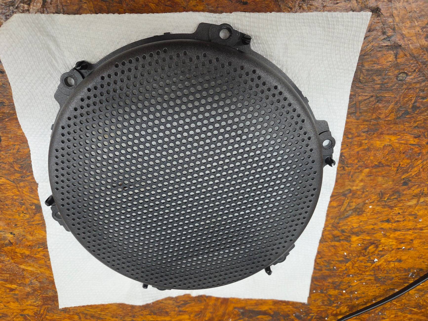

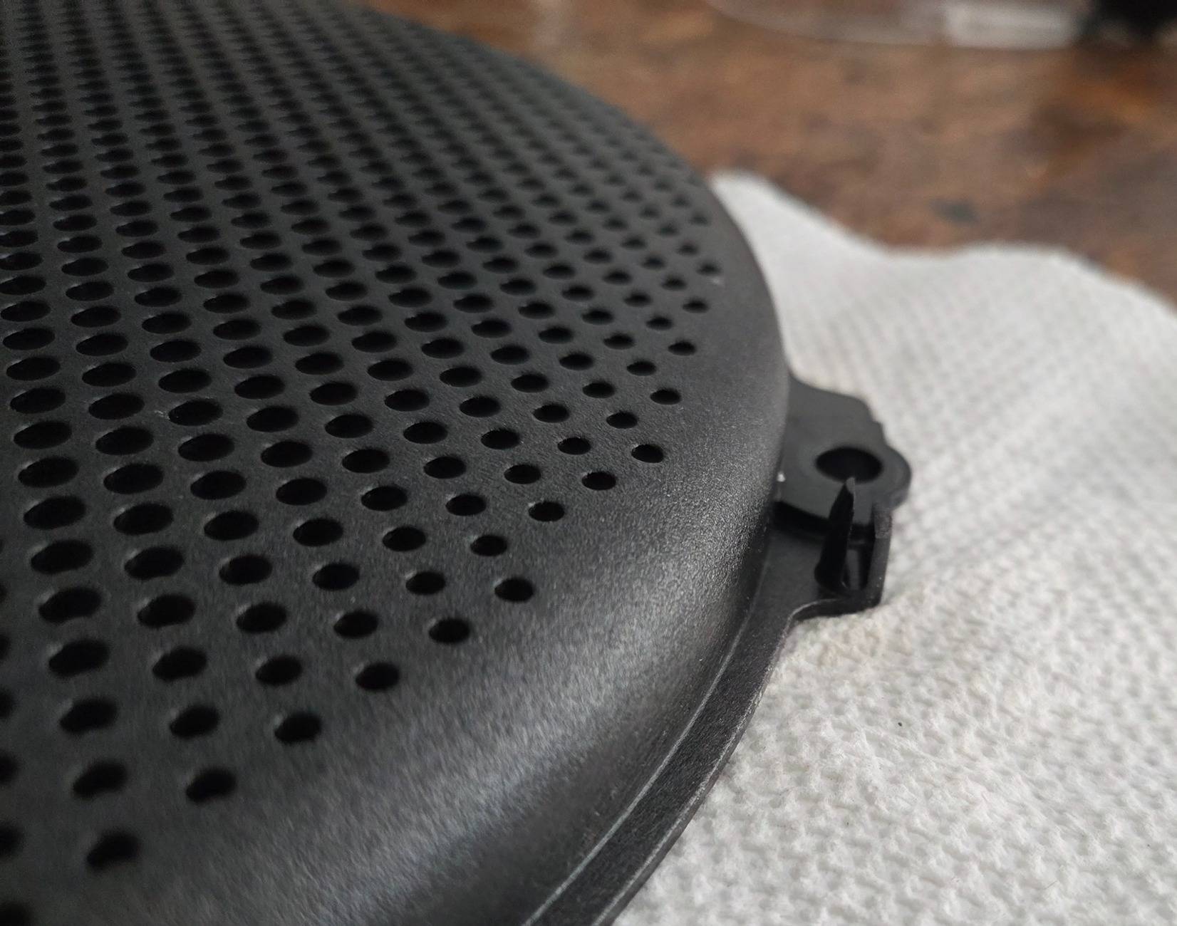

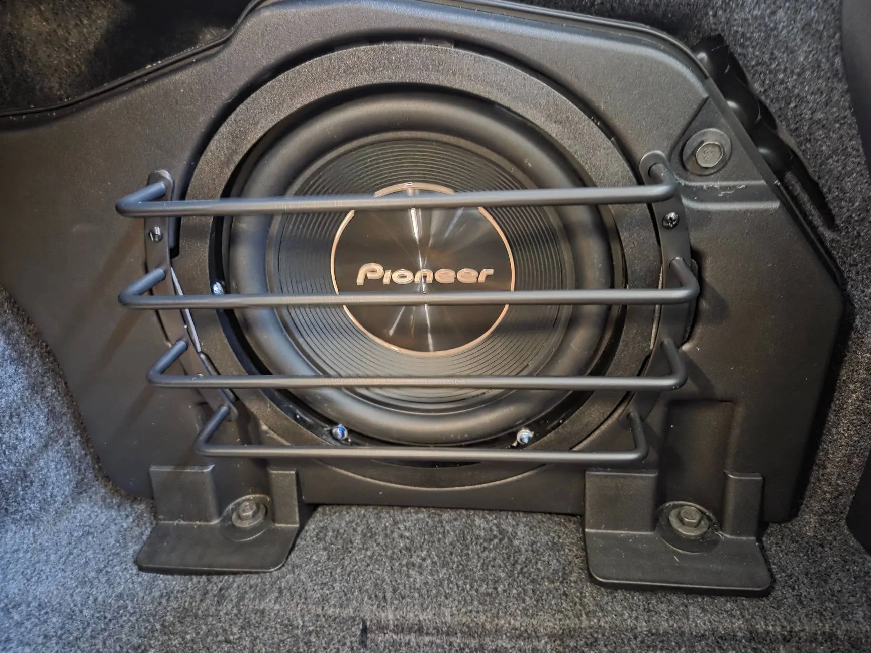

The factory grill uses the same holes as the speaker. I also believe it will not work with Pioneer hole pattern. I use orginal holes as well and the stock trim ring. See pic below. And I tried to show the front of the grill were the stock trim ring attaches to the plastic pins. I fid an excellent job in breaking every one of them. But you can see the pins and their orientation to try to push before pulling.

I replaced the sub today. Not a hard job, but a little more work than I thought.
Couple of tips for you guys -

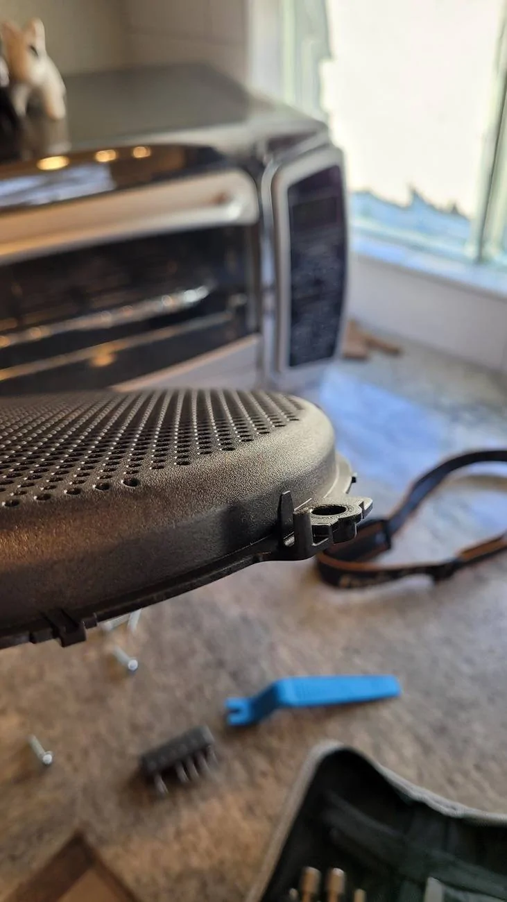

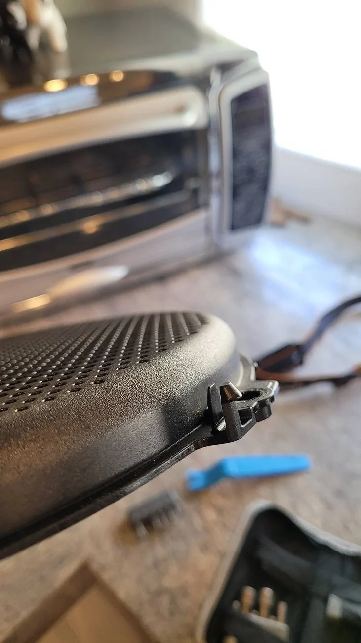

1. It's really easy to break the clips on the outer ring. I didn't totally understand how these worked, but once I got it off I realized you can a get a small screw driveer and push in each tab from the outside of the ring. Just get a headlamp and you can just barley see them.
Broken ^

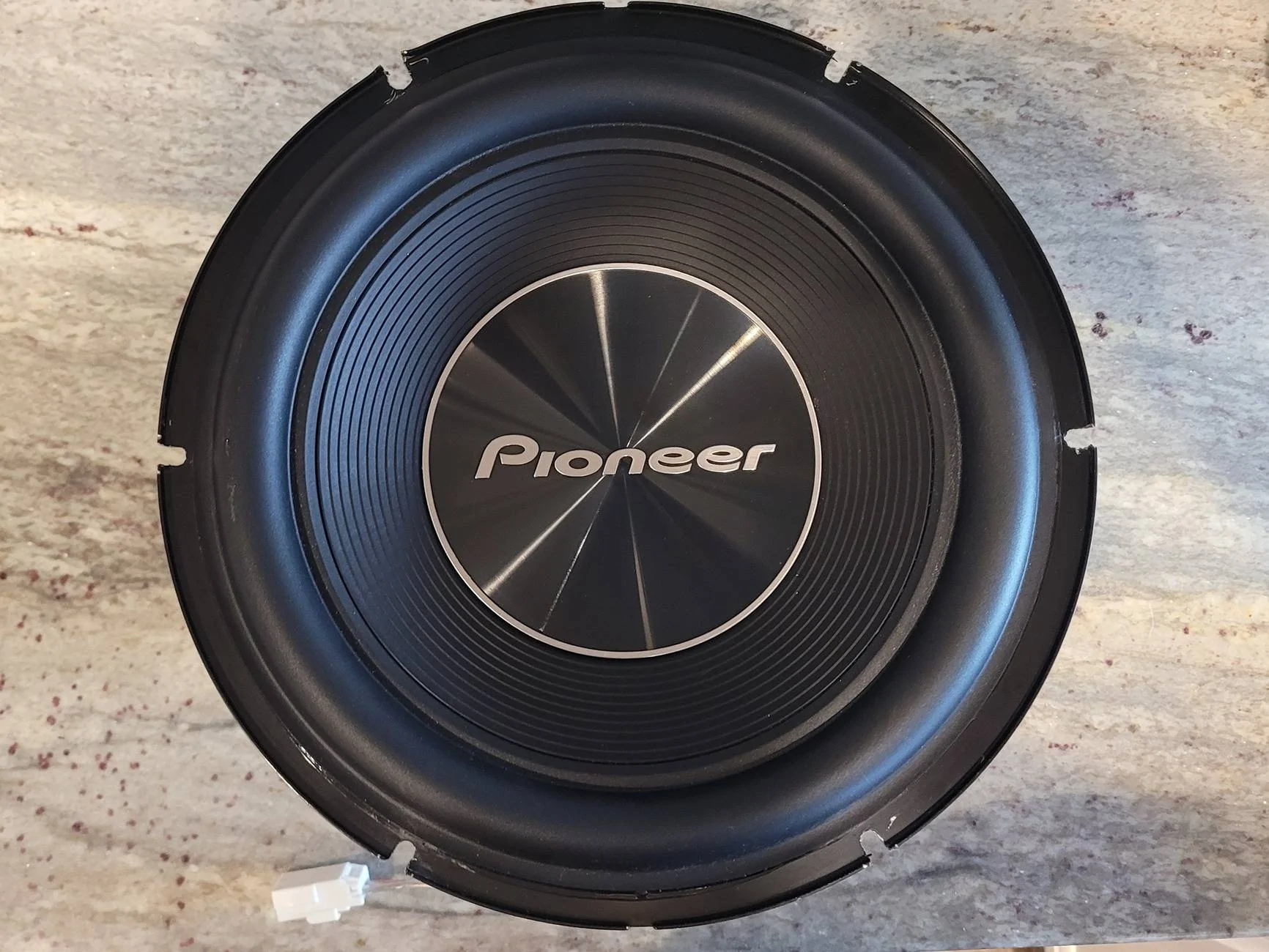

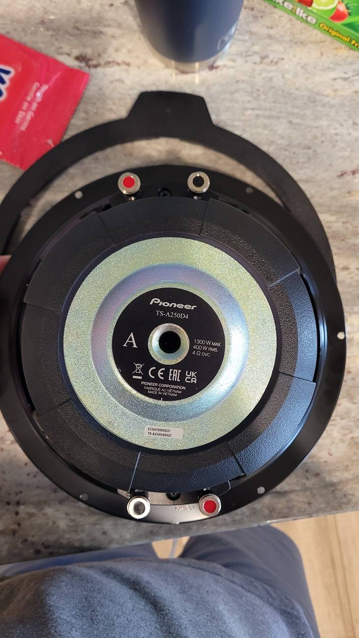

2. Cutting the holes out of the new speaker metal to use the factory holes was way more involved than I thought. This was by far the most time consuming part. I used a dremmel and cutting wheel. You'll need to cut it like this in order to use the factory holes and screws.

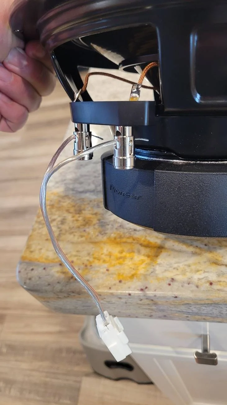

3. The extension wires are really easy. No need to worry about all the different colors. Just put the red wire of each extension through the red/positive clip on each side of the speaker. The other is goes to negative. You can't flip the extensions when attaching to the factory clips. They only go one one way.

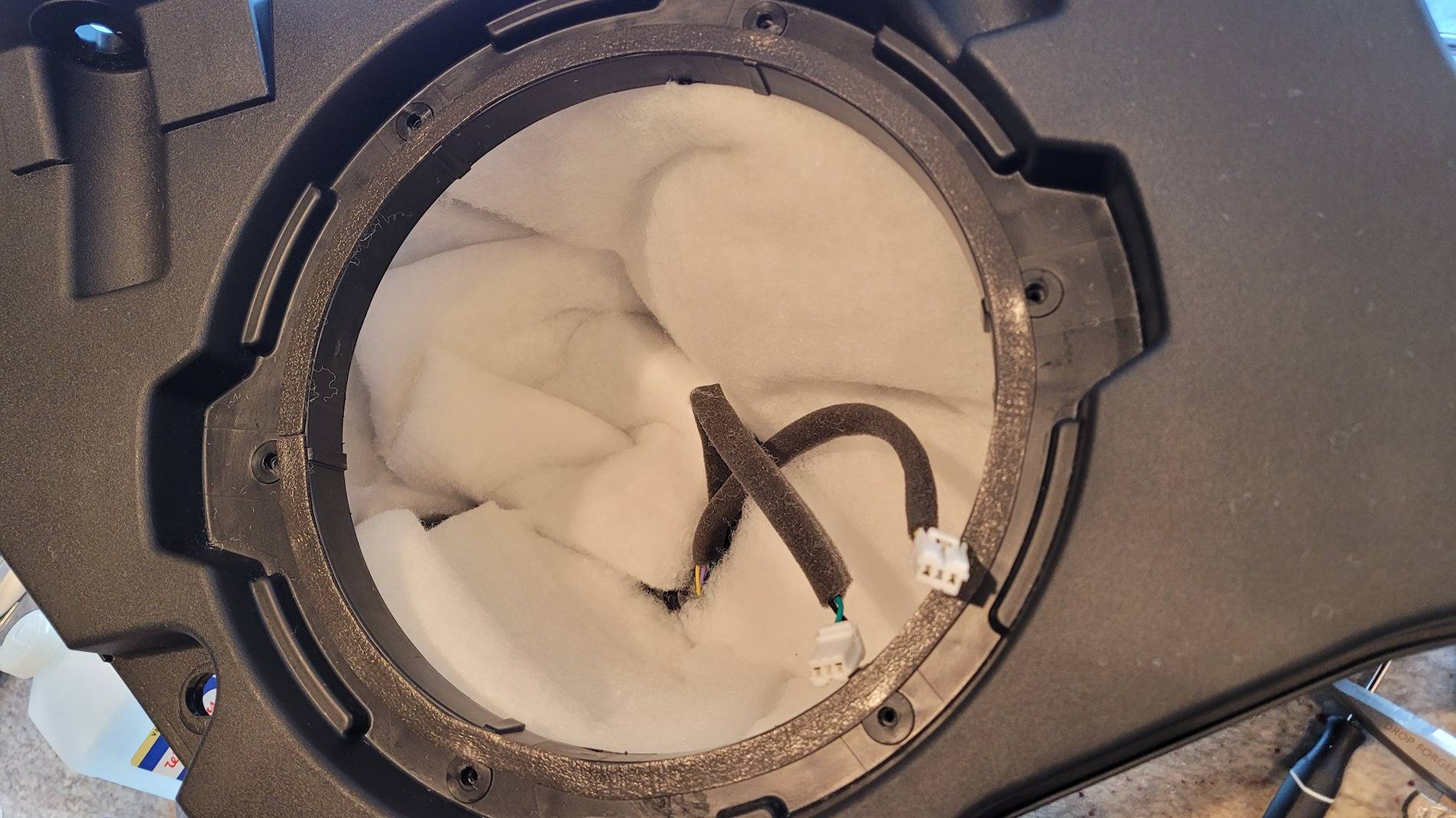

4. You don't need a ton of Polyphil. The inside off the box doesn't have a ton of space. I packed it at first and ended up taking some out. Looks like there is more in the picture than there is. I kind of just lined the inside with it. Also, there is no vent in the box, so obviously Ford wasn't concerned about heat.

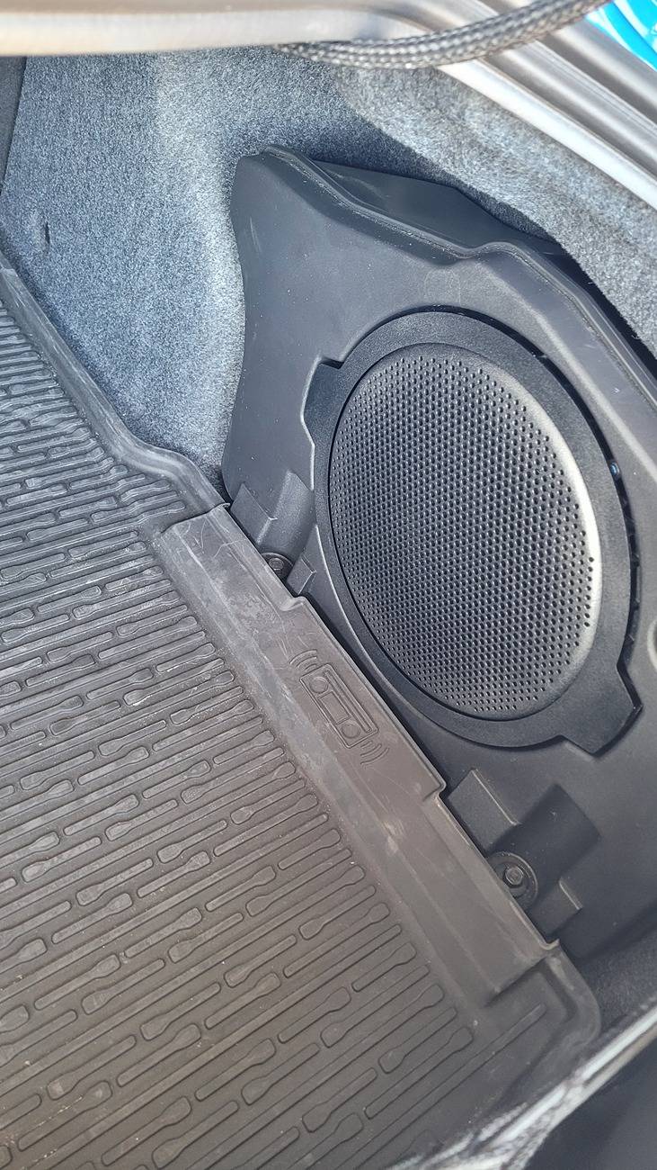

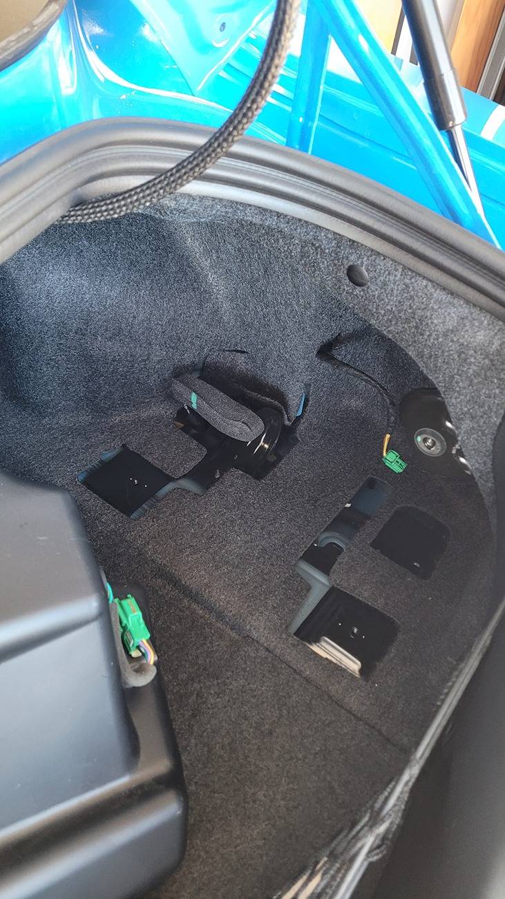

Three bolts and a wire clip is all there is holding the sub box in. Super easy.
To my ear, the base has much more depth and clarity now. It's not "boomy" like it was before. I can actually turn the up the Bass all the way now without any distortion or aggressive thumping. I'm no audiophile, but I think this is a worthy mod. 😎
