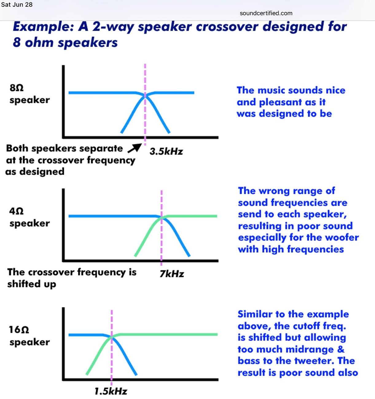

I would hesitate to put anything lower than a 4 ohm speaker or the center speaker would be much louder than the rest.

What makes the stock stereo somewhat unique is that it is calibrated as a surround sound system. The center dash speaker is specifically designed to be a center voice speaker in surround mode and is 8 ohm 12.5 watts. Putting a 4 ohm speaker in it’s place does seem to work as attested by those of you who have done it…and to be fair, it might just result in vocals being stronger in a song.
But on paper, it creates an imbalanced sound and even possible strain on the amp as it now directs more power to that speaker than the others. if interested, read the article I posted the link to in the previous post. Or even just Google the question and learn about ohms, speakers and resistance. I learned a lot more just this aft. But I always knew matching ohms can be very important. I’m far from a music engineering expert, so I just cautiously try to stay in my lane based on research….lol.

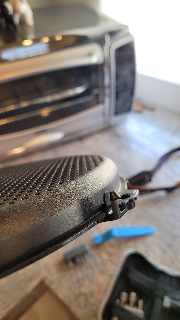

I replaced the sub today. Not a hard job, but a little more work than I thought.
Couple of tips for you guys -

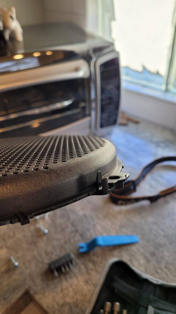

1. It's really easy to break the clips on the outer ring. I didn't totally understand how these worked, but once I got it off I realized you can a get a small screw driveer and push in each tab from the outside of the ring. Just get a headlamp and you can just barley see them.
S650 Mustang B&O 10" sub replacement? 20250628_140257
S650 Mustang B&O 10" sub replacement? 20250628_140307
Broken ^

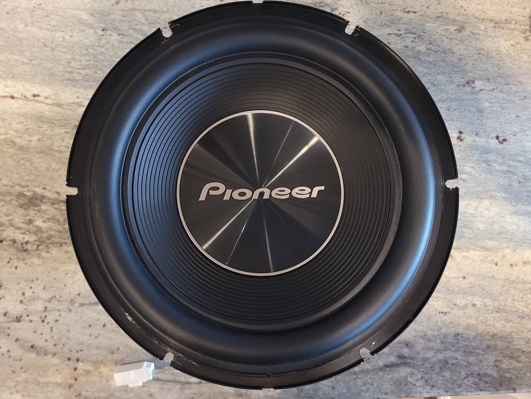

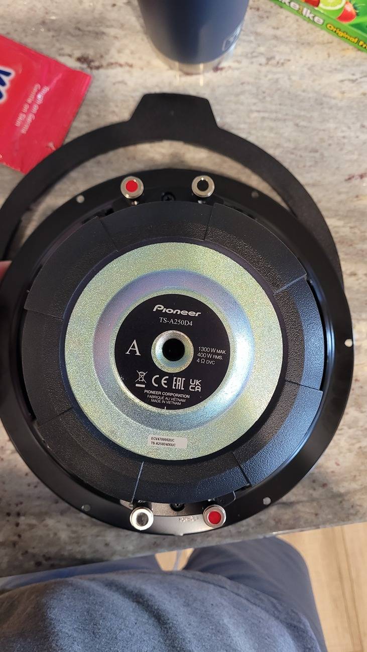

2. Cutting the holes out of the new speaker metal to use the factory holes was way more involved than I thought. This was by far the most time consuming part. I used a dremmel and cutting wheel. You'll need to cut it like this in order to use the factory holes and screws.

3. The extension wires are really easy. No need to worry about all the different colors. Just put the red wire of each extension through the red/positive clip on each side of the speaker. The other is goes to negative. You can't flip the extensions when attaching to the factory clips. They only go one one way.

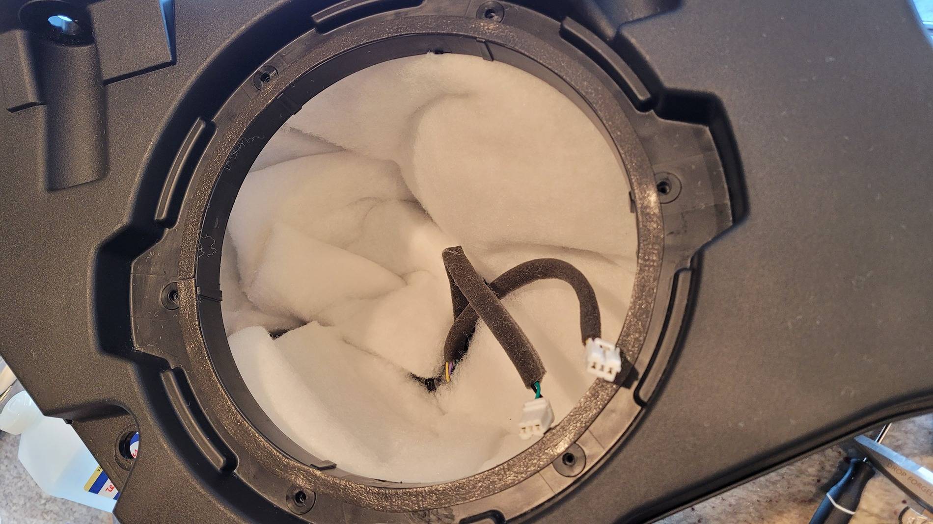

4. You don't need a ton of Polyphil. The inside off the box doesn't have a ton of space. I packed it at first and ended up taking some out. Looks like there is more in the picture than there is. I kind of just lined the inside with it. Also, there is no vent in the box, so obviously Ford wasn't concerned about heat.
S650 Mustang B&O 10" sub replacement? 20250628_152914

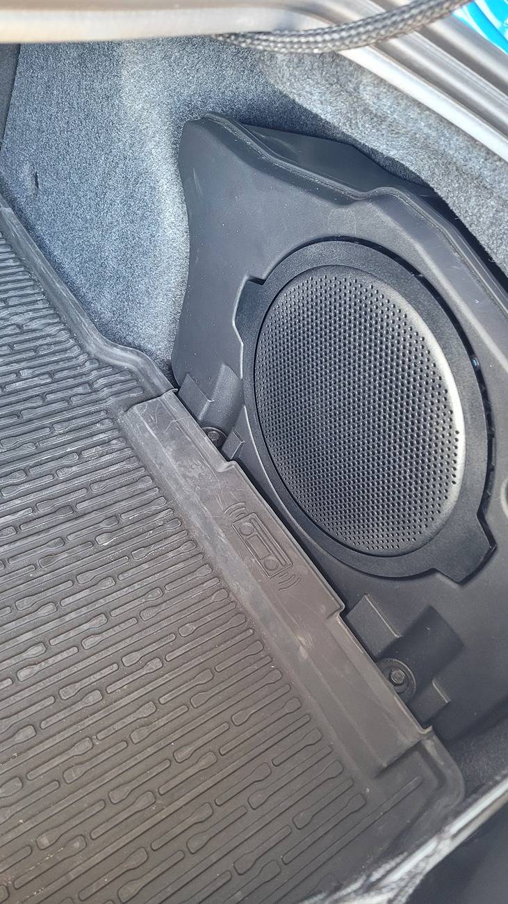

Three bolts and a wire clip is all there is holding the sub box in. Super easy.

The factory holes are pretty close to the Pioneer ones. Drilling new ones so close might be problematic.

You bring up a valid point. That’s why I thought to either rotate the speaker slightly, or fill the stock holes. Easy to fill the holes with some epoxy or even with some plastic sprue from one of my model kits. All I need is resistance against the screws in the new holes.
That said, you did a really nice clean job dremelling out the slots on the speaker!
Broken ^

Nice write up!
I did pretty much the exact same things you did here, even cutting out the holes in the new sub with a dremel and cut-off wheel.
One thing to note, and this doesn't matter if you are planning to use a custom speaker grill, but the factory one will not fit if you try to turn the speaker and/or drill different holes for the sub. The ring that the speaker cover snaps onto mounts using the same holes and turning it will cause the cover to be misaligned with the box.
