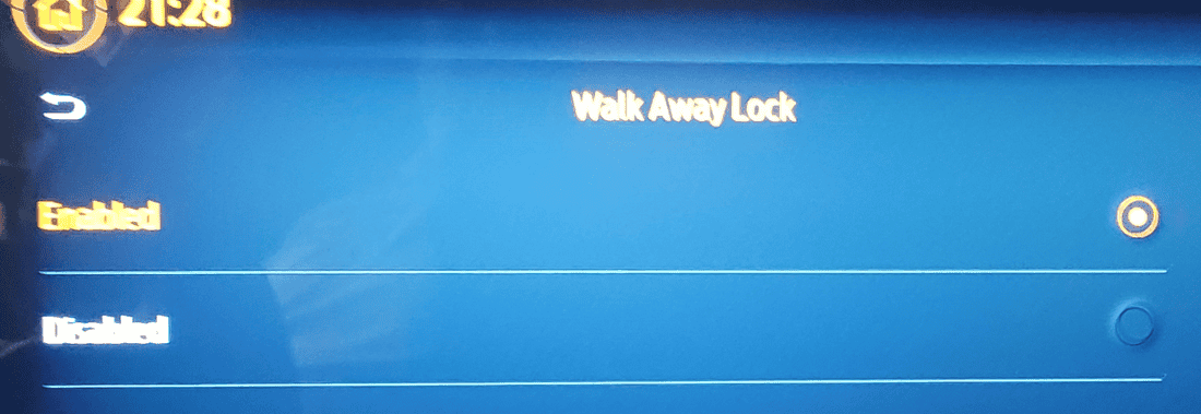

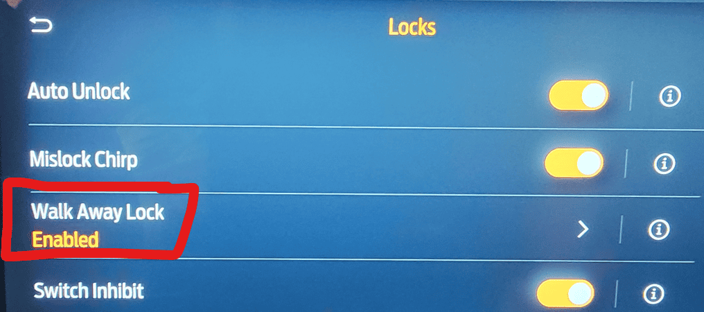

I updated my car with my Mongoose-Plus and FDRS not long ago, including a BCM update.
Tonight, I worked with @rugedraw to test some changes for Walk Away Lock (WAL).
I can confirm that it does work. Leave the vehicle with your keys, close the door, walk ~13 feet away and the doors lock.

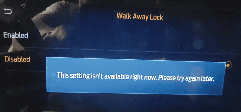

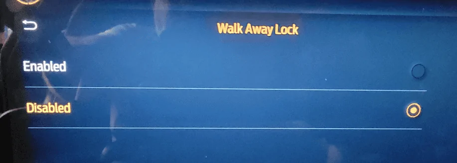

However, there are still a few bugs to work out/figure out.
For example: If you disable WAL on the touchscreen after adding/enabling it with FORScan, you can NOT re-enable it on the touchscreen - it throws an error:
S650 Mustang Start/Stop failure 1720491855306-dn
S650 Mustang Start/Stop failure 1720491651923-u
I did not try to debug it after this (e.g, APIM reset or open things back up in FORScan to see which, if any, values changed after I disabled it via the touchscreen, and to see if I can re-enable it either with an APIM reset or FORScan edit). I will be checking into that tomorrow and reporting my findings back to @rugedraw
EDIT: APIM reset did not fix it. Had to revert my changes, then reapply the new ones to get WAL to work again. Going to try to mess it up again in the AM, then confirm if toggling WAL off via the touchscreen doesn't change any of the three values I initially changed to get it to work to begin with.
