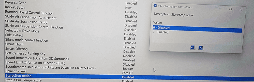

When I was in FORScan last night making some changes to my DH, I noticed the setting Start/Stop option with the choices of Disabled or Enabled.
Now my DH doesn't have the physical AS/S button, but I wonder what would happen if you set this to Disabled in a Mustang that has the physical button.
There ya go… yes DISABLE
Does walk away lock work?
Again, I don't have the AS/S button, so that's why mine was already disabled.
I have no idea if that just toggles the ability to use the button IF present and, if not, does it just default to ON all the time if this setting is disabled?
Someone with the physical AS/S button and FORScan should give it a try so you all can find out.
