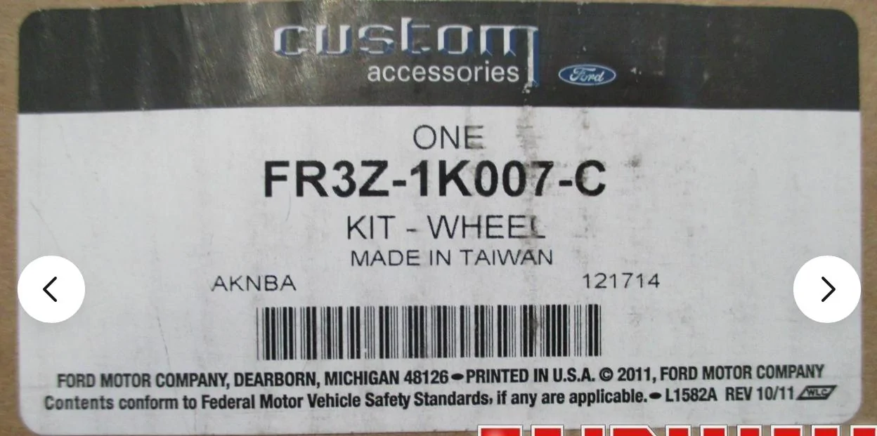

so my wife just flipped finding out that out new eco boost yellow splash premium convertible NP and upgraded package! only comes with an inflator kit!! honestly doesnt bother me but were gonna road trip it through the smoky mountains when it arrives its built and waiting for shipment! i didnt get the Brembo brakes so whats my option for a donut spare jack and lug wrench?? im assuming theres a well under the carpert for it but not sure dont want to lose trunk space! thnks guys was thinking american muscle or cj pony parts

You could have ordered this when you bought the car but now available from the dealer and many other places.
https://www.ebay.com/itm/174181676086?epid=18017017585&hash=item288e097436:g:thAAAOSw-eleOduG&amdata=enc:AQAIAAAA0L2QkVTTpMQa2Le7l9y2rgcB+8yhsuzRSdU2WZ7wqV2GEsE5OzGZczJ2FBAJvoL4qyA7Qg5fMYuHr/yv4Q74fDppkc3VM7eA1AOb1n6dKaQANt7tr6azSwboXf+QOguVSrZ94Kii9lfjwoq+G9m0X9L2GAEI4K2rGFVdEhaF2kvtSzyLADqnlMFrh1CZT7zoavJt8SVgoEa+Zqh54hakeqRPxMNNR2N6SlHtyERNK3XR5Ti4U+N1hHSao7jDootFt74KtulrflzwBdqsGH5RoLg=|tkp:Bk9SR6C-54TVYg
S650 Mustang Spare tire option for Performance Pack or standalone Brembo BBK kit -- tested IMG_3680

The spare mounting points are in the trunk. You can remove the inflater kit and put the accessory kit spare in. You could use the Ford Pass points you get from buying a new Ford to get the accessory spare tire kit from your dealer.
Ford spare tire kit.
