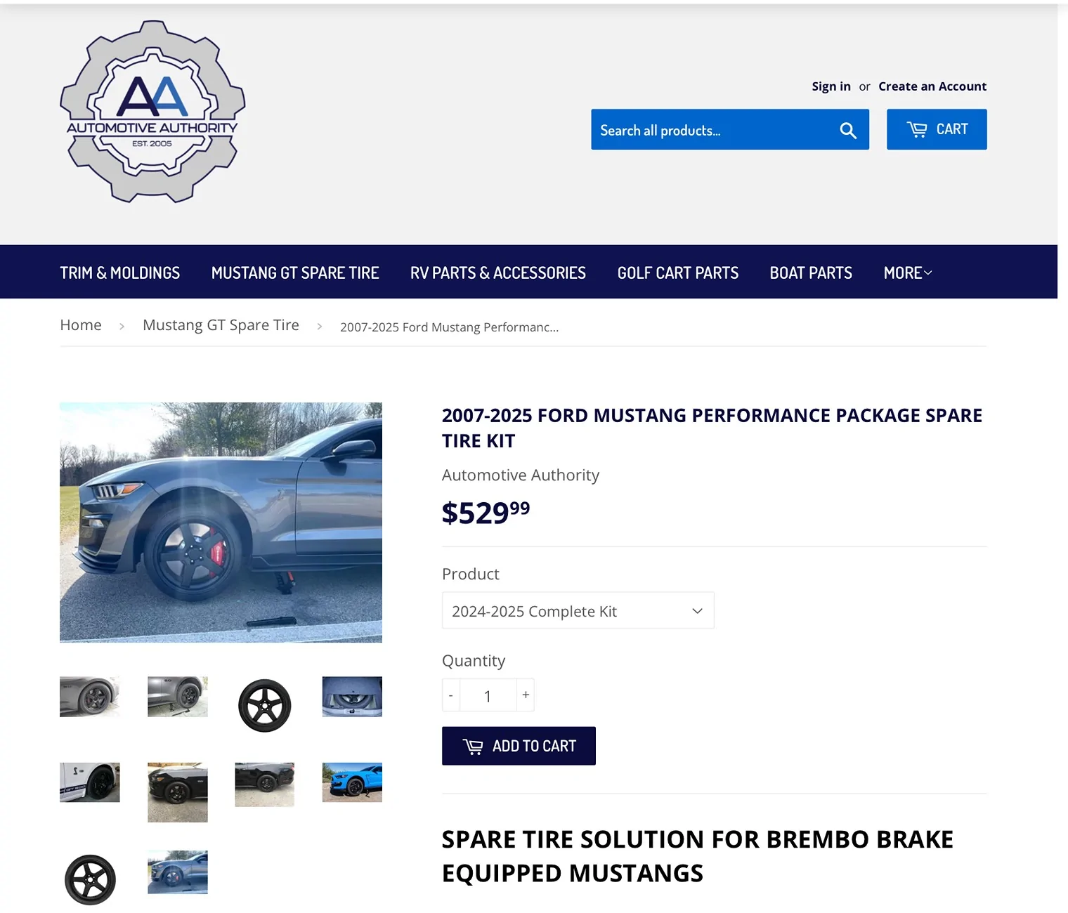

24RapidRed
Jul 18, 2024
Sterling Heights, Michigan
2024 GT Premium, 2026 Ram 1500, 2026 Jeep Grand Cherokee
I believe there is an overall tire diameter difference between the two, if that makes a difference to you.
I went with the spare from AA which matched the rolling diameter of the 275/40/19 rear tire on the PP package. The Modern was 1.16" smaller. It made a difference to me with the Torsen limited slip rear end.
