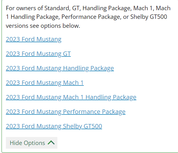

I found this website for the spare tire, not sure if i would buy it from them but they have the specs that show the offset and dimensions of the tires when different sizes are selected. You can the determine what will fit in the trunk. Pick 2023 gt with performance package and it will show the same tire size. Just need to confirm the offset
https://sparetire.com/Ford/Mustang/2023-GT-Performance-Package/
RLE55
Jan 7, 2024
1,022
1,055
38.9967° N, -84.6310° W
Their options show 2023 models, not 2024 and post #41 shows the 2024 is different.

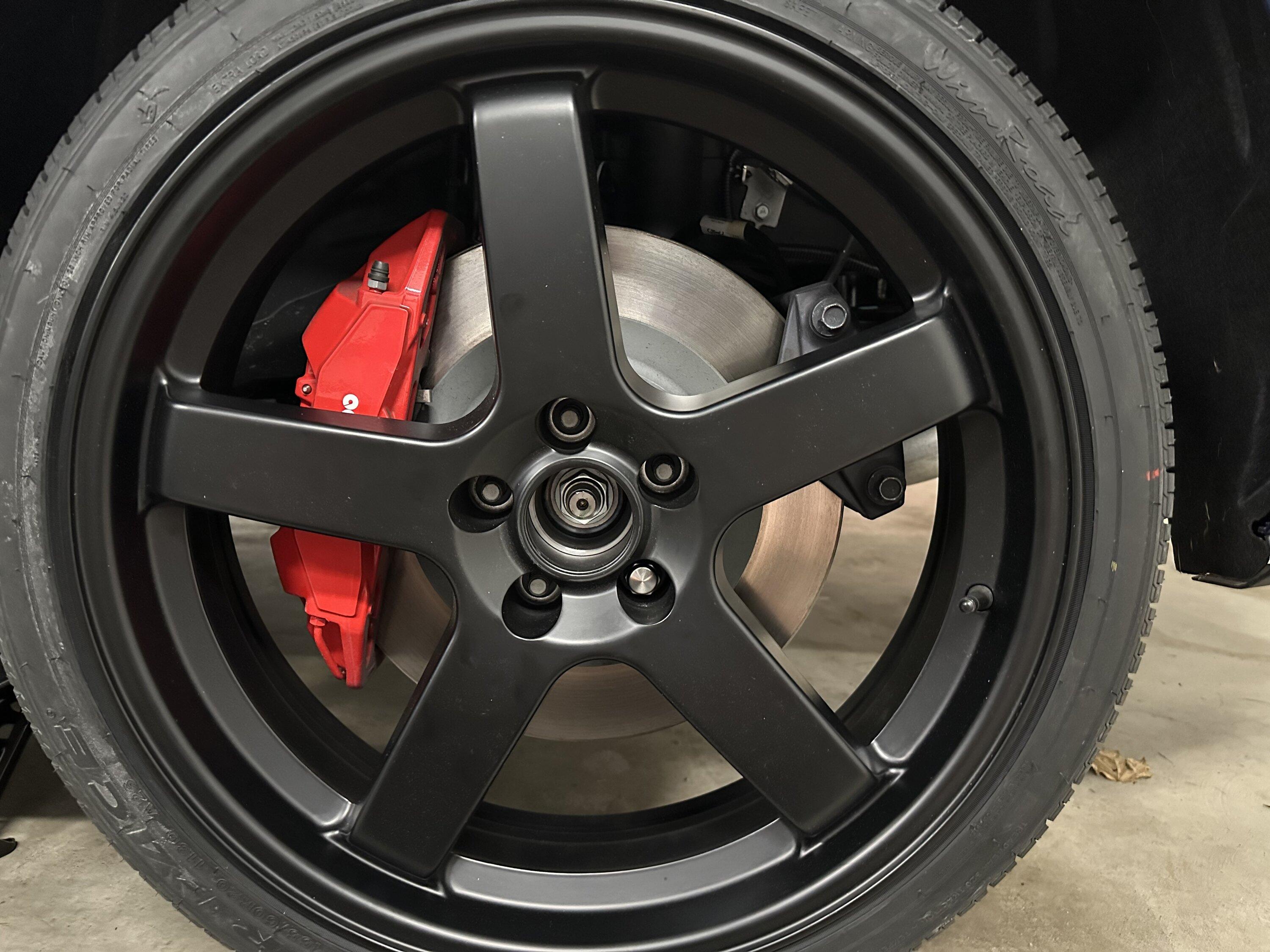

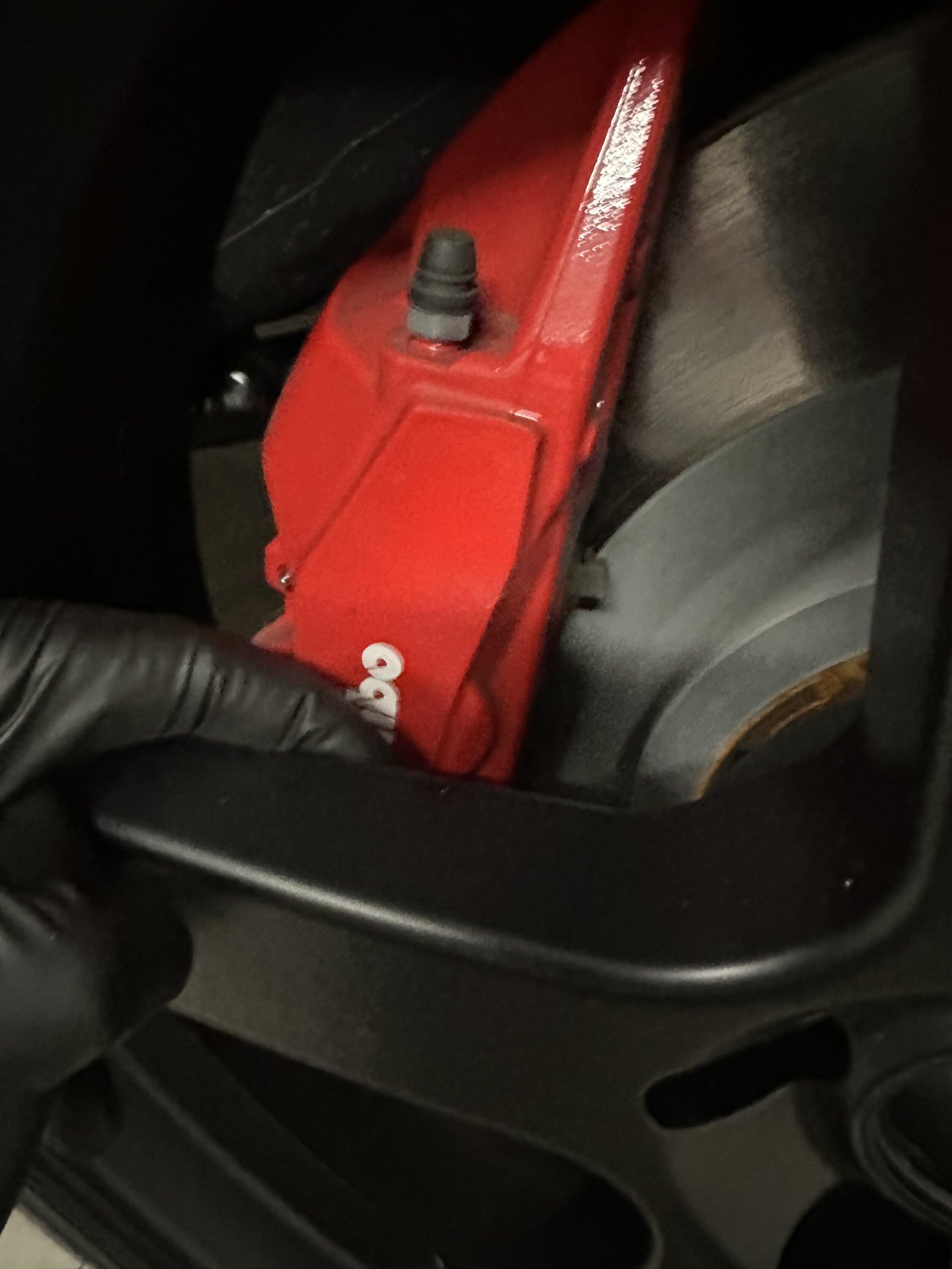

If you’re looking for a spare tire option for the performance pack or standalone Brembo kit, I worked with Travis at Automotive Authority to test fit their kit.
Everything fits great on the front and rear.
There’s about a hands thickness of clearance around the calipers
The whole thing fits into the spare well and allows the trunk floor to sit flat.
The only issue I ran into was with the Ford factory jack and lug wrench. If you install the jack and wrench the way Ford does it, the stack is too tall and didn’t allow the spare to fit all the way in. There's plenty of room inside the wheel so I wrapped the jack and wrench in some shop towels to stop them from rattling around and fit them inside the wheel. You can see them in the picture above in the grey towels along with the tow hook.
If you’re looking for a spare check them out.
