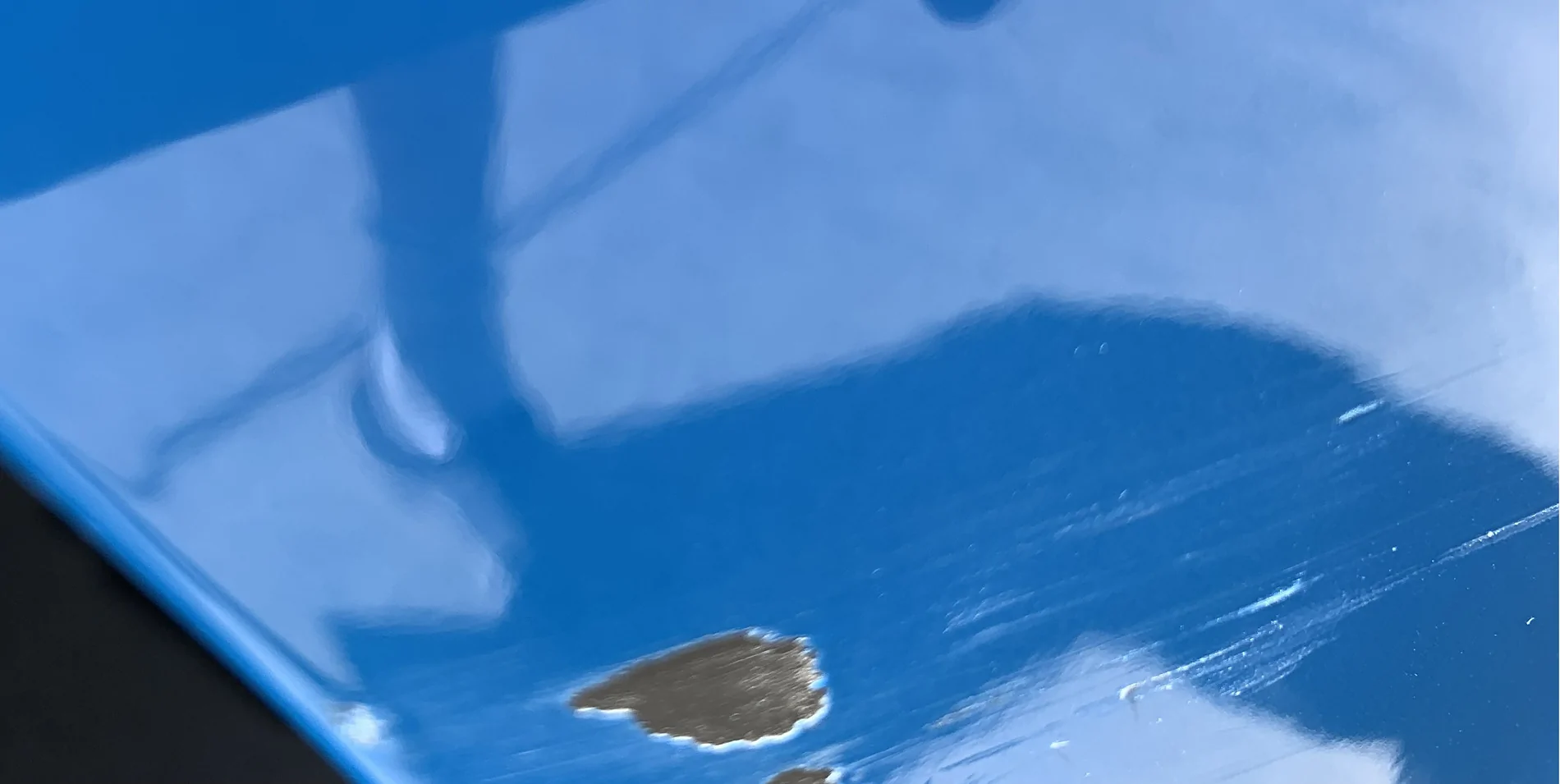

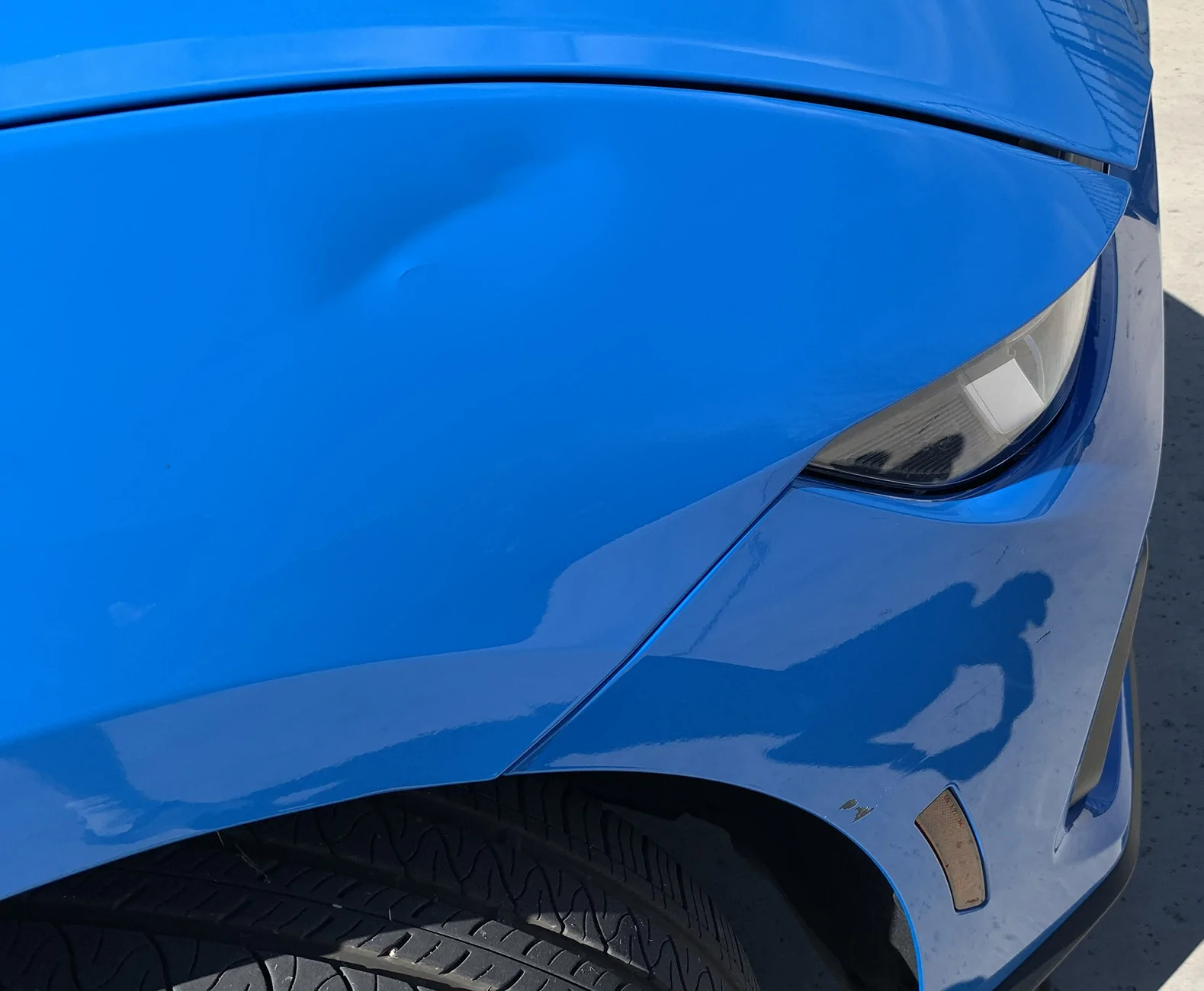

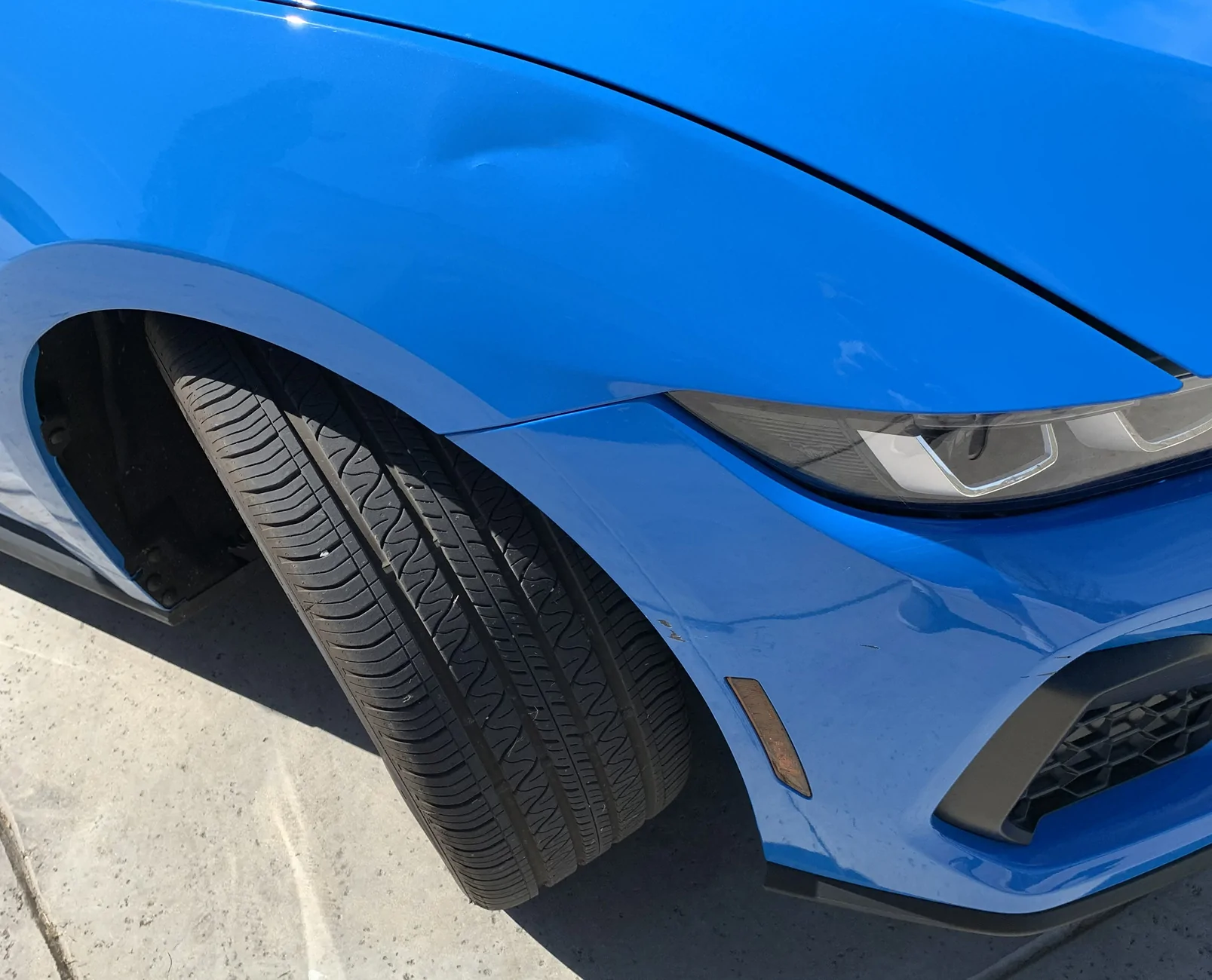

A couple days ago while arriving back home I accidentally hit my accelerator instead of the brake and hit the back of my garage. Luckily the garage was fine and all the damage caused to the car was cosmetic. I took it to fords collision repair shop and wanted to make sure the quote I received from them seems fair. I’ve attached photos of the damage below and the estimate to fix it. Also I didn’t get a pre collision alert, and never have while driving, is the system unreliable or do you think there’s something wrong with mine? Thank you.

Honestly from what i see its only front bumper, if i had to pay from my pocket i would get one from ebay and swap it on my own. But if you are going through insurance and only are only paying for deductible then it doesn’t rly matter. But also u can always go to some other body repair shop and ask for evaluation.

Labor wise, it looks real similar to what the Ford collision center here quoted me to paint a fiberglass hood and blend the fenders. $4300 total.
I told them they were crazy and took the car elsewhere.
The body shop that is actually doing the work quoted me $1700 and have called me everyday with updates and facetime calls making sure they're doing what I want and that I'm happy with the work they've done. I've dealt with the ford body shop here before and they would NOT have done that.
Don't be afraid to shop around!!

They want to buff the hood then blend doing a full clear.
The hood does not need any body work according to them
I would rather them try to tint the paint and spray out test panels to get the fender right especially since they are not painting the whole fender, they are going to "blend in panel, full clear" before I added paint thickness to the hood and the chance of a detectable blend
The car is new, there is not a fade issue yet.
What I don't see, and this concerns me is there is no "pre scan" and there is no reset/recalibration of the distance sensors.
If you read Ford's position statements and repair procedures I would know that a pre scan is called for in their procedures and there is no way in hell that after disturbing the distance sensor in the overhaul process that Ford is not calling for a recalibration.
It is a 3 stage paint, and that stuff is not easy to spray, it is even harder to blend over existing paint as it will get darker with every added layer.
I really really hope their painter is a top notch guy because that is going to suck to refinish
I'm kind of hoping that if the damage to the fender is what I think it is, kind of rolled down and out a little, that the tech can just grab it and tug it back up into position and while holding tension on it tap it with a rubber mallet to get it to stay in shape. Almost like a paintless dent repair.
As I get deeper into my response I am now really wondering why they are not looking for tint/spray down just to make sure the bumper cover matches the unrepaired fender and the area of the hood that is not getting color, just clear.
Doesn't the hood liner have to be r&I'd to get the scoop out?
I don't see that on there.
I will admit I am a but rusty since I have retired and don't have the software to double check things, but I'm just tossing my thoughts out there as a devils advocate.
I'm not saying the shop is wrong, I'm just saying it is not how I would have written it FROM A SHOPS SIDE.
From an Insurance side, first appraisal, not seen at a shop it is typical for a not give away the store appraisal. That appraisal would certainly be laughed at if it was written by an insurance company's appraiser because we all know they missed a ton of things
