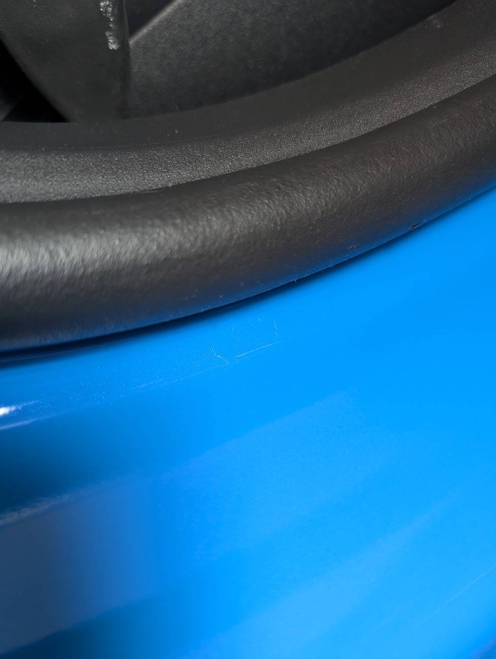

So I finally pick up a some touch up paint from my Ford dealer and wouldn't you know it two days later this appears: You might be able to tell from the picture but it's down to the bare metal:(
S650 Mustang Stone chip repair advice IMG_3284
So my question is how do I best repair this? I have the Ford Atlas blue metallic touch up paint and it has a separate clear coat application on one end as well. Any advice on prep work and the actual touch up of this stone chip would be great. I know it's not going to look great but I want to get it sealed up so it doesn't rust.

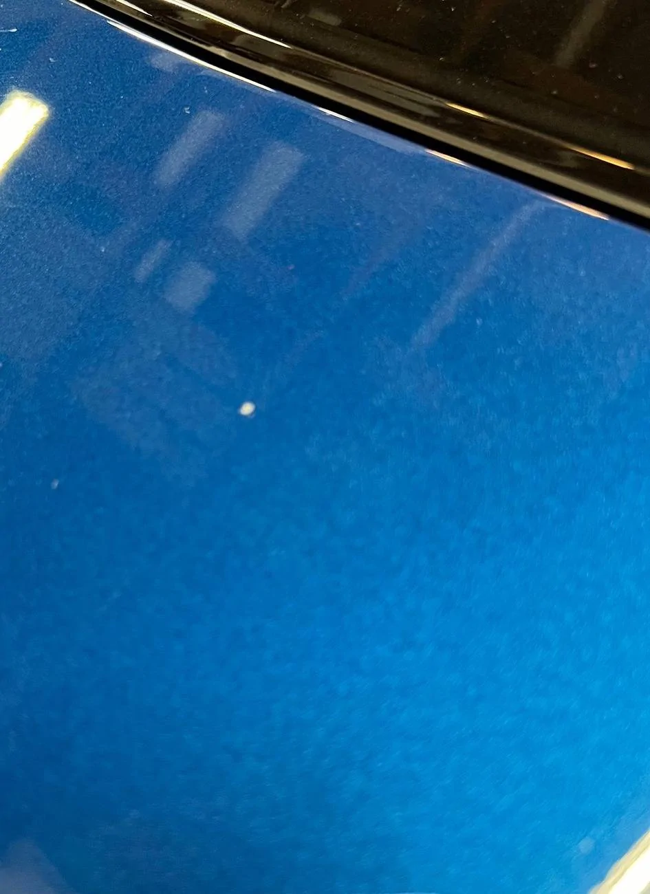

My wife slammed the door on the seatbelt accidentally, took it down to the bare metal, a few hours of letting paint dry, it's barely noticeable:
Wow great post. Thanks to you and Magic88 for the pointers. Now at least I have some knowledge so I won't screw this up too bad:)
