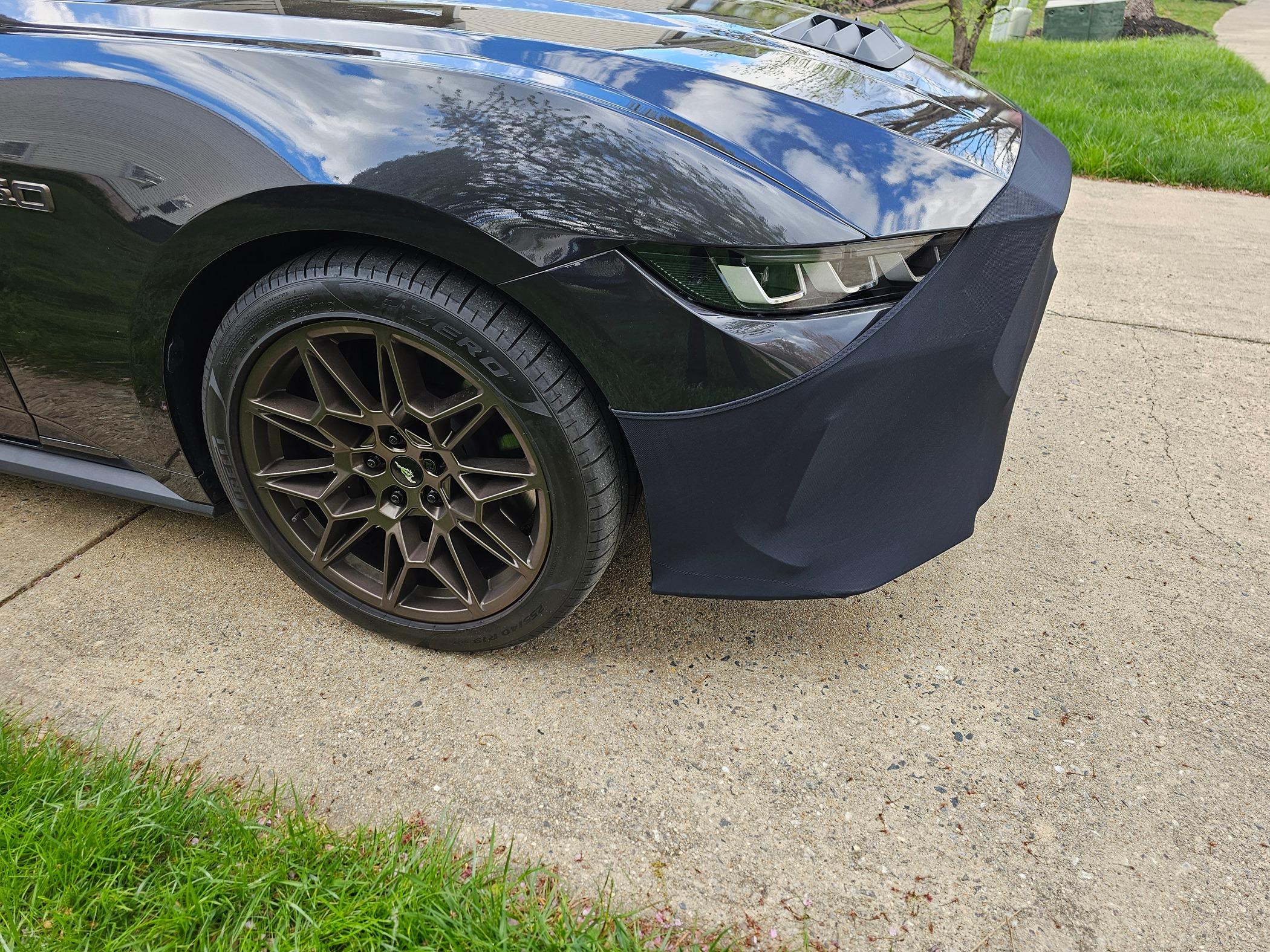

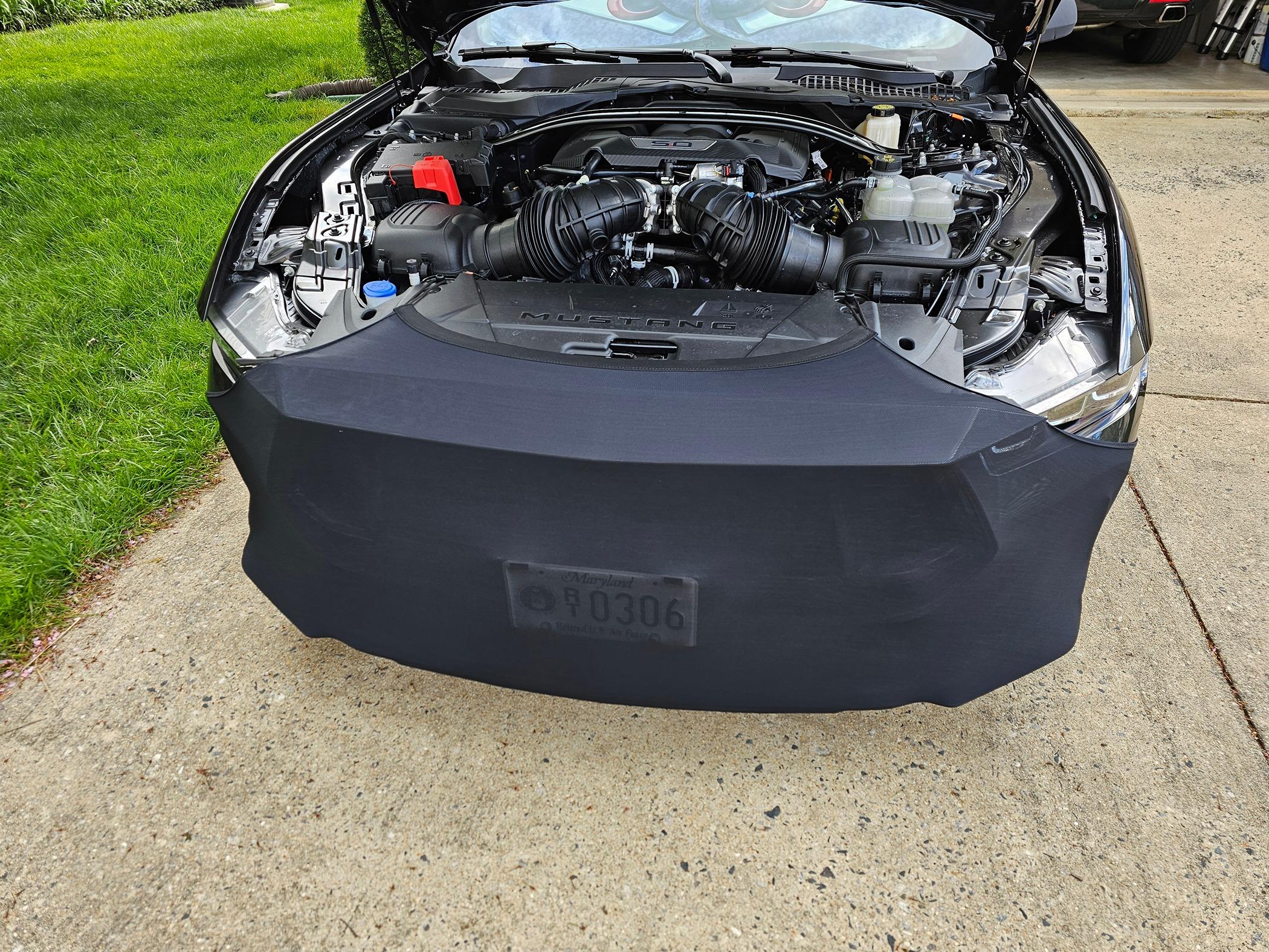

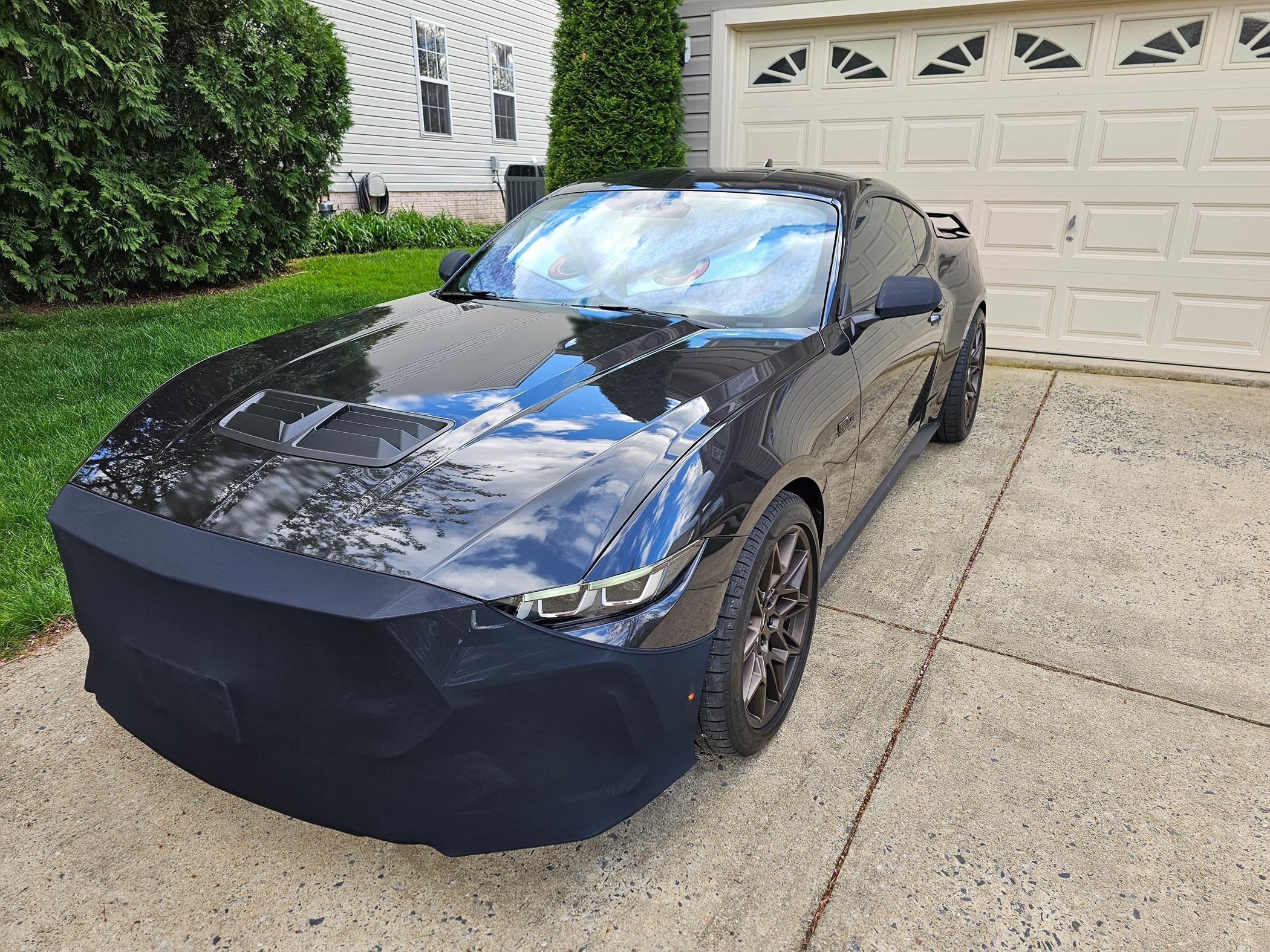

I use this NoviStretch cover for highway driving, it's mesh.
S650 Mustang Options for protecting against stone chips on S650's 20240412_175116
S650 Mustang Options for protecting against stone chips on S650's 20240412_175412
S650 Mustang Options for protecting against stone chips on S650's 20240412_175354

I'm all for protecting the cars paint etc., but that thing is hideous.
It can be put on and taken off in under 2mins plus at 80mph on the highway I'm not in a fashion show. Hideous would be rocks chips and bug splatter on that area when I get to my destination.

Any issues with scratches from this product?
None so far. I mainly wanted to try it out to keep the summer time bug goo off the front end when out on the hwy at night. I don't have it on for daily driving, also the cover is washable if needed. If I had PPF I'd still want this.
