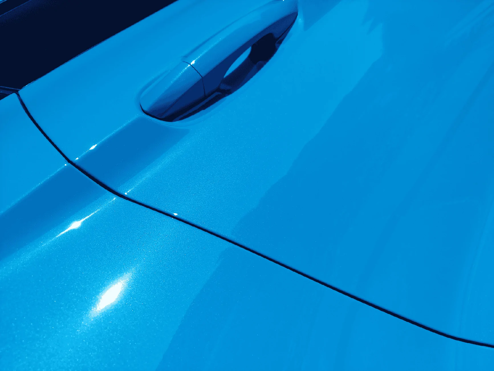

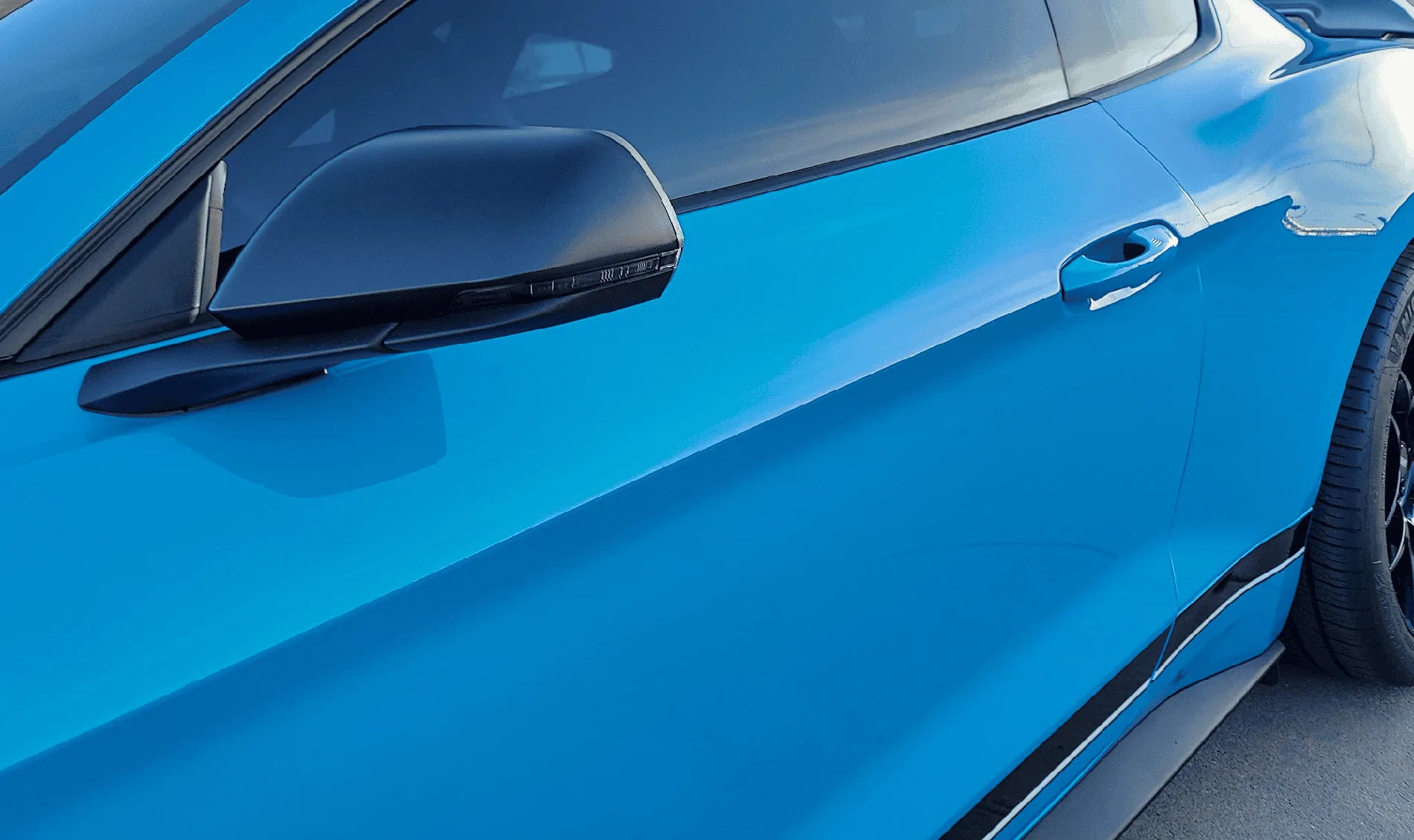

Does anyone have experience with XPEL? Is their clear wrap really clear (not yellowish)? How good is the self-healing?
I see XPEL as the current benchmark. I have been using XPEL since 2022. Skye is the first car I've owned which has had it. From my experiences, each of my vehicles will use it in the future.
The product comes with a 10-year warranty against defects, to include cracking and yellowing. Many of the concerns expressed of these specific issues, I see them as by-products of previous generations. The material will eventually wear out. Could be 10 years and a day. Could be 13. If garaged, it will probably be longer.
The wrap is completely clear. The finish appears natural, not fake or glassy.
Immediately after install, I was advised to avoid washing the car for the first several days, with the product healing and curing over the first week to ten days. It's best to put the newly-installed product in direct sunlight, as the UV rays will help cure and dry-out the product, while assisting in any self-healing.
Two weeks after install, I returned to the detailer to have them review their work. After initial installation, several small air bubbles were present. As things dried and cured, all but a few settled and went away. For the handful that remained, the detailer worked them out in short order. Since then, I've had not one issue.
Heat and UV light can assist with the self-healing. PPF has three layers. The first layer attaches to the car, the second discourages scratches and is somewhat malleable, while the top coat is something akin to just that, a clear coat.
Heat and UV is something of a two-edged sword. While assisting in self-correcting and healing, it's best not to manhandle the surface when hot, even after curing. It's not like you'll wreck it or have to treat it with kid gloves. It's simply best to avoid pressure and swiping when hot.
For care and feeding, I use three products.
For routine maintenance wash, I use Gyeon Bath. This is a maintenance soap that can be used any time, all the time, any paint or finish.
https://gyeonusa.com/products/q2m-bathe
PPF is somewhat porous, like your skin. But using a paint decon soap would not be advised; it'd be too harsh. Gyeon makes a PPF decon soap, to cleanse those pores. The soap should be used a few times a year. It's a mild decon soap.
https://gyeonusa.com/products/q2m-ppf-wash
Paint sealers are well-used and appreciated, but again, PPF is a bit different. I use Gyeon's PPF Maintain, which is a sealer for PPF. I use this product a few times a year. XPEL also sells their own sealer, which gets good reviews.
https://gyeonusa.com/products/q2m-ppf-maintain
https://prestigefilms.com/product/xpel-ppf-sealant/
I noticed XPEL's sealer recommends using it monthly. YMMV, but I'm not sure it needs to be used that often. I use Gyeon's sealer like two or three times a year.
Regarding washing and maintaining the finish, discuss all this with the installer.
One thing I haven't done is take my car though any type of car wash. Automatic, brush-type car wash on a hot day? Er, no Thank You. I was advised, long-term, avoid physical car washes. A good point was made regarding "touchless" car washes; these sites often use alkaline-based products. If you look at the pH scale, more alkaline is more basic (see bleach). While not actually bleach, the solution is breaking down organic material as bleach does. Again, something I don't want the materials, PPF or others, exposed to.
As far as accepting strikes and repair, I've had good results. The majority of the strikes which have happened result in "flash" type marks on the surface. The surface is free of a divot, but the dirt and impact area is obvious. Came home one day with a small rock actually sticking out of the PPF. There's the tiniest of blemishes there. If I lay on my side in the Sun a certain way, tilt my head a few inches from the area, I can see it. I take several strikes a year, none of which have left any meaningful impact crater. Certainly not a hole.
Anyone keeping their car for some time, I feel it's worth considering. Thinking of paint-matching pearls or metallics, finding a good shop to make repairs and the costs of all that, I feel it's worthwhile. Where you live and the drive locations will also have an impact, no pun intended. Someone on the Southern CA coast might not need much of any, while another driver in regular freeway traffic and big city will.
