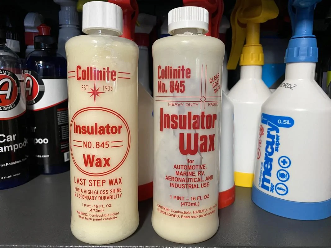

Wax - old fashioned, but it still has a place. More work to apply, but sometimes its worth the hassle. I default to Collinite 845 for wax, its not from a posh brand, and its been around for decades. But as waxes go, its one of the most durable, while delivering slickness and magical gloss. Downside, well you can't really use it on unpainted trim as it will stain. Expect 3 to 12 months depending on vehicle use, storage and maintenance. I can get over 12 months on my garage queens.
After trying a variety of new spray sealants and ceramic coatings, I'm seriously contemplating the use of good-old 845 once my S650 arrives.

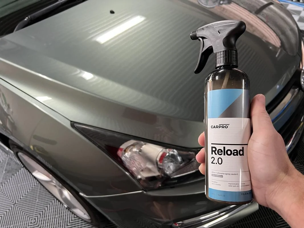

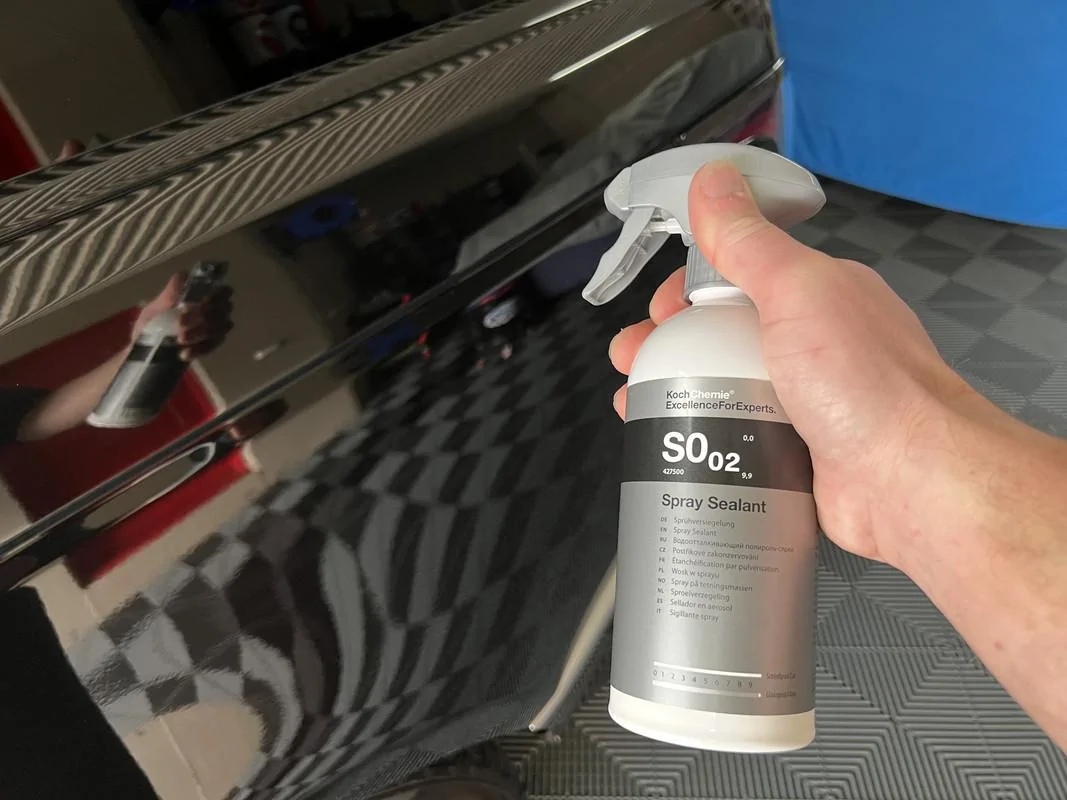

Spray Sealant - these products have basically replaced wax for most people these days. They are far simpler and easier to apply, basically a spray and wipe sort of deal. Depending on the product, they are not as durable as a ceramic coating, or even a high-quality wax, but the speed of application means you can reapply in no time.
Two I use often are Koch Chemie S0.02 and Carpro Reload 2.0. Of the two, KC S0.02 is more expensive, but much easier to apply and a little goes a long way. Reload is not hard to apply, just not as fool proof as S0.02. Both should give you 2 to 3 months on a daily driver, 12 months on a garage queen. The best thing? They can be used on all surfaces including paint, glass, rubber and plastic trim.

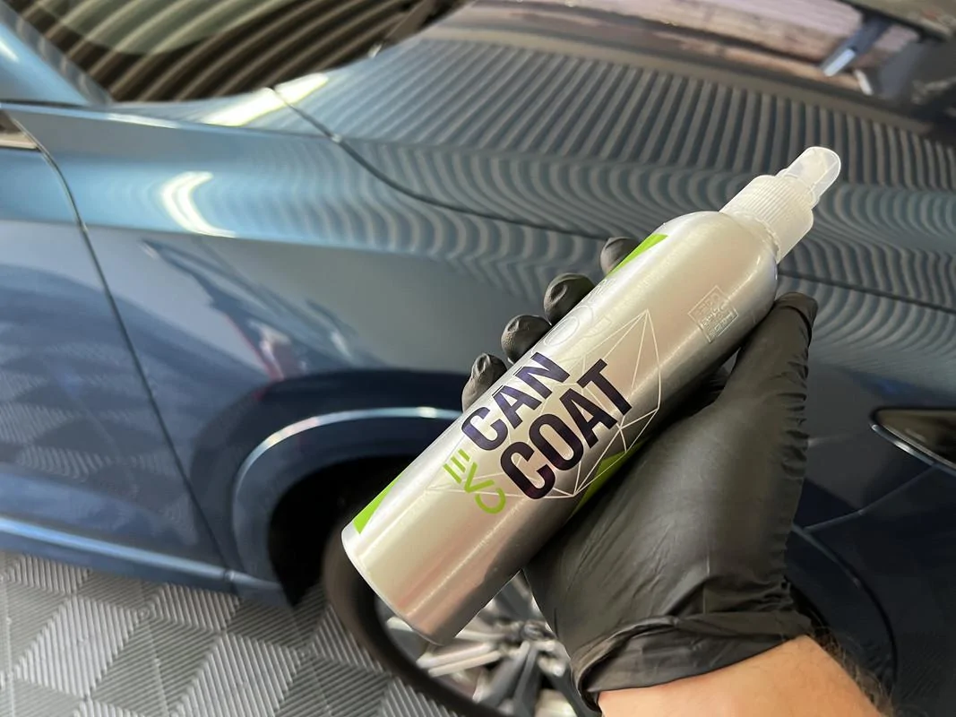

Light Ceramic Coating - these products are a gateway to full ceramic coatings. There are few on the market, most only delivering 6 months durability, at which point I wouldn't bother. However, Gyeon Can Coat EVO will do 12 months and beyond, while also being more in line with a spray sealant than a ceramic coating in terms of how its applied.
I will caution though, this is still a ceramic coating, so you need to work smart and be sure to wipe each section and its overlapping areas thoroughly to avoid high-spots. You also DO NOT spray this product onto the paint, rather into a towel or applicator, then wipe across the paint before immediately buffing with a towel. I could link you to appropriate videos on this if you chose to go with Can Coat.

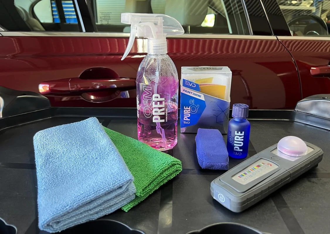

Ceramic Coating - these are products are typically multi-year coatings, offering the most chemical and environmental resistance, along with superior ease of cleaning. And while there are various specific coatings to use on glass, paint, trim and wheels, a singular paint coating will cover most bases. However, they do require more methodical application, so be sure to read up and watch some videos before diving in the deep end. Again, be mindful of the chance of high-spots and work smaller sections until you gain confidence.
In this case, I would suggest Gyeon Pure EVO. This is a very forgiving coating to apply, while the bond with the paint is instant, you have a 15 min window in which to level it back, allowing the user more time to get comfortable. Expect 3 years of durability and a candy-like level of gloss. It's only failing is the lack of ultimate slickness, something I get around by using a spray sealant topper like the above Carpro Reload 2.0 or Gyeon's own Cure after application, something that also protects the coating as it fully cures in the first 14 days.

Pure EVO doesn't need a curing agent, but they can be helpful for a couple of reasons -
1. During the first 12 hours after application, you really need to keep the car dry, ideally parked in a garage or under cover and not driven. This allows the coating to cure properly. Using a product like Cure or Reload is your backup just in case the car gets wet during that stage.
2. Reload or Cure will also provide protection over the following 14 days as the coating fully hardens.
3. From here, the "curing agent" will add slickness to the equation. This not universal to all coatings, but most of them seem to lack that slick feeling a wax brings to the table. In most cases, this is the tradeoff for durability. In the case of Pure EVO, it's just the way it is, so no amount of additional cure time will alter that.
Having said that, if you want slickness without using a topper or curing agent, then have a look at Gyeon Mohs EVO. Unlike Pure EVO, Mohs EVO has that slickness on its own without the use of a topper. Personally, I would still apply Cure or Reload to be on the safe side.

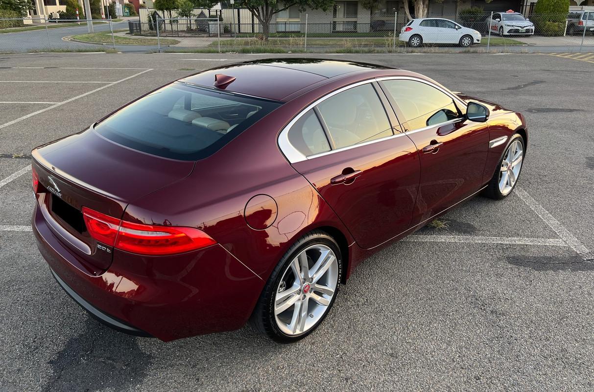

In terms of "key ingredients", I'm not entirely sure where you are going with that, but I have linked you to my application in the thread below. In that case, I decontaminated and polished the car prior to application of Pure EVO. The theme of that thread was around a once-every-few-years sort of detail. So pick it up where you feel suits your situation -
Holiday Project - Polishing and Ceramic Coating the Jag! | 2015+ S550 Mustang Forum (GT, EcoBoost, GT350, GT500, Bullitt, Mach 1) - Mustang6G.com
These videos are from Gyeon itself, I found them really helpful in understanding the two coatings and their specific application traits.
