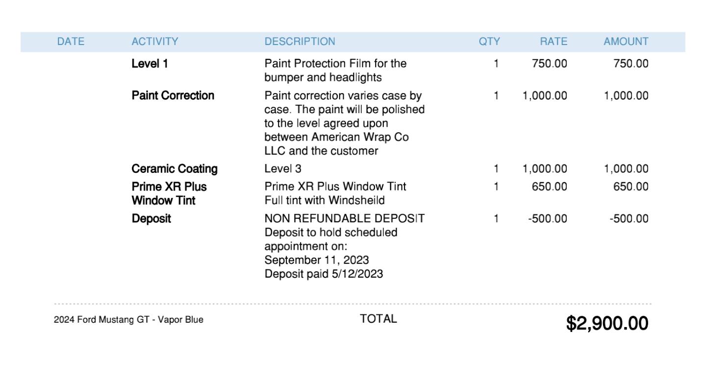

Posted this before but here's my estimate for anyone who's curious about price.
S650 Mustang Thoughts on Paint Protection - Wrap, Ceramic, Teflon,... Screenshot_2023-07-03-12-32-44-38_2dff0e110cbb5dcf452c3609775e0d0f
