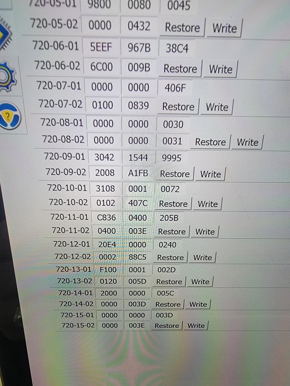

think of it as a hex editor for the computer systems in the car. Multitude of systems magnitude of code. Various options available and digits modified to obtain inferred (reverse programming to determine what does what by the provider - some crowd sourcing is also involved) values resulting in changed behavior. Not a common hand held toggle on off type of system.

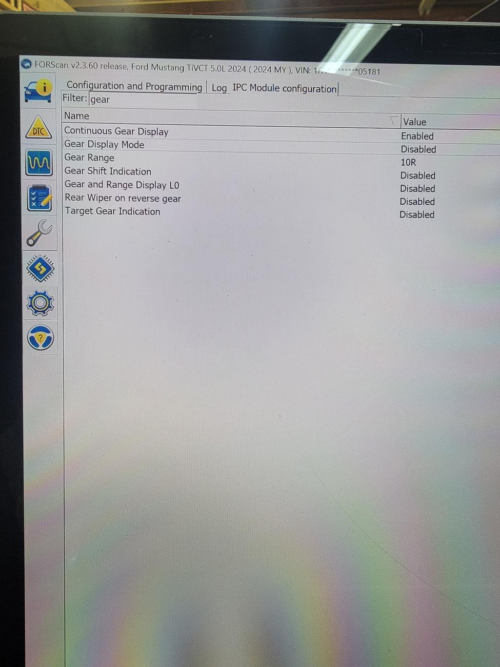

While most require this, there are actually a number of modules and hundreds of settings that can be updated without edited the hex values. Pretty sure I posted a pic or two recently.
CGD was one:
S650 Mustang roadPilot's 2024 Dark Horse (R4964) 20240626_195050
Of course, this is what most look like:
S650 Mustang roadPilot's 2024 Dark Horse (R4964) 20240626_195246
CGD was one:
And as in the example, some options don’t / won’t apply even though they are listed as available to be modified (ie rear wiper in reverse gear).

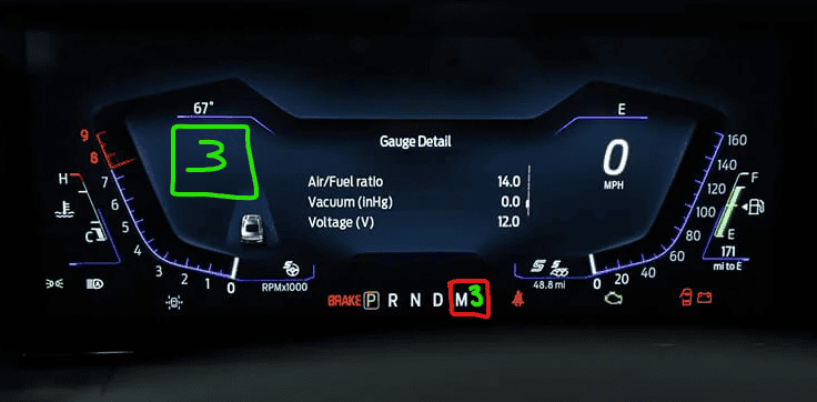

Got any pictures of the continuous gear display? Might be the best $150 I spend. Does ForScan require a purchase too? Or just a PC and the dongle?
3,242
3,587
I can take actual pics later, but to answer your question:
1. For the standard instrument display themes (Normal and Sport for sure, but I don't recall checking Track), the CGD shows the current gear in two places: In the area I marked with green highlighter in my pic and then just to the right of the "M" at the bottom of the screen that I marked in red. Yes, it shows the one next to the "M" even when NOT in manual mode -- you'll notice the number there, but the circle that surrounds the current gear selection (it's around the "P" in the pic below) will be around the "D" when in drive and around "M" only if in manual mode. But the gear number is displayed all the time.
2. When using the Fox 87-93 or the Classic 67-68 instrument display, the CGD only shows to the right of the "M" indicator (red highlight below). I assume they don't show it in the other spot because it would be right in the middle of the tachometer if using either of these two themes.

Again, as long as the dongle is supported by FORScan, you don't HAVE to use the more expensive OBDLink MX+, but I personally like it supporting both WiFi and Bluetooth so I can not only program my vehiclies using a Windows PC, but I can monitor thousands of PIDs with either an Android or iPhone (phone or tablet). The cheaper adapters usually only support one of the other, or they are wired, which means you can't use them with a mobile device to monitor. But, up to you.
FORScan doesn't REQUIRE a purchase, but a small investment saves you time. In order to program with it, you have to have an extended license. You can get one for free, but you have to renew it every two months. Instead, I pay for a 1 year extended license for $12. The way I see it, my $12 per year supports the guys who make this software possible (yes, they are in Russia, but no worries, they've been doing this for many, many years and FORScan is 100% safe).
More info on licensing:
Info on Standard and Extended licenses for Windows, version 2 - FORScan forum
Download FORScan (and links to get free 2 month trial license or buy 1 year extended license)

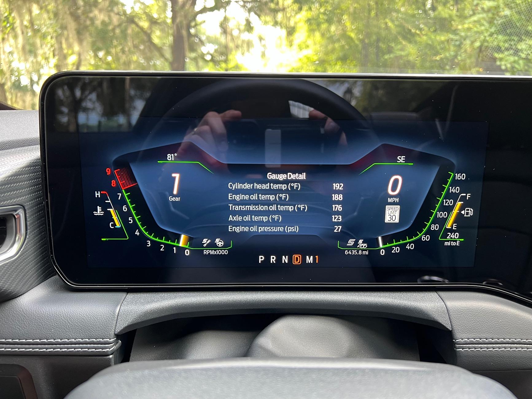

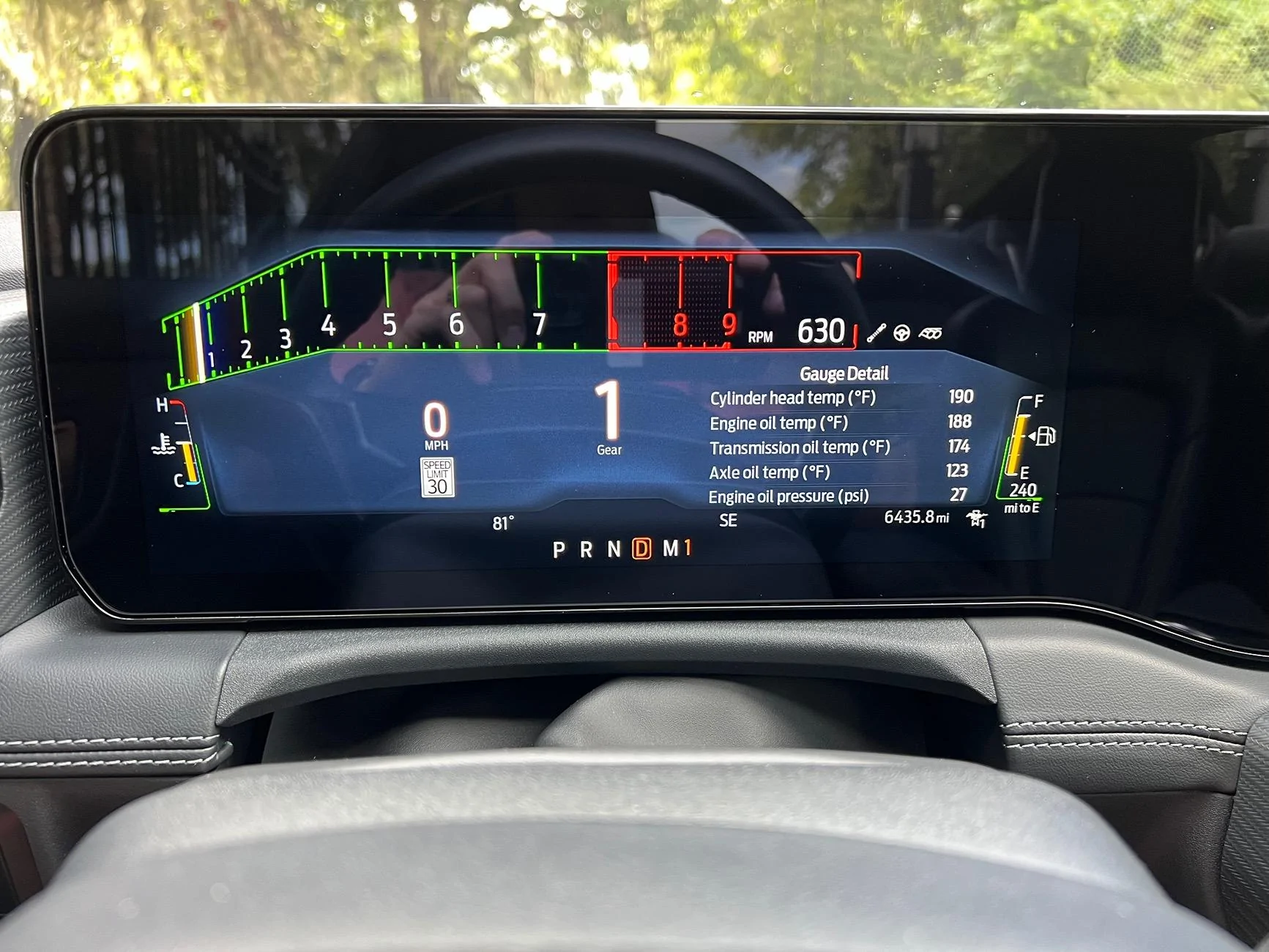

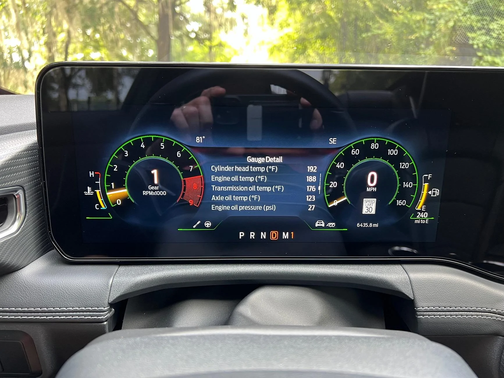

Here’s what the continuous gear display looks like in Normal, Sport and Track gauge clusters. The Calm, Classic and Fox Body only show the gear as a small number next to the M on the gear selection display.
S650 Mustang roadPilot's 2024 Dark Horse (R4964) IMG_4640
S650 Mustang roadPilot's 2024 Dark Horse (R4964) IMG_4639
S650 Mustang roadPilot's 2024 Dark Horse (R4964) IMG_4638
3,242
3,587
Thanks for saving me the hassle of taking those pics, @krisk!
