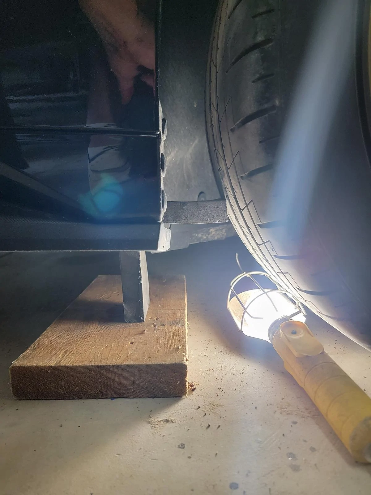

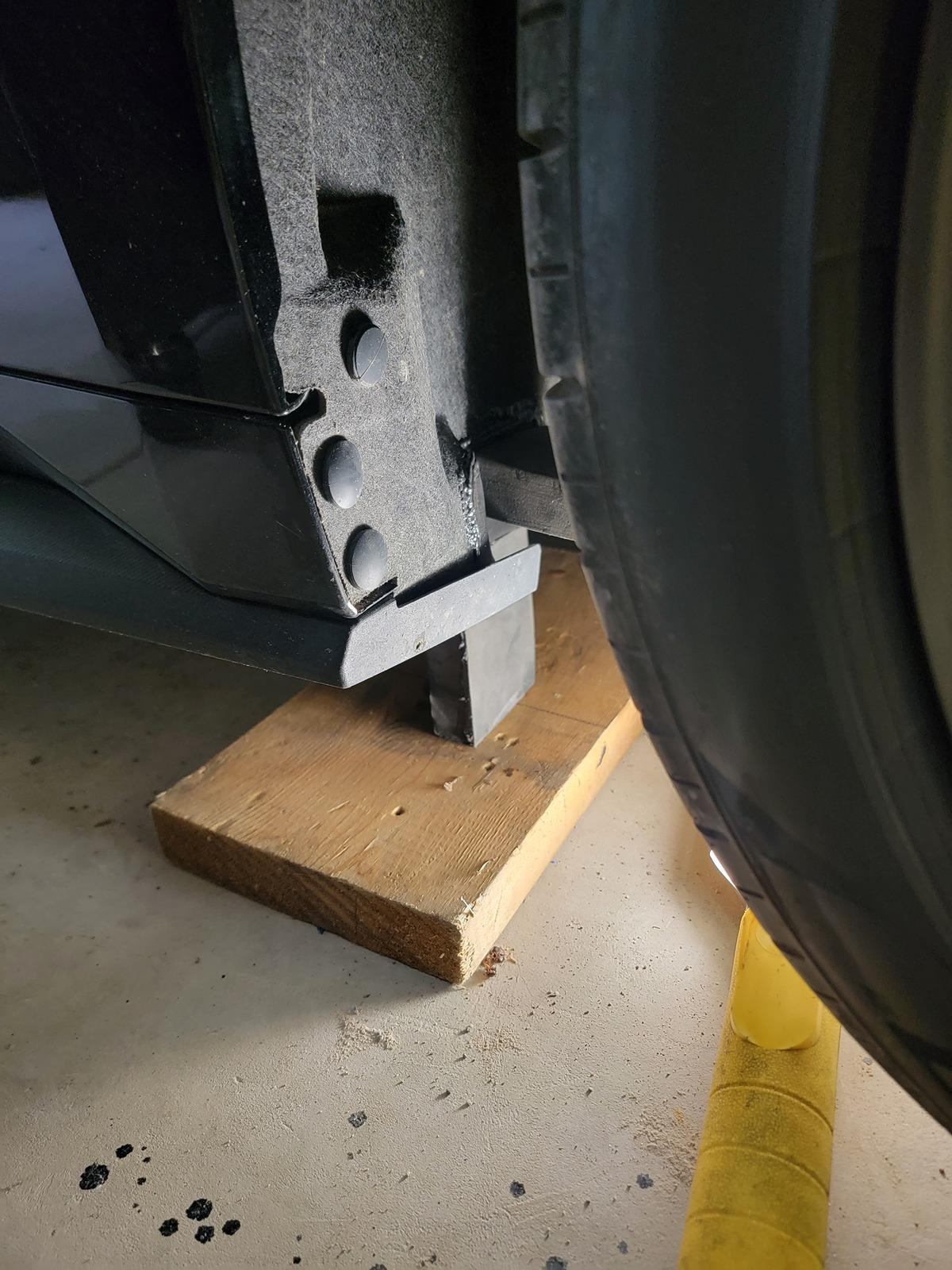

Installed my DIYVan kit today. The Gorilla duct tape I used until now seems to have kept all but a couple little rocks out. Glad this is done.

ford engineers put those holes there for a reason...
You need to use the search function.
One of our employees spoke directly with the lead Ford aerodynamics engineer in charge of the S650 program, as well as his boss. Those are solely to facilitate the assembly process. Further, they advised that it is completely safe to close them off.
In the future, I suggest that you do some research before opening your pie hole.
Edit: Here is what you would have found had you bothered to look:
https://www.mustang7g.com/forums/threads/ford-aerodynamics.161207/page-3#post-3278269

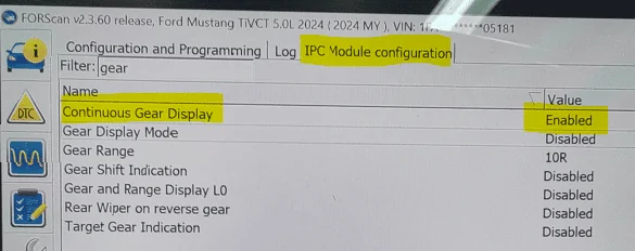

Nothing major ... used FORScan to add the CGD (continuous gear display).
Changed the splash screen logo, but decided I liked the DH one best, so I changed it back.

I'd love to see what gear I'm in but unfortunately no access to FORScan for me 🤔 😂
3,146
3,428
Sure you do. You stop by my work like you have before. Takes about 30 seconds. :rockon:
Do you just not want to buy the OBDII dongle? 🤔

Windows computer and a supported OBDII dongle. I suggest the OBDLink MX+.

is forscan a program then? how easy is it to learn? I don't wanna brick my car lmao
Yes, depends, and well …..
think of it as a hex editor for the computer systems in the car. Multitude of systems magnitude of code. Various options available and digits modified to obtain inferred (reverse programming to determine what does what by the provider - some crowd sourcing is also involved) values resulting in changed behavior. Not a common hand held toggle on off type of system.
