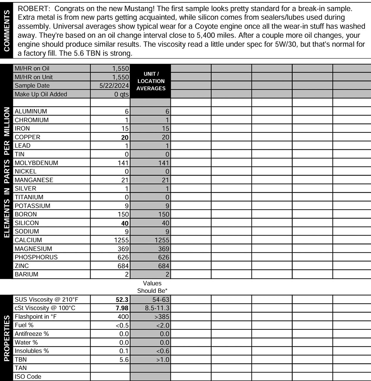

Received the Blackstone oil analysis back for the sample from my first oil change (original factory fill). Everything looks good.
S650 Mustang roadPilot's 2024 Dark Horse (R4964) 1721868980256-zd

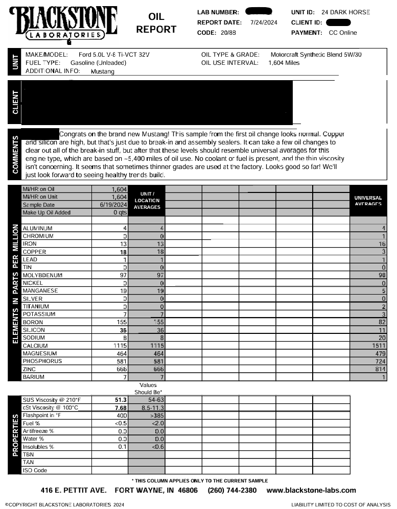

Nice! Were you gentle during break-in? I certainly wasn't. Here's mine at close to the same mileage for comparison:
S650 Mustang roadPilot's 2024 Dark Horse (R4964) Screenshot_20240724_213404_Adobe Acrobat

I wasn't gentle, but I didn't beat the piss out of it, either. Maybe a half dozen times over 4k. Otherwise, reasonably docile.

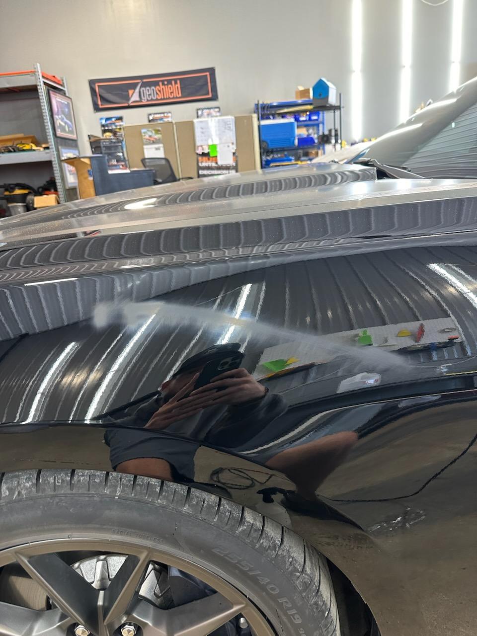

Well, good news and bad news.
Good news: The foot long scratch along the driver's fender was light enough to be buffed out by my detail/ceramic coat guy. He said it looks great.
During repair:
S650 Mustang roadPilot's 2024 Dark Horse (R4964) IMG_9017

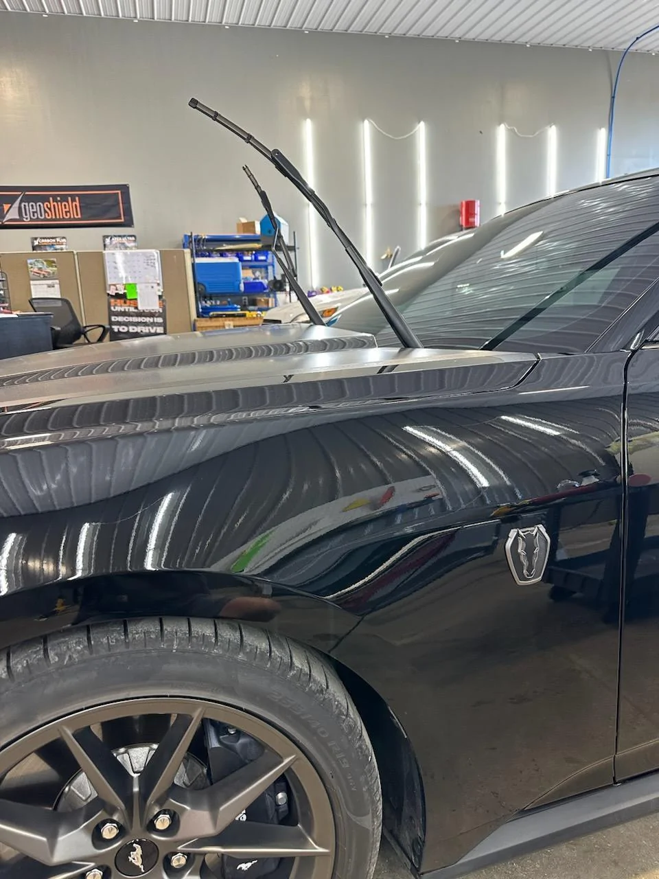

After repair:
S650 Mustang roadPilot's 2024 Dark Horse (R4964) IMG_9021

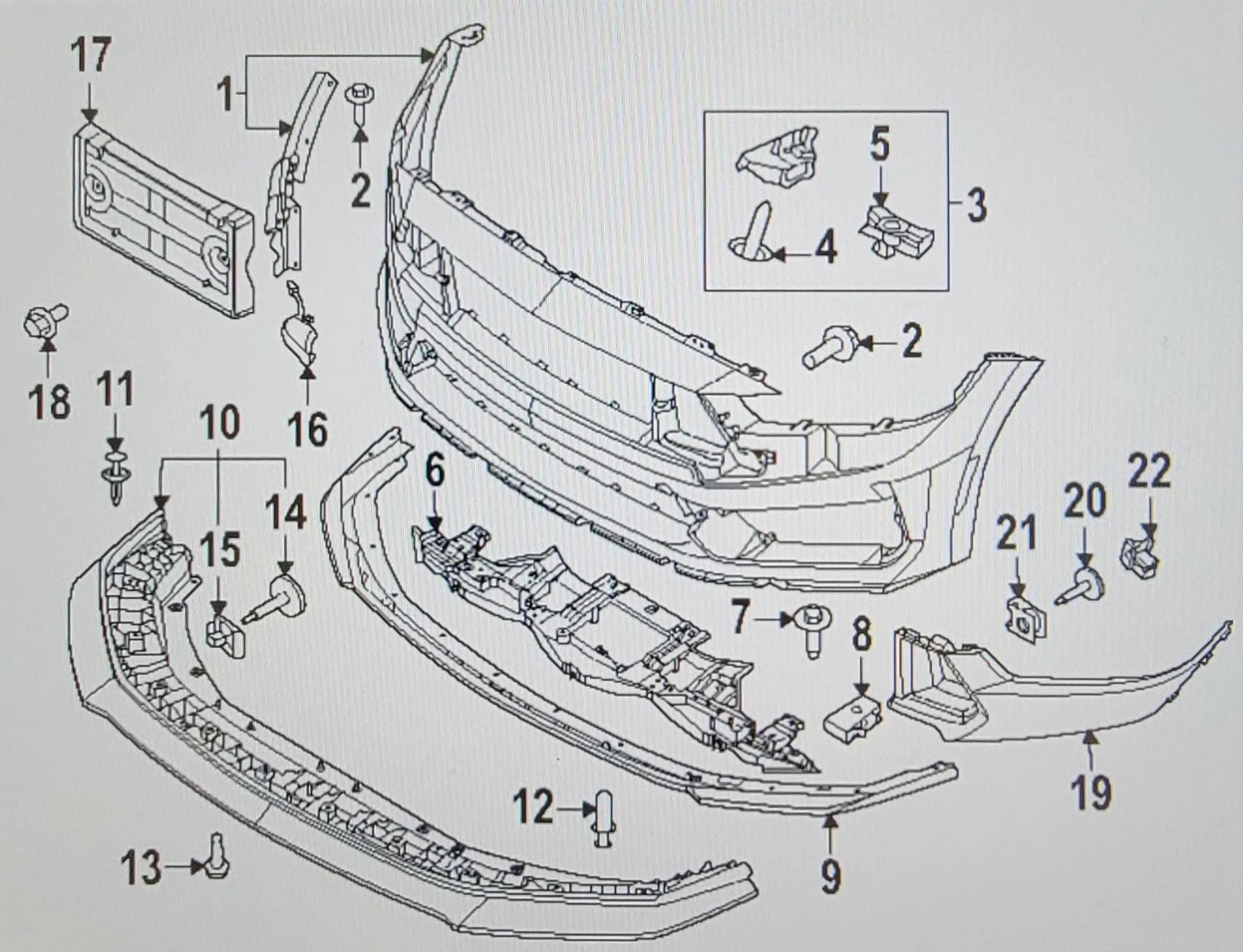

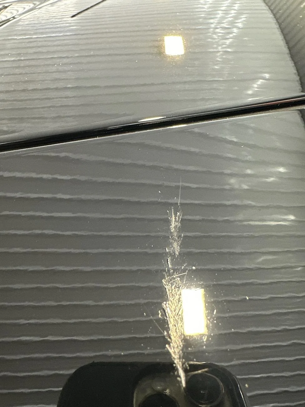

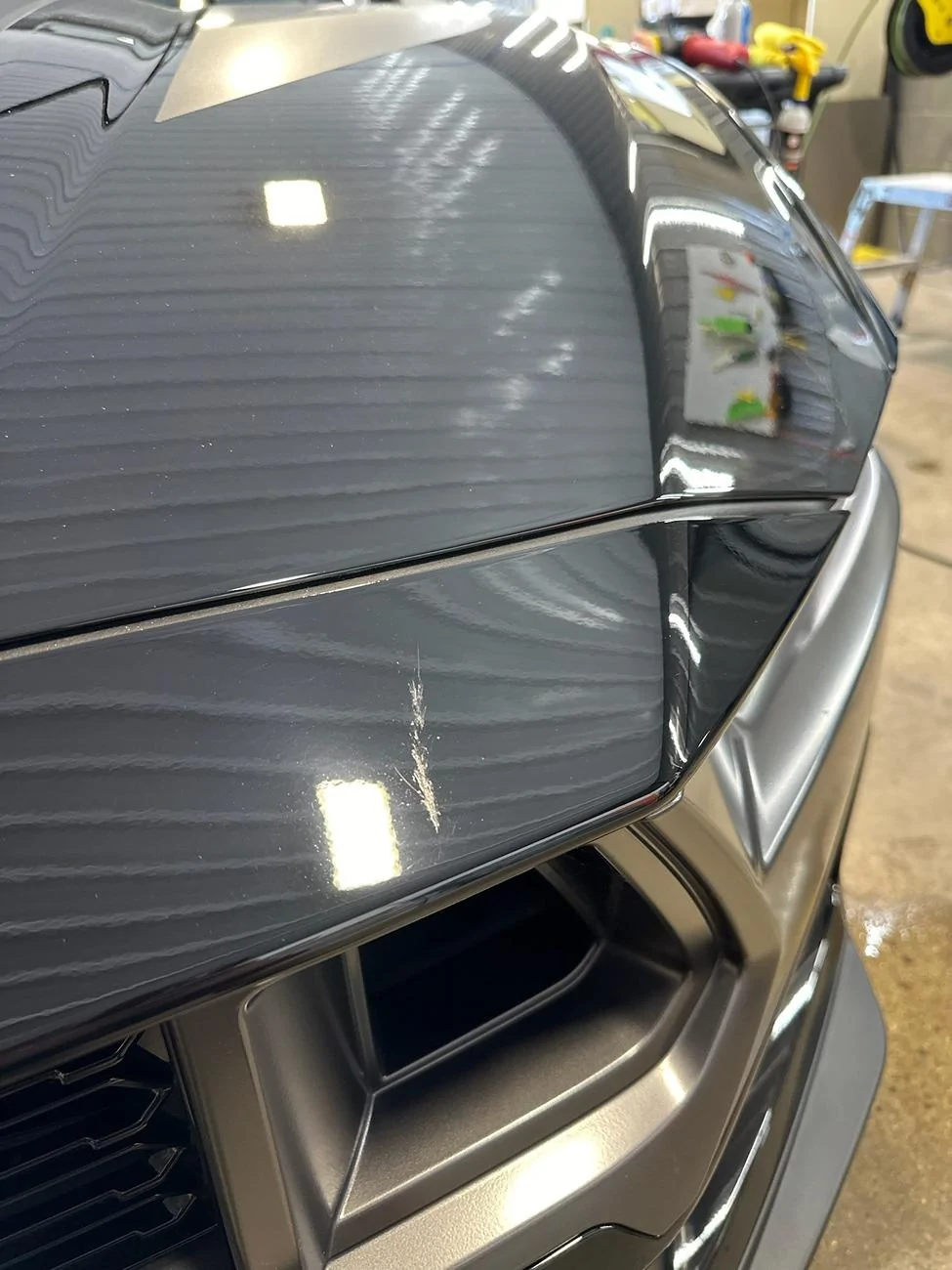

Bad news: What I thought was a "tar blob" or some sort of goop on the top horizontal section of the front bumper cover (immediately in front of the hood) is not tar or goop. He said a rock hit it and cratered the plastic bumper cover.
My good buddy who ran a body shop for ~20 years told me it can be repaired and repainted. So, I don't have to R&R an entire front bumper cover (it's all one piece). The design of the bumper cover and the location of the damage means only that top horizontal strip of the bumper cover will need to be repainted (then re-ceramic coated), so I'm thankful for that.
Not the end of the world, but still a hassle to deal with. Sigh.
S650 Mustang roadPilot's 2024 Dark Horse (R4964) 744729334
S650 Mustang roadPilot's 2024 Dark Horse (R4964) 744729321
S650 Mustang roadPilot's 2024 Dark Horse (R4964) 20240807_092234

Driver's side fender scratch is no more. He buffed it out with a rubbing compound and reapplied the entire front fender with the IGL Kenzo ceramic coating. Looks great!

I don't think PPF would have survived that impact. It works good for small stuff but after a certain size nothing will work.

Holy shit! That was a big something that tagged it. Think it was the same object that caused both issues?

PPF would have been destroyed.

No, not the same object..
Almost wonder if the other half went in the nostril…and/or if anything found it’s way that direction as well - picturing a piece of rock-salt impacted/stuck in the filter.
3,260
3,709
Impact was past the opening, so if it did break up, it wouldn't have been able to go in there.
My buddy looked @ it this morning. He said piece of cake to fix.
