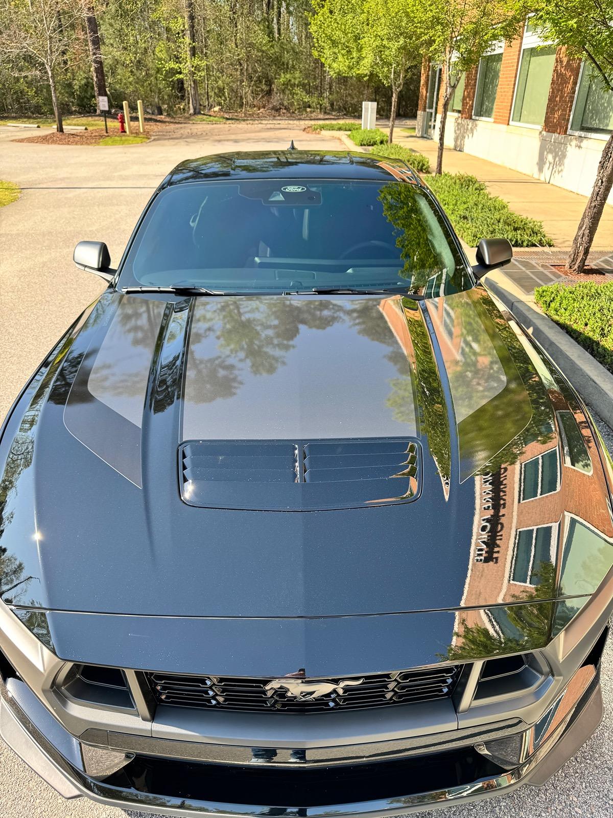

I drove my Mach-E to work today and I don't have any pictures on me to share right now, but I had partial front STEK PPF done that extends to the trailing edge of the hood vent and my installer's PPF machine template included cutouts for the graphics that extend forward of the vent so that it doesn't overlap the hood vinyl.

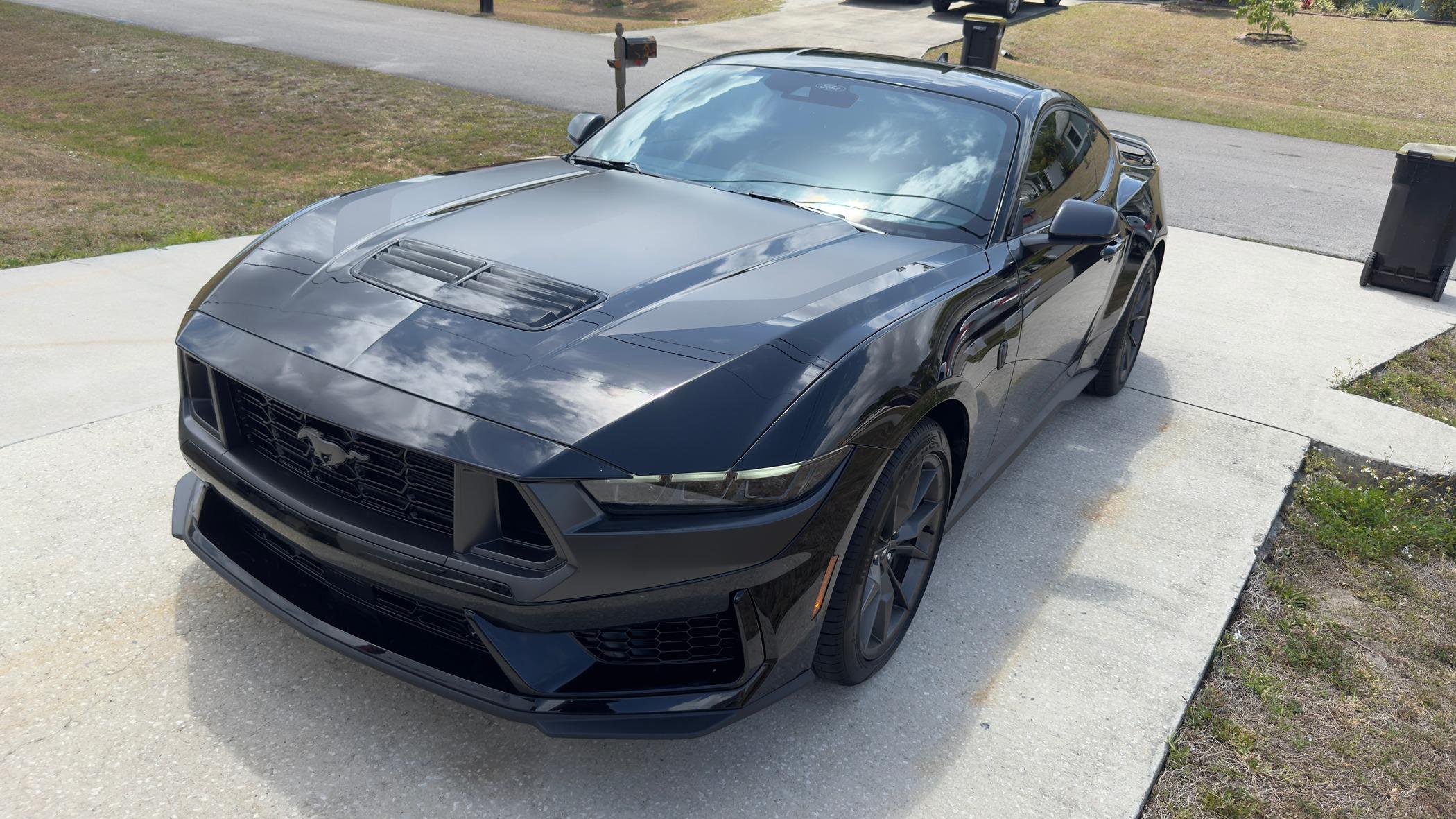

I had a shop use a single piece of PPF that went around the decal areas. The glossy parts of the hood are protected while the matte decals are exposed with only some ceramic on top. The whole thing looks rather seamless with the only seams visible near the top of the hood. But you’d have to be looking for them to even notice. Once I get her cleaned up I can show you what was done.

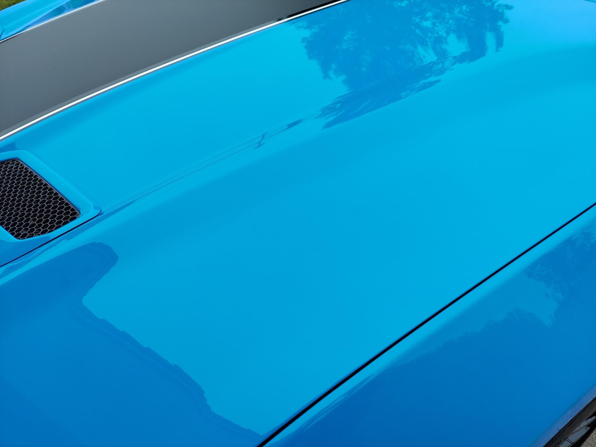

Here you go. Entire front of my DH has Kavaca PPF(Ceramic Pro)…hood, fenders, bumper. I had the option to leave off the hood decals, or try to use matte PPF, but chose to do the entire hood as one piece of gloss. Really happy how it turned out. Makes the graphics harder to see from certain angles, but from other angles it makes them stand out. We did matte PPF on the matte areas of the front bumper(under headlights) and the side mirrors. Hope these help.

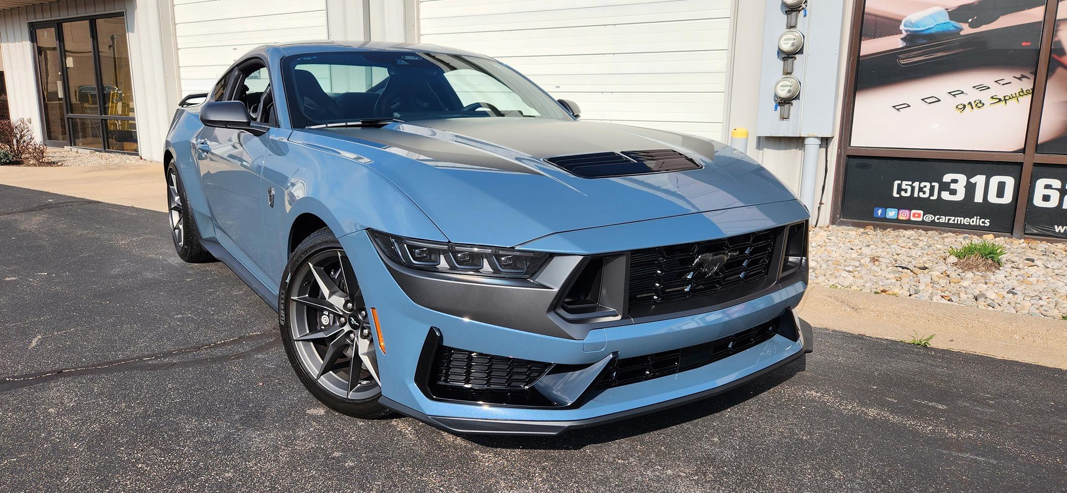

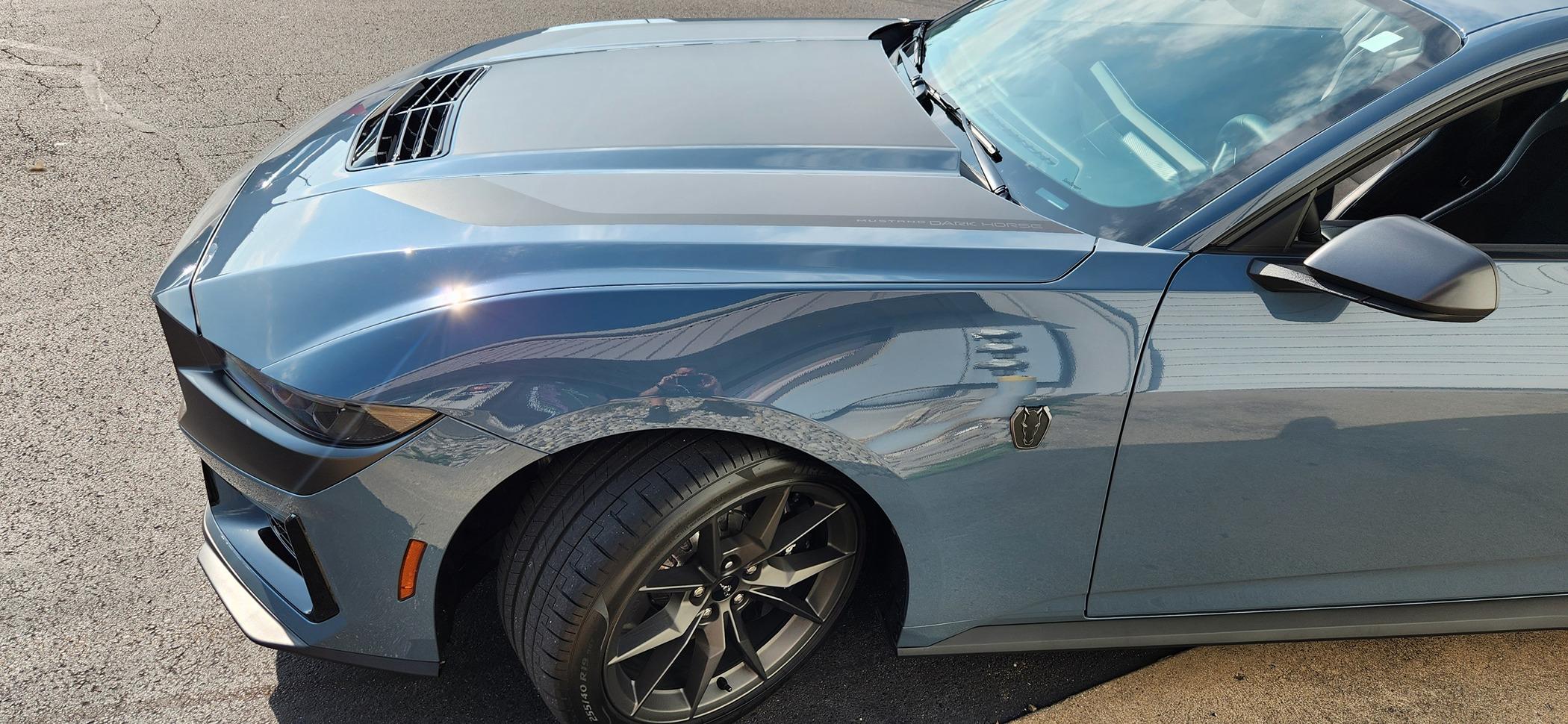

My installer did gloss PPF but cut out the parts over the stripes, then coated the stripes with Revivify in matte finish. The entire hood, front fenders, front bumpers (matte finish used on matte colored "eyebrows"), lower rocker just behind the front and rear wheels, and side mirror caps were all protected.
CarZMedics in the Cincinnati, OH, area - I strongly recommend them.

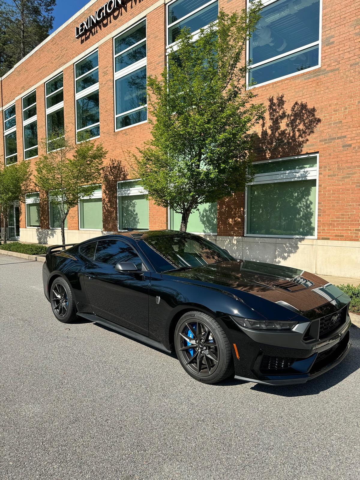

I bought my DH used with 1450 miles on it and the entire car in PPF. If you go to get it done make sure it's done right. My car had orange peel and bubbles all through the PFF so I opted to remove it all by hand, which isn't that much fun. I struggled HARD on removing the PPF from the hood because of the decal. The PFF basically stuck to it like glue and I spent about a total of 3 weekends with a steamer slowly peeling it off. If you get it done, then years later it's time to change it, whatever shop you go to will probably remove the decals altogether, then just order new ones to replace them. Check my post, I showed pictures of me taking that PPF off. Was not a fun journey.
I am considering putting PFF on the bottom bumper area again to protect against kick up and rocks, but that's my story on the matter. Just make sure you get a good brand of PFF if you decide to go that route. Best of luck!
