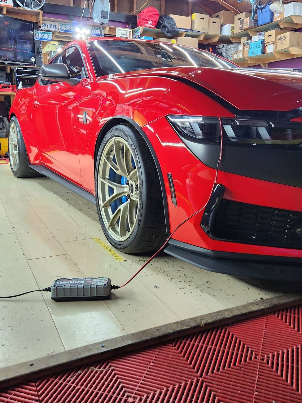

Also, no offense. I just don't see it. 325 Goodyear 3R barely fits. 5mm spacer on a 11.5 wheel. There is literally nothing left between the tire and the fender on compression and there is 2mm clearance on the inside between the damper and tire.
Some might say that a 355 section tire measures 355mm wide, but some manufacturers are way smaller and some larger. Pirelli is one of those that measures small physically.
That looks great from what I can see. Are they square or staggered with a smaller wheel and tire in the front? Do they rub?
Those do not look like they handle Vancouver Island rain very well. Is there a track on Vancouver Island?
