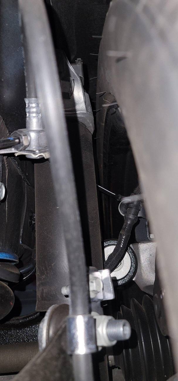

yes, please post pictures of that. no offense, but i dont believe it one bit. mine stick out probably half an inch and this is the clearance to the shock
