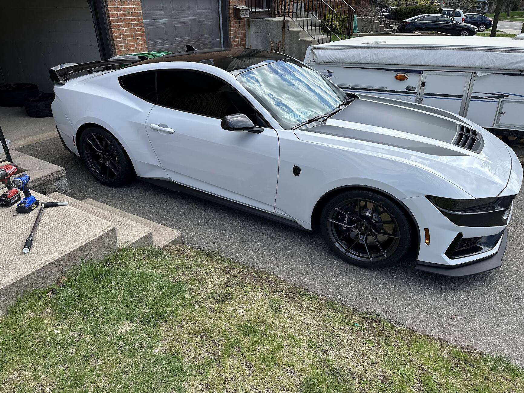

Do you have the HP? If not, any noticeable wheel gap going to 305/315?
I have the HP but I am also lowered on Steeda Sport Progressives. Here is a pic the day I swapped out the wheels. It may have settled a bit more since.
