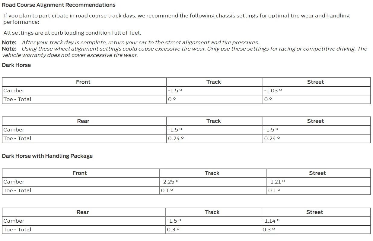

Hey I'm looking for some guidance on track alignment for a non-HP Dark Horse. I used to daily the car but now use it mostly for week-end spirited driving and summer track days.
I’ve done about ~10 track days in the car so far, but starting to take it a bit more seriously now that the warranty is coming up and I’m looking to dial things in.
I don’t have the adjustable camber plates that come with the Handling Package, so I’m curious what people are running in terms of alignment without them.
Specifically:
  • How much front camber you’ve been able to get on stock hardware. (stock wheels and tire size (Michelin PS4S)
  • Whether you’re just maxing out factory adjustment or using other mods
  • Whether that’s been “enough” for track use or if camber plates became necessary pretty quickly
  • Tire wear vs. performance trade-offs
Trying to strike a good balance before jumping straight to aftermarket plates—but open to it if that’s the consensus.
Appreciate any advice or setups that have worked well.
alignment recommendations from owner's manual below for reference:

Camber plates. The front needs more negative camber. The Ford Dark Horse handling package adjustable camber plates are not enough, so if you are going to go to the trouble of installing camber plates, I would skip this intermediate step and get something better.
Install Vorshlag camber plates. Thank me later. Go do your research online and see whether I am right.
Set the front camber at least -2.5°. With stickier tires you may find yourself wanting -3° or even up to -3.5° but perhaps start with -2.5° which you can also drive on the street if you are not doing the daily stop and go commuting stuff anymore. For your current use of the car, you would not need to change between track and street. Set the toe to 0° or, even better, ever so slightly toe out 0.1°
The rear camber needs more, too. Shoot for around -1.75-1.8° with toe at 0 or ever so slightly toe in. If you are light on the throttle exiting turns (I'm not, lol!), you would be happier with even more.
Toe recommendations are good on the Ford manual above.

Thank you for suggestions - I ended up going with ford performance camber plates and have them maxed out at -2.3 in the front. I also have the Steeda 'stop the hop' kit and front/rear adjustable sway bars and now about to pull the trigger on some new wheels and tires but am thinking 305 square might be a bit too much tire for me and a little beyond my skill level at this point, plus i believe would need more camber and/or spacers up front to fit properly and that's something I'd like to avoid in near-term if possible. Instead I'm learning more towards a smaller wheel & tire package that works with what I have, specifically -
  • Wheels: Apex ML-10RT 19x10 ET40
  • Tires: RE-71RS 285/35R19 square
I understand this would leave some performance still on the table vs. going wider with 305s but I value the idea of them being a direct fit, substantial upgrade vs. current stock setup, and a little more livable on the street. However, I'm still considering going with 11 inch wheel width with the idea that eventually going to a wider tire wouldn't require new wheels in the future.
