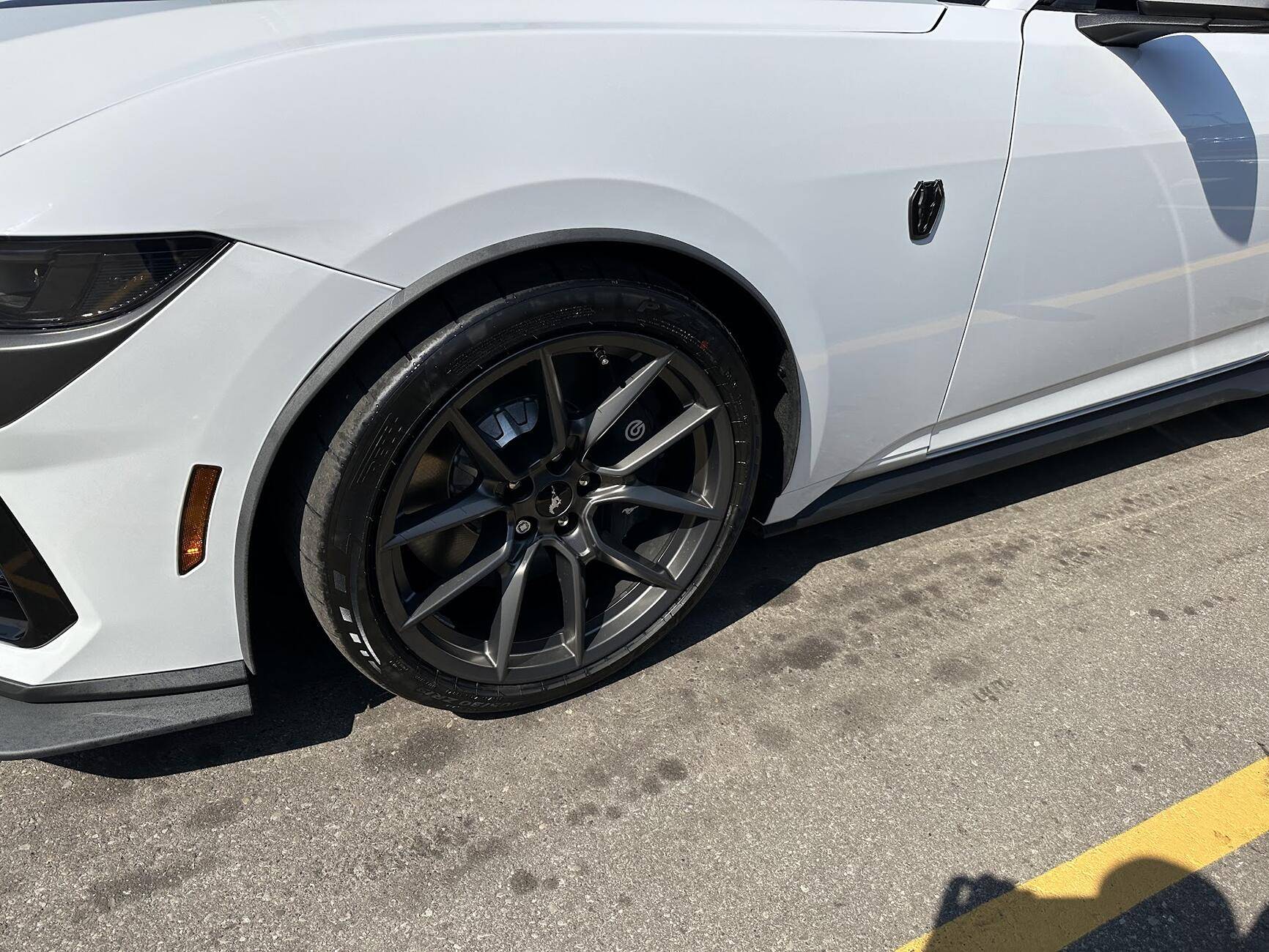

It's my understanding that the the HP sits lower than the non HP. Here is a sample from my HP Dark Horse before I lowered it and put 20s on.

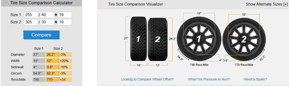

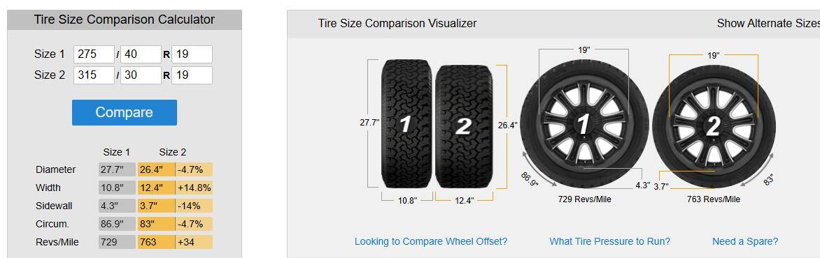

Here is a comparison of your non-hp (tire #1) vs hp tire sizes (tire #2)
FRONT
REAR
Since the non-HP doesn't sit as low, and you add a shorter tire, you will increase the gap.
