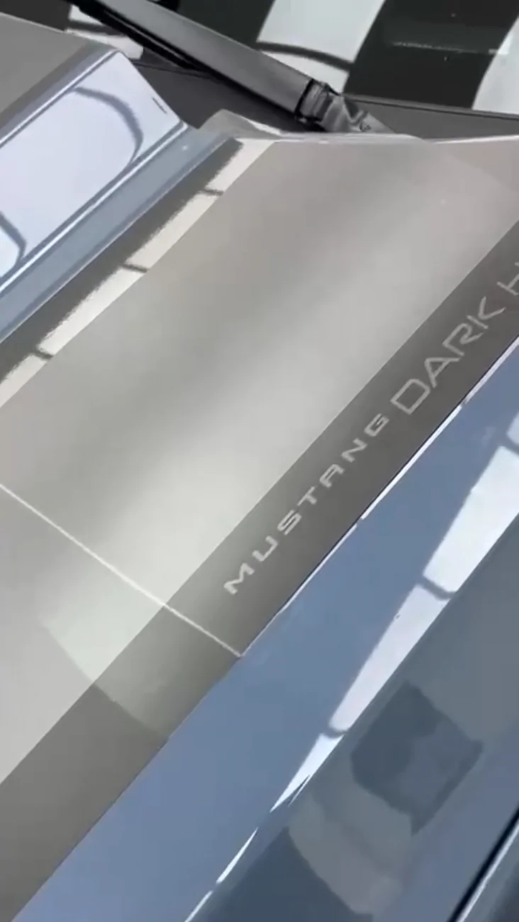

@Skye @Tony Alonso my PPF installer has suggested a fifth option that they recommend:
5. Install clear (gloss) PPF across the entire hood, then apply satin PPF (XPEL Stealth) on the bonnet stripes. This way it is fully protected and looks like stock. Here is an image where they have laid some over the top to show what it will look like. You can see where the gloss is over some of the decal and on top of part of that they have put the stealth PPF so that you can see the difference. This seems like a good solution to me, fully protects and maintains the original look. They recommended not to leave the decals uncovered. Apologies for the low quality image, I snipped it from a video.

I was offered something similar for my hood and rocker panel decals.
Protection of decals is an option each person would have to weigh for themselves. No wrong answer. It's purchasing insurance. You weigh the risk of damage against the cost of coverage and come up with a solution you're happy with.
Covering a panel with a single piece of PPF, decals and all, is generally not recommended. Given temperature changes, age, shrinkage, etc., PPF tends to lift at the edge, where the decal meets the paint and the PPF transitions across. This results in a "bubble" situation, where the PPF is pulling away from these areas.
With a plotter and database, my provider cut PPF for coverage up to the edge of the decals. I was given the option to place a ghost strip of PPF over the decals themselves, but declined.
The decals are made to last for several years. While not as strong as PPF, they are something of a sacrificial layer, protecting the paint. Considering the expense of adding a ghost strip across the decal, I could replace the decal itself.
Three years in, the decals have held up very well. No noticeable fading. No damage. But I do realize I could take a good strike in the right place tomorrow. To my hood decal, it's a few inches back from the frontal areas. And it's not as broad as the DH hood piece.
At the 10-year mark, it will be time to remove/replace my PPF. While that is done, the decals will be replaced.
Yet another option is to remove the decal. Some Mach 1 owners removed theirs but kept the badging. It's a personal choice.

Mirror backs and raccoon eyes I’m going with stealth. Still not sure what to do with the hood, I’m most tempted by the cut out and ceramic coat on the decals tbh. Will ask them to leave it until last, so I have a couple days more to decide.
I can see the logic with respect to not covering the whole decals as there will be a very small space where the PPF meets and goes over the edge of the decal, which I can imagine would get worse over time. However, the work will be warrantied, so I can always bring it back in if it doesn’t work and get them to do the alternative. Not covering the decals would mean there’s an edge of the clear PPF right next to it, so I will have to trust their ability to do the best job possible to line it up accurately. I don’t doubt they’ve got the skills, I’m just not sure what’s best for me.
