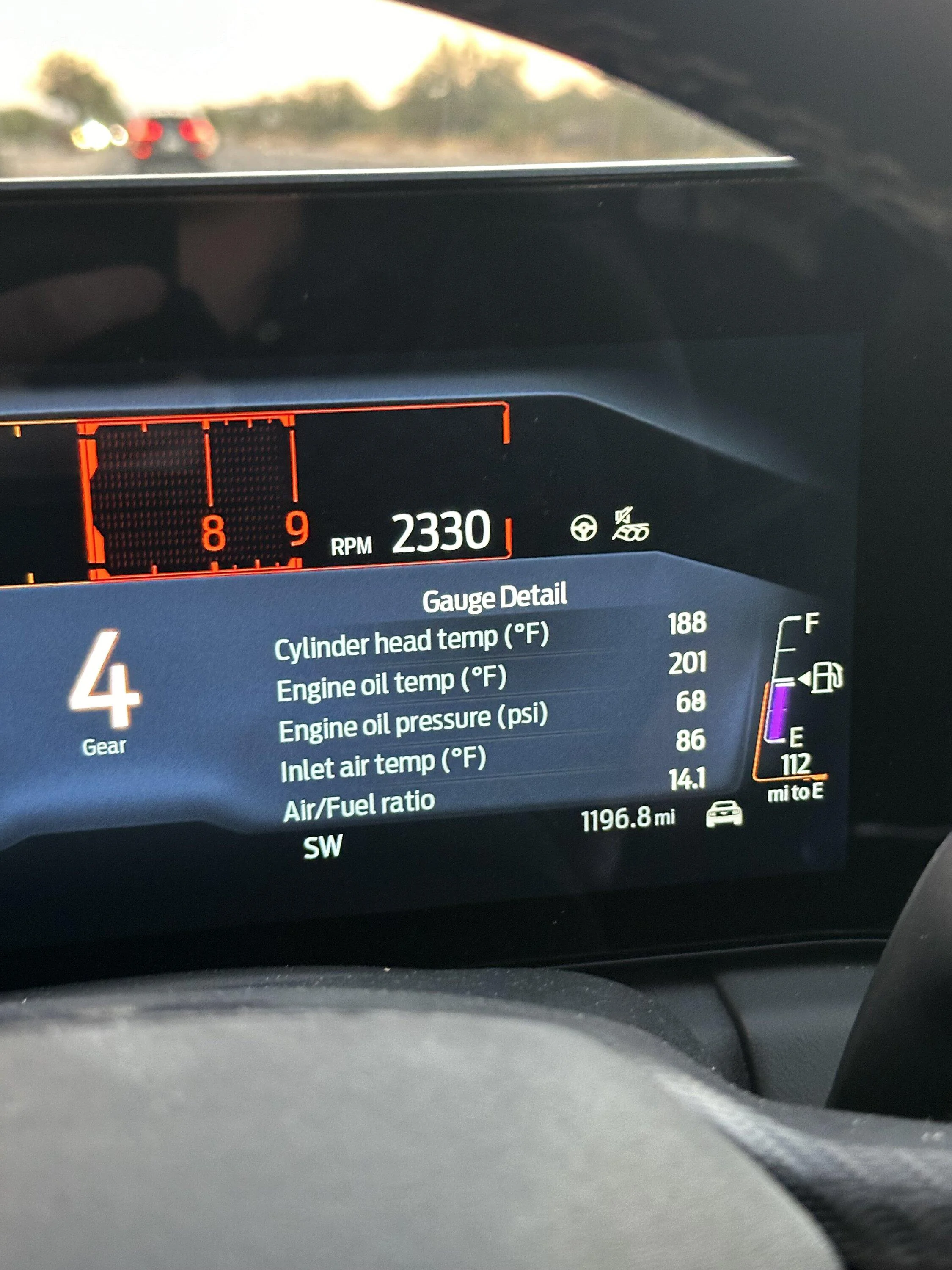

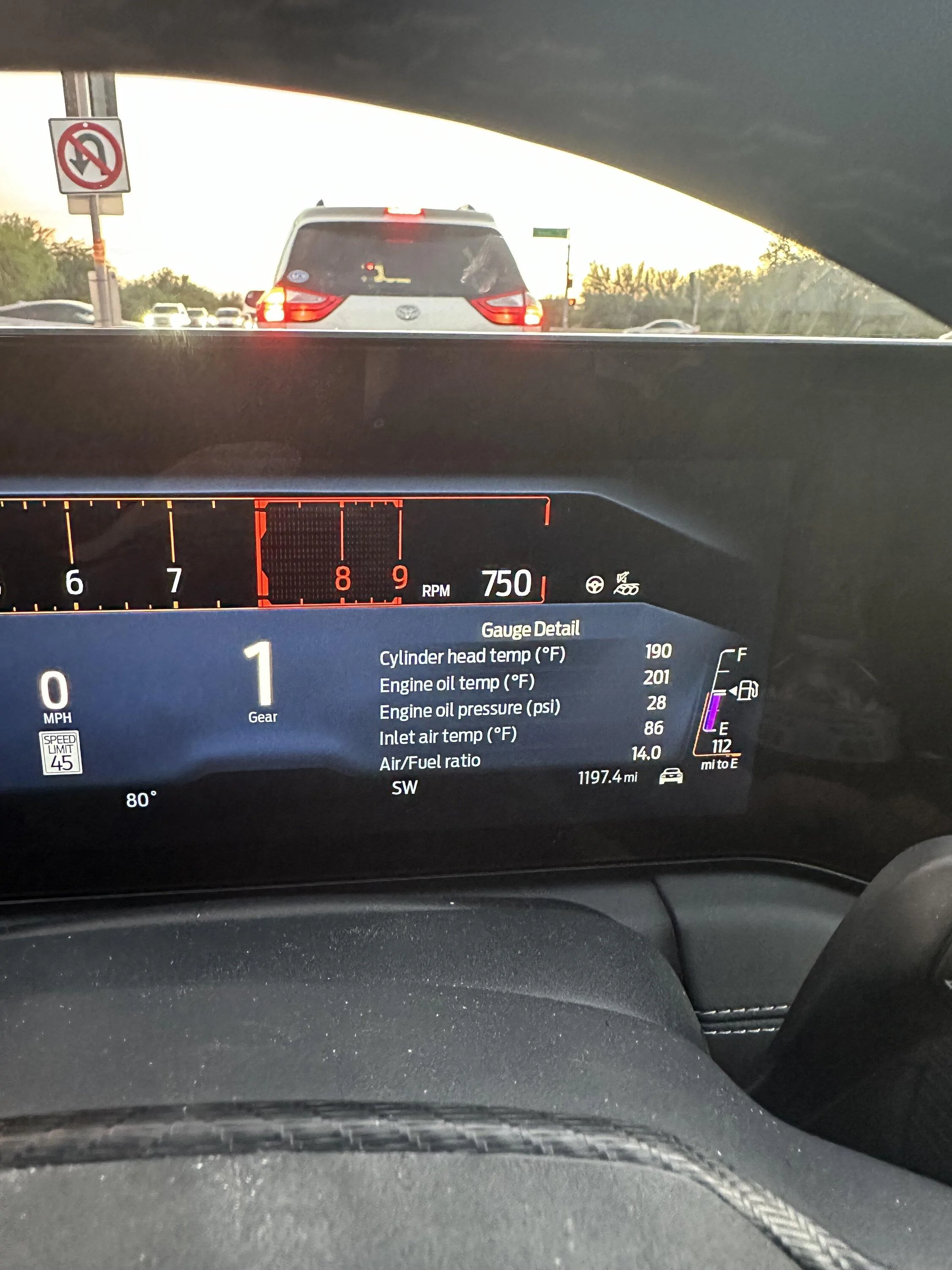

I just changed the oil in the car (5w-30) and used a Ford Motor Craft Filter (FL-500S). I noticed the my oil pressure is showing high.
For Example: Idle seems normal at 30psi
I get to around 4500rpm and the psi is touching 90-100psi.
anyone have any input on this?

I am seeing the same numbers with my Dark Horse. I figure Ford decided low pressure at an idle was more fuel efficient and high pressure was needed to float the bearings at high RPMs.

I have a Gen 3 5.0 with an M6.
Cold start oil pressure pegs the gauge. Warm idle is about 20 psi. Once at operating temps, pressure increases with RPM. Seeing the gauge move past at least 60+ psi with every shift is normal for me.

What oil pressure are you guys running at like a stop light when fully warmed up? I’ve seen mine at like 14 psi isn’t that to low ?

@SWPHX for a reference point I have the same readings on both of my Gen 2 5.0 manual as Skye with the Gen 3. Looks like everything should be normal.

Doesn’t seem not normal from mine and what i experienced on my 16 GT PP.
Warmed up on break in oil and I’m seeing 21-23 psi
I am seeing the same thing. 14 psi at idle after complete warm up and a little spirited driving. Was curious what others are seeing,

I'm running about 29-30 at idle. Like others, mine flirts with 100 under load.
