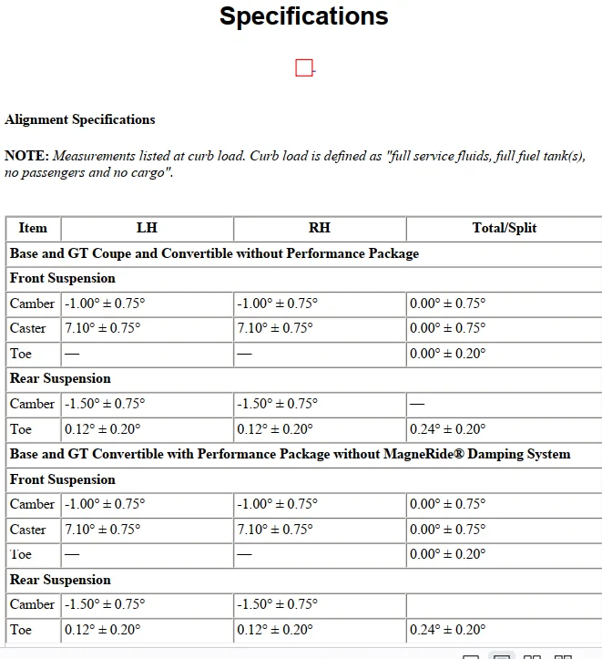

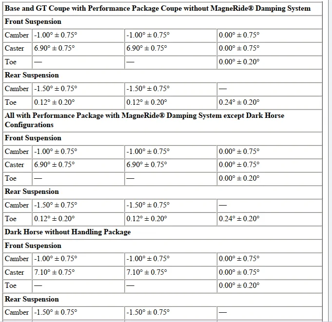

Thanks!
Wow so not only is there no difference in Camber between GT base, the GT PP, and the DH, but the camber is pretty darn tame too. - 1.0 is nothing. I'm very surprised it's that way in PP cars and DH cars.
