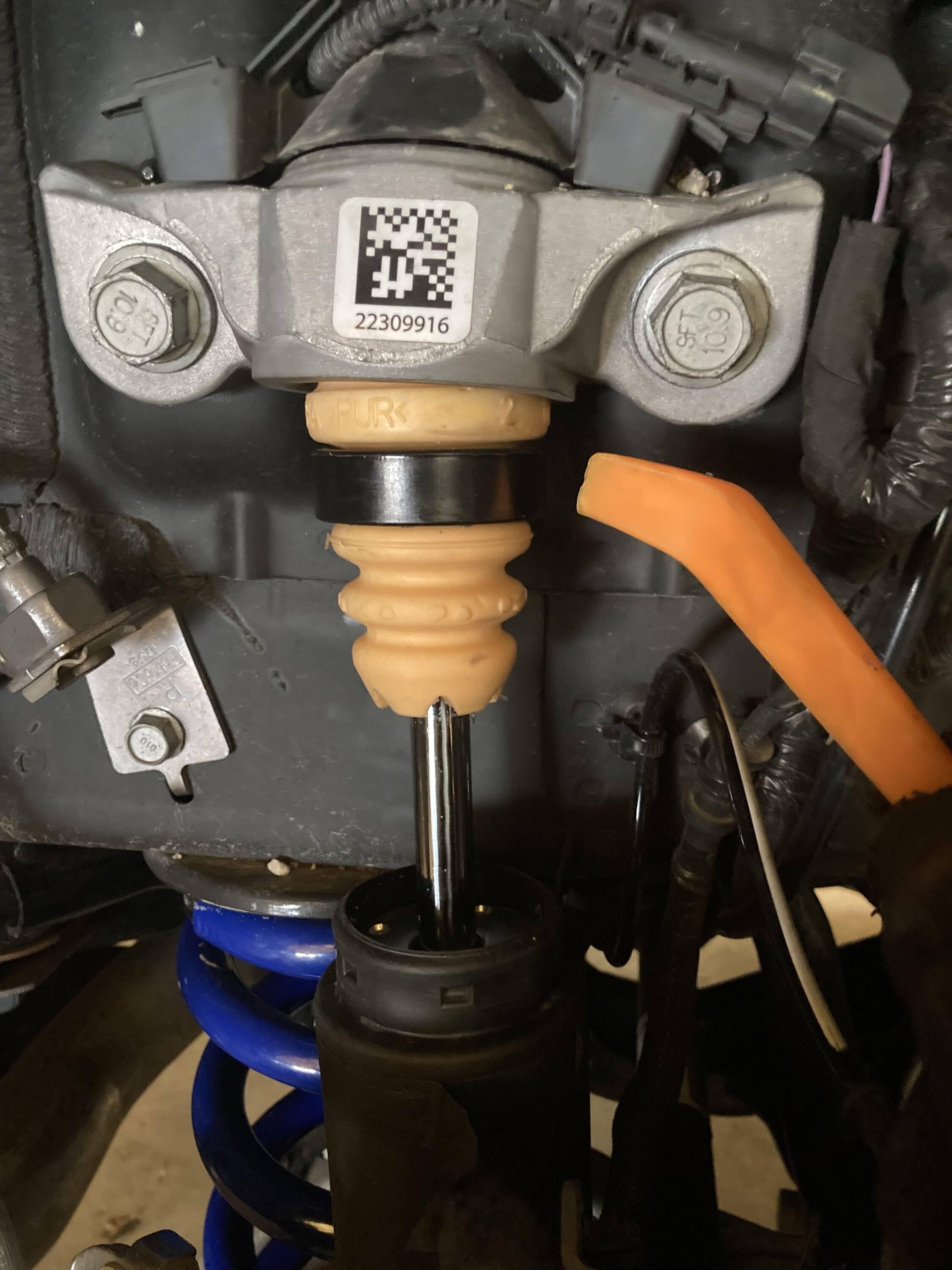

just trimmed the bumpstops on my 24DH
fyi you do not need to disassemble or remove the shock. just use a pry tool to pull down the boot. see pic
