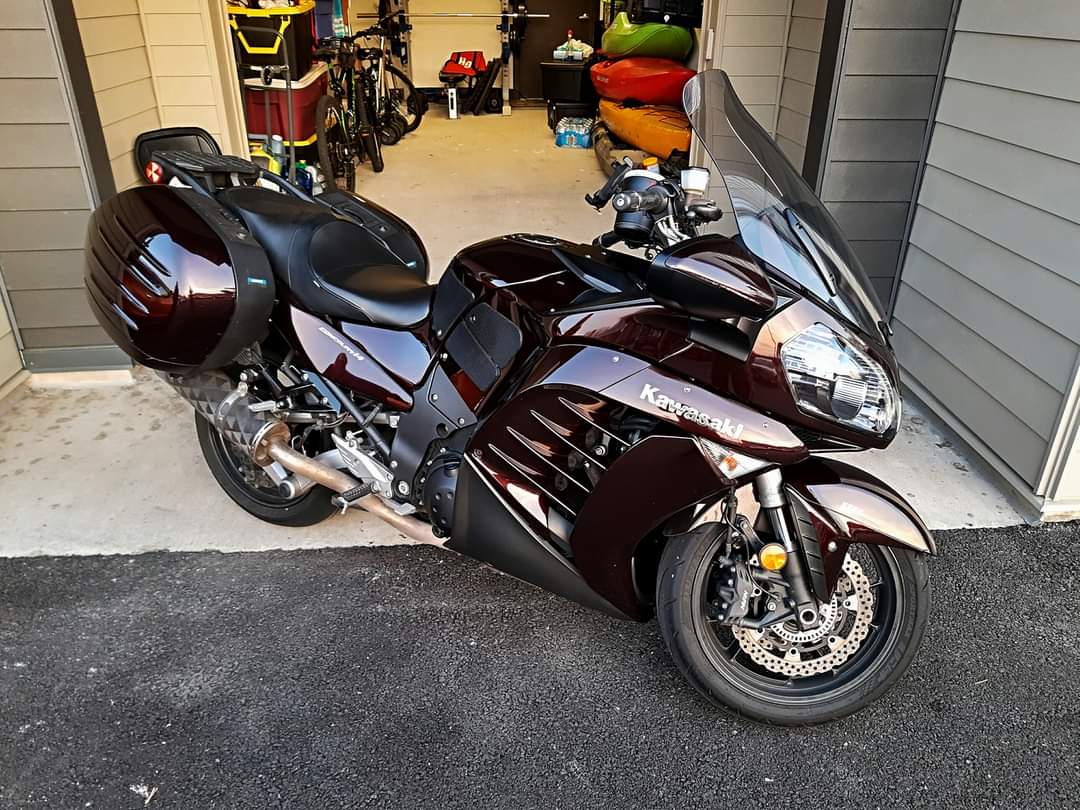

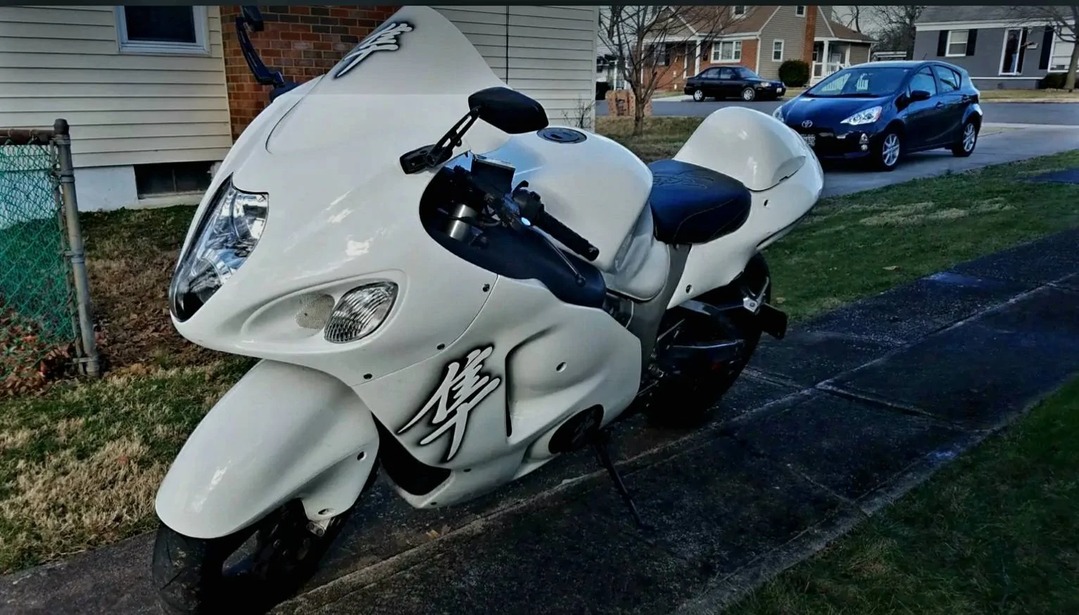

You sure it's not just breaking the tires loose? My hayabusa and zx1400 will effortlessly bust the tire loose at 8-9k rpm in the lower 3 gears. RPM will climb but you aren't accelerating.

That's pretty fast for wheelspin on a bike, fun isn't it?
