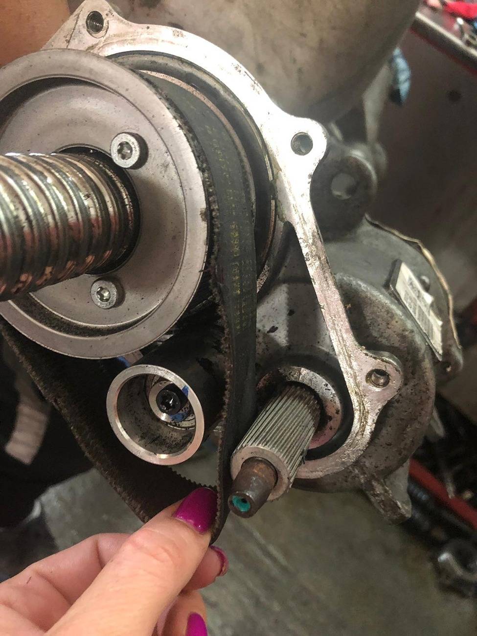

I downloaded that pic from another Member's post, either here or at the 6G site.
I hoover up stuff like that all the time. So many people post great examples of topics. :like:

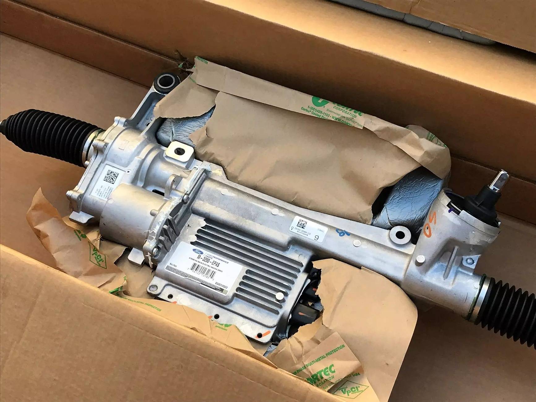

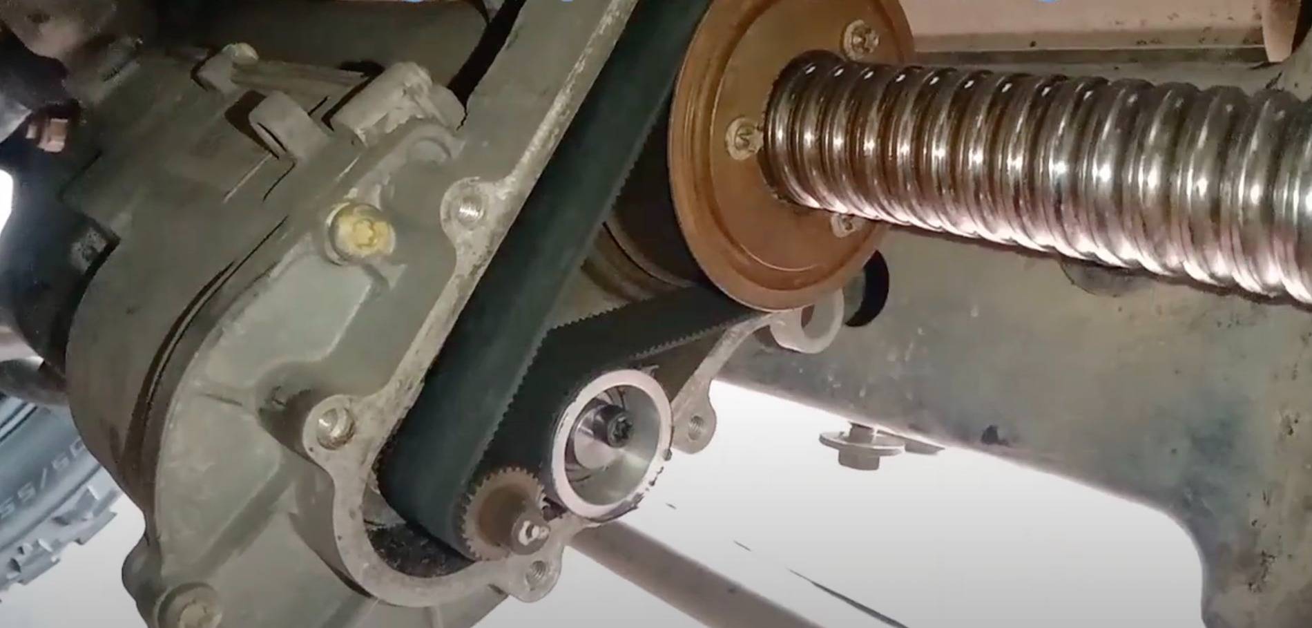

Updating some items for my stash, posting them here.
In the first photo, an entire EPAS rack assembly. The motor is most forward. The belt drive, to the left. Steering column tie point, to the right. This is a Ford rack, not necessarily one for a S650. Disregard any PN# references.
In the second photo, what a belt drive looks like, assembled.
Notice the linear screw, for quicker, more precise control versus legacy steering linkage.
Refreshing my training on the topic, there is a "manual" mode for these systems, a fail-safe. If the unit fails, the driver should be able to continue to drive the car, with legacy, manual steering. I'd like to think that's what happened in this example. I hope we can find out more once the dealer has had time to diagnose the problem and propose a solution.
S650 Mustang Power steering locked while driving epas rack complet
