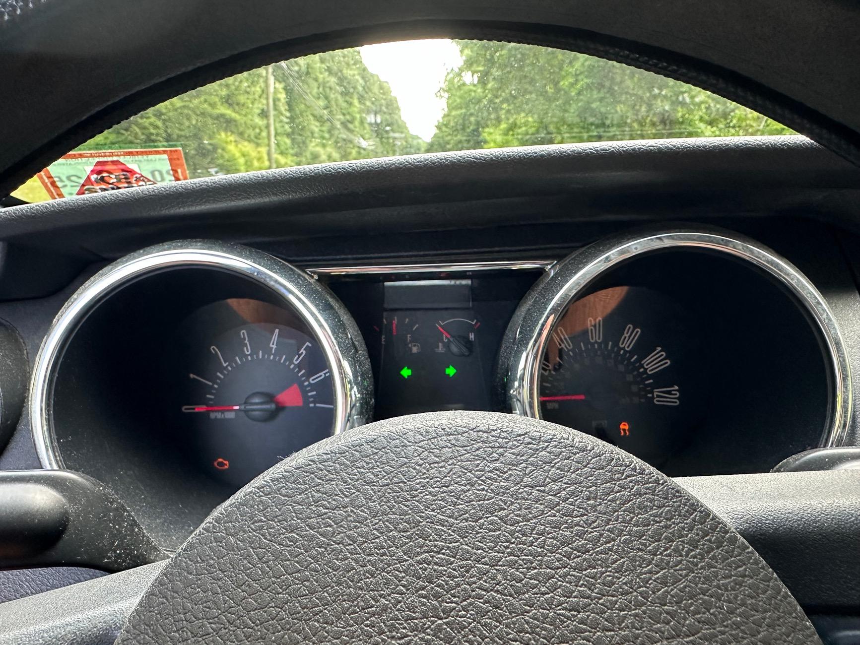

Hi, I have a 2005 Ford Mustang and recently, it has been shutting off on me while I am driving, with all of the parts of the dashboard dropping to 0 and the car doesn’t start back up. My mechanic couldn’t figure out the issue as the battery is working fine and it ended up working fine in the morning, but now we suspect there is an issue with overheating. Any help on this issue would be greatly appreciated.

Did your mechanic hook up a scan tool? That's the first thing to check. You say you think it's overheating, is the gauge reading high before things shut down?

I see you've got a temperature gauge. How does it display? Especially before the event.
