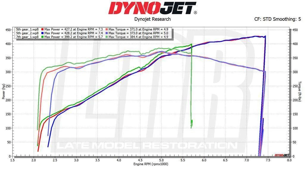

Anyone else experience a slight drop in power at 6,000 RPM? I do see on dyno graphs online that torque does drop off at 6,000 RPM so maybe it's because of that? This is on a 6 speed MT trans.

With that background out of the way, let's turn to the S650 GT engine's dyno graph.
S650 Mustang Loss of power at 6,000 RPM 2025 GT 1750682718908-z0
As you note, the torque is "dropping off" at higher rpm. Note that the figures for horsepower and torque cross at 5252 rpm (see the formula above where 5252 is a constant in the formula, so this is always true for every engine). See, however, the horsepower, which is the work being performed (moving your car), is still climbing at that point and on to higher rpms, all the way up to about 7200 rpm.

He's referring to the power flattening out at 6,000rpm
Yes that's what I was referring to, so there may be a connection to that as to why I feel a slight stop of pulling
