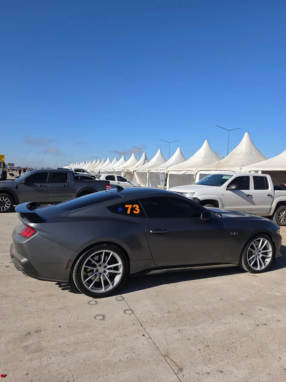

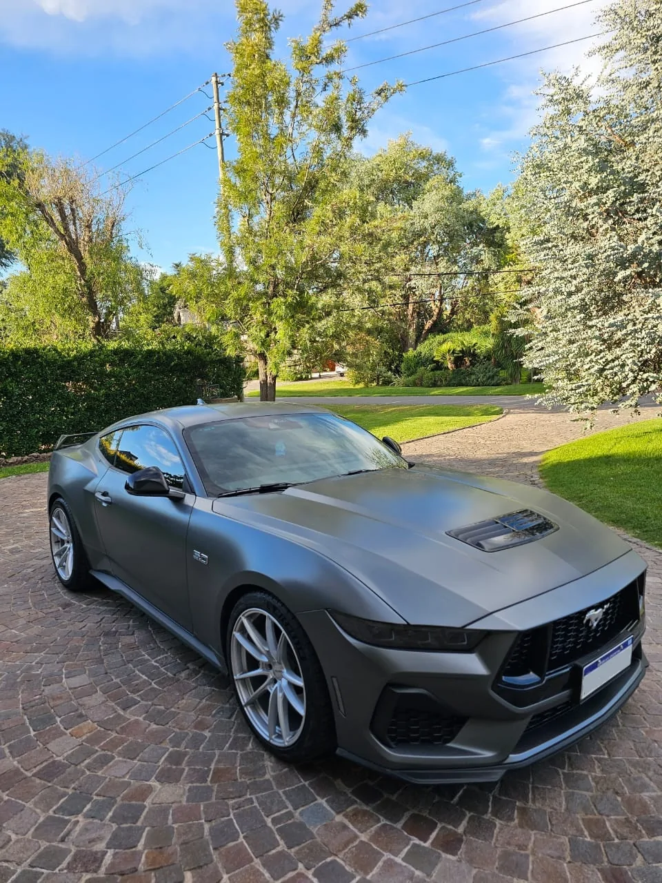

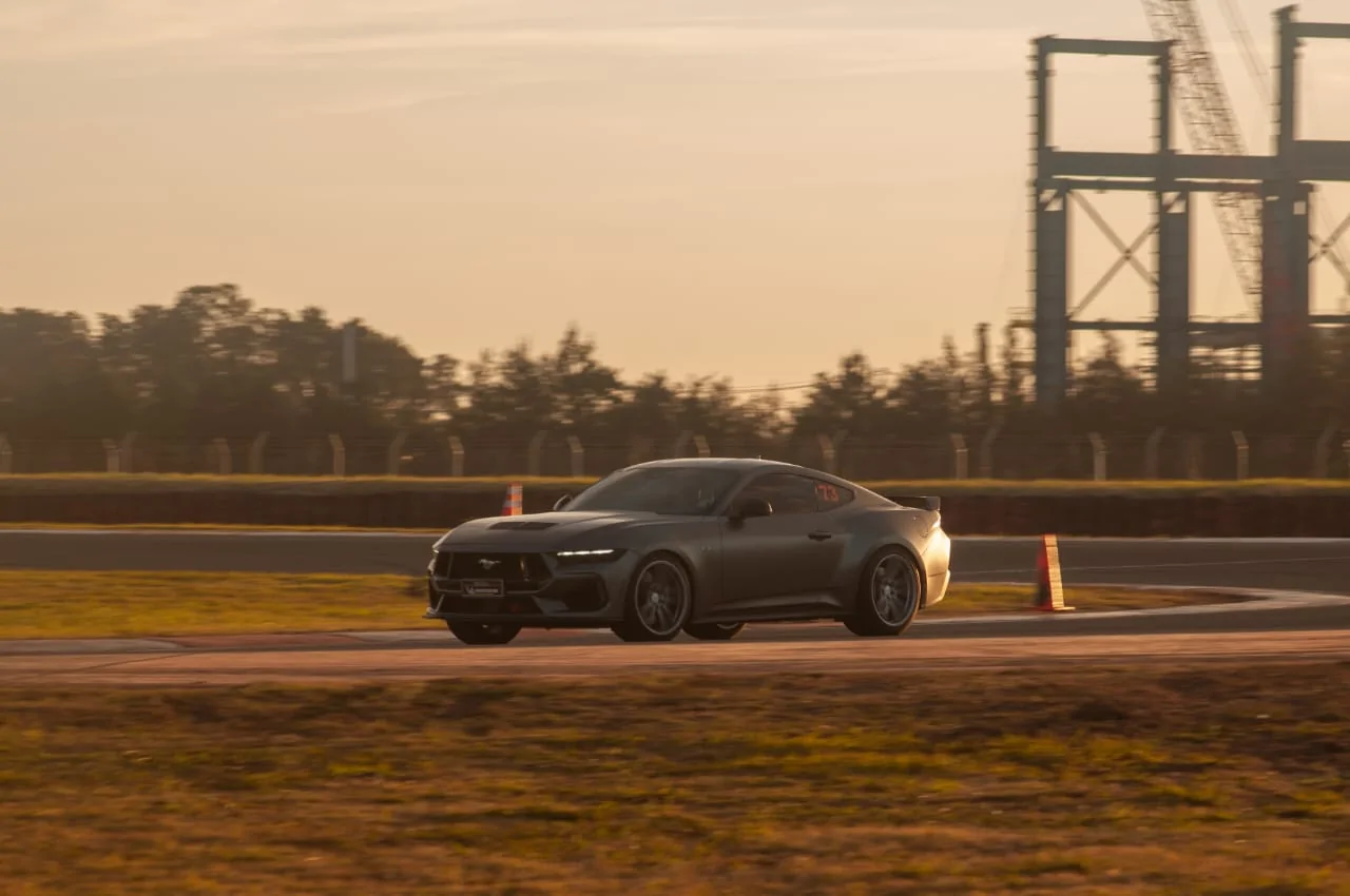

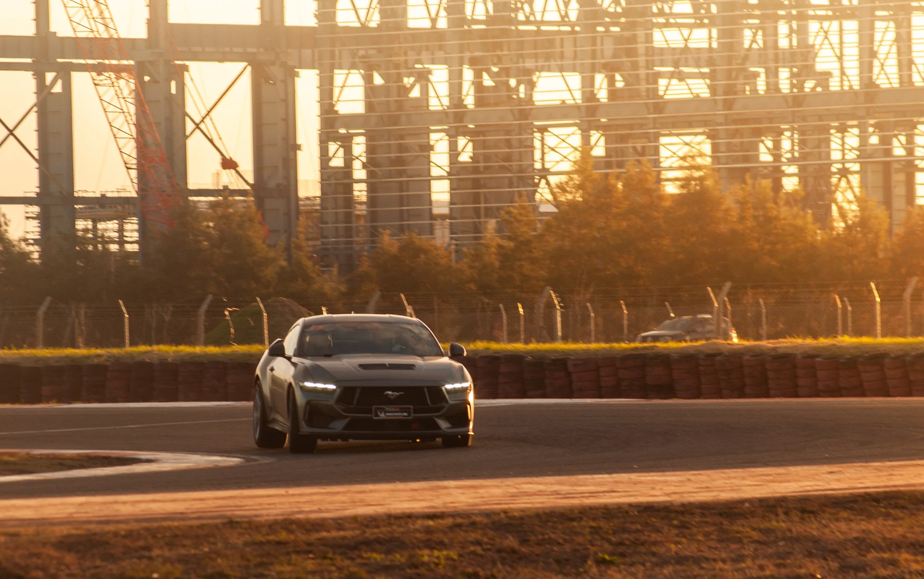

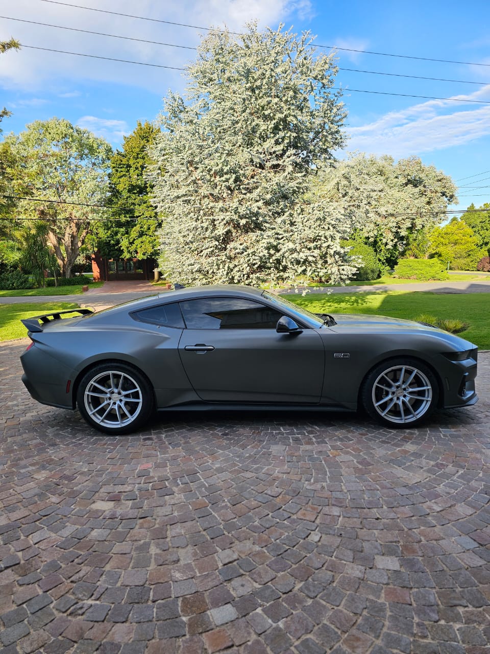

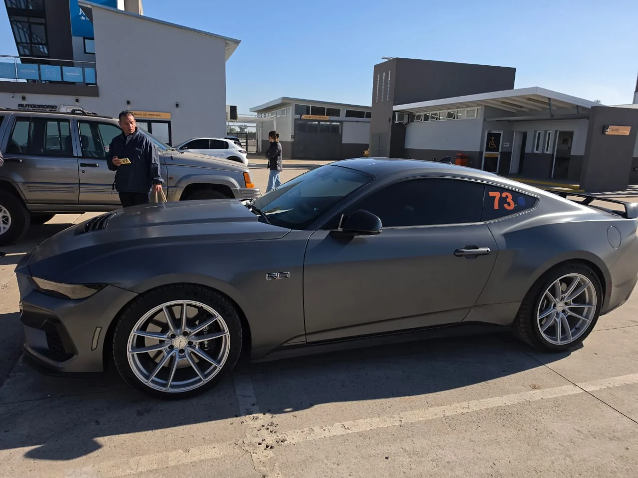

Here i upload some pics to make the thread better (i think)
S650 Mustang Looking for upgrades for track use (novice driver) WhatsApp Image 2026-05-26 at 16.31.33
S650 Mustang Looking for upgrades for track use (novice driver) WhatsApp Image 2026-05-26 at 16.04.41
S650 Mustang Looking for upgrades for track use (novice driver) WhatsApp Image 2026-05-26 at 16.30.41
S650 Mustang Looking for upgrades for track use (novice driver) WhatsApp Image 2026-05-26 at 16.31.32
S650 Mustang Looking for upgrades for track use (novice driver) WhatsApp Image 2026-05-23 at 11.12.52
