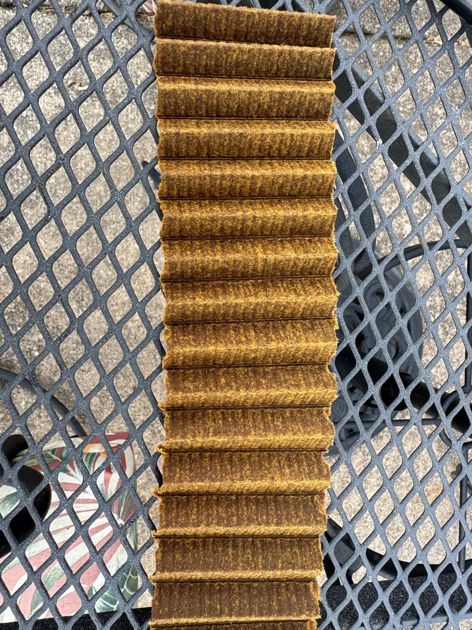

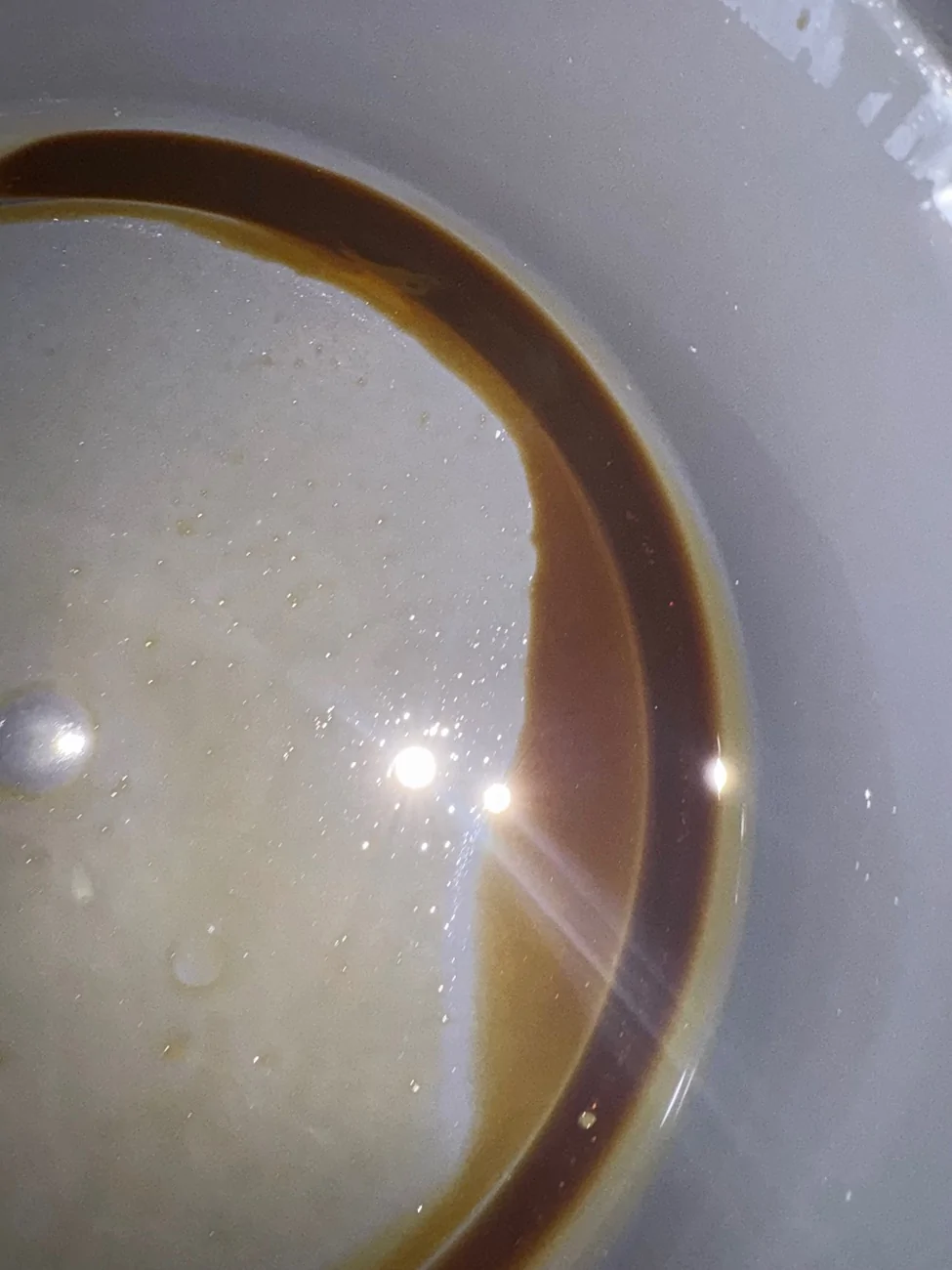

Just went and took some pics of the drain pan what left after I drained the oil back into the containers and also a pic of the filter cut open.
S650 Mustang Just did oil change was wondering if any amount of glitter is good in oil change? IMG_2897
S650 Mustang Just did oil change was wondering if any amount of glitter is good in oil change? IMG_2901

It just seems weird that none of that was caught in the filter.There is a thread on the 6g forum from awhile ago on a gt 350 that had quite a bit more and I think it turned out to be some kind of additive that was added that gets suspended in the oil.Hopefully that is the case here but probably not my luck lol.Going to send a sample from what I changed from the previous owner and then when I get the results back send in another one with the oil I just put in with some miles on it.

Thanks everyone for the replies.I have blackstone sending me a kit.Since I have already changed the oil how many miles should I put on the new oil before I send it in?Blacktone says to take the sample roughly about half way thru the drain and not to start the car before I take the sample.Also I cut open the oil filter and do not see anything in it at all.
Can you get any of the flakes in the oil to stick to a magnet?

I used a magnet and none of the particles you see will stick to it there was just a couple of small pieces that did but that was it.
Okay, it's not steel or iron then. But aluminum, copper, etc are bearing materials and won't stick. I'd keep driving it for a bit and see what it looks like in a few hundred miles.
Can you get a small screen or cloth and try to get the glitter out of the oil and maybe rinse the oil away with degreaser and try to see what color it is?

Looking at those photographs, I am not so sure that there is anything to be concerned about.
