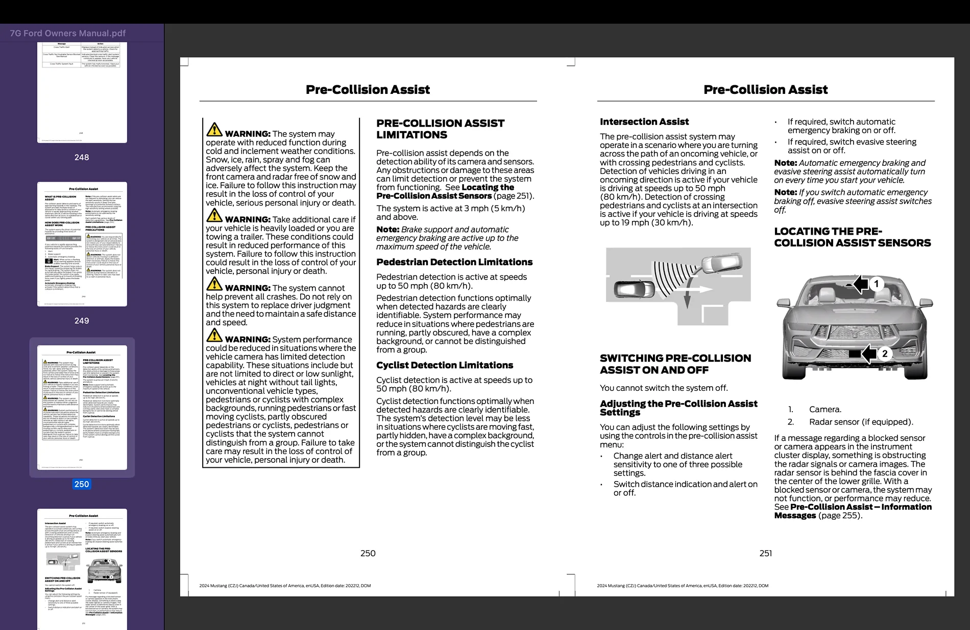

The dealers sales staff deals with many different cars, so the info they give you may or may not be correct. Read the manual to see how all the systems work, and their limitations.

An entire section is dedicated to pre-collision assist. Attached is an excerpt.
The feature/s used both the camera and the radar sensor.
Pre-collision assist is active at 3 mph/5 kph and higher.
There are adjustments the driver can make and limits of the system. The manual explains those in detail. Could be worthwhile to jot notes.
