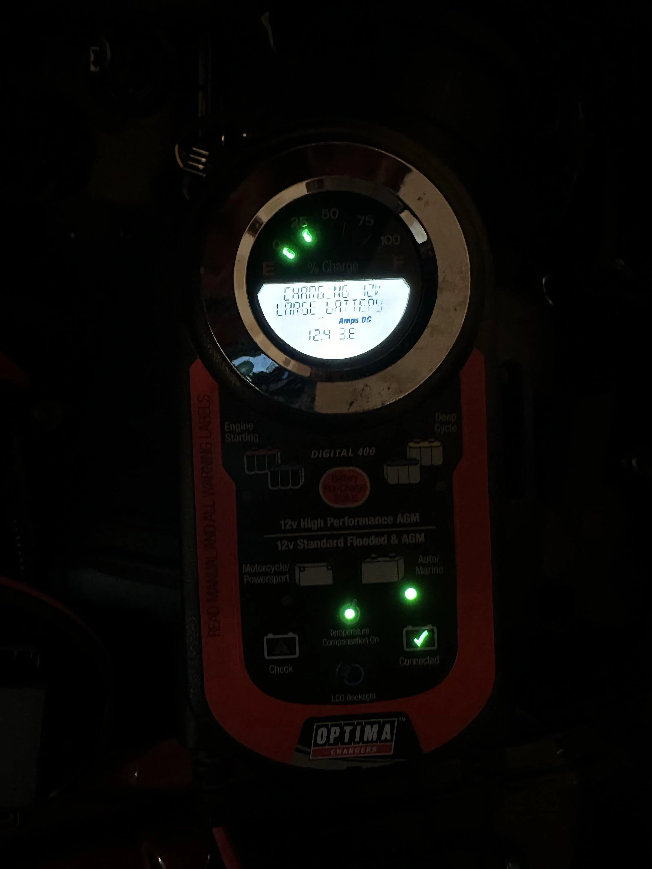

we’ve received the ‘remote features’ disabled message a couple of times (and admit have yet to visit the dealer - summer only tires and what not blah blah).
since the greeting and the pony projection aren’t really ‘remote’ features (as in doing something from a remote location) and are deactivated when the batt gets low I wasn’t sure if it could be considered an indication of the charge state.
like if it was supposed to say hi but she just sat there you kinda get the impression theres something amiss before even trying.
S650 Mustang Greeting, Pony, remote features disabled IMG_0914

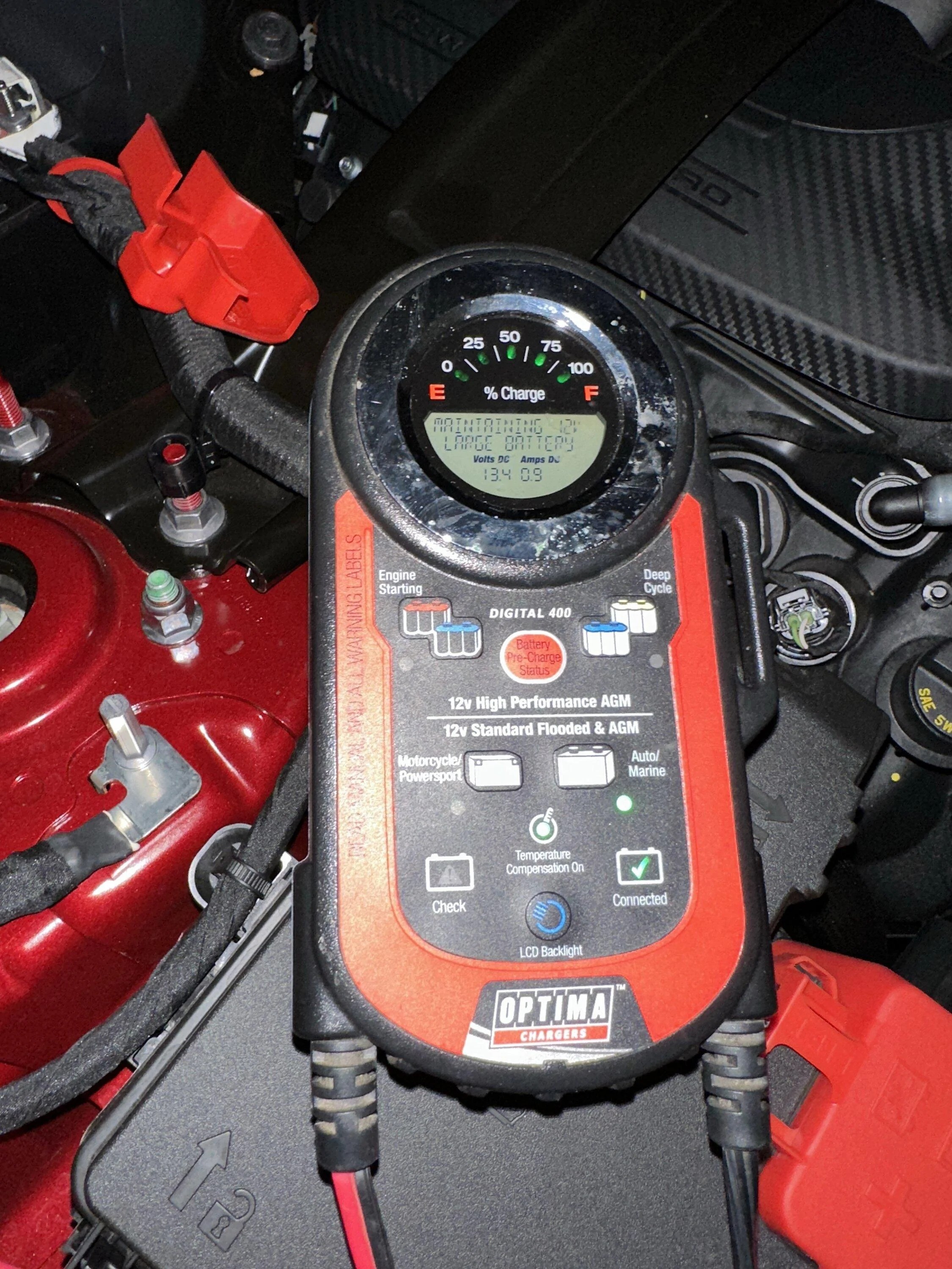

less than six weeks sitting in the garage, locked and untouched.
The batt is now fully charged but since I haven’t started her the deactivated state is still active.
S650 Mustang Greeting, Pony, remote features disabled IMG_0918

Understood. Although not sure. Was built on 8/16/23. Received the remote features disabled after a 600+ mile drive. In fact received the message twice during that trip (both the following morning after a morning greeting).
I’ve charged the batt at least twice now so yeah most likely a bum cell. But didn’t notice the greeting being disabled until just this last time charging her and wasn’t sure if it was an indication of something more amiss or just part of the ‘remote features’ being disabled - being a local function / action and what not. I can understand and appreciate the self preservation function just wanted to confirm nothing more is beginning to go awry.

hoping but did not test / verify the alarm doesn’t go away as well.
Doesn’t seem to be charge state since greeting didn’t reactivate once the battery reached 100% and went into maintenance mode.
