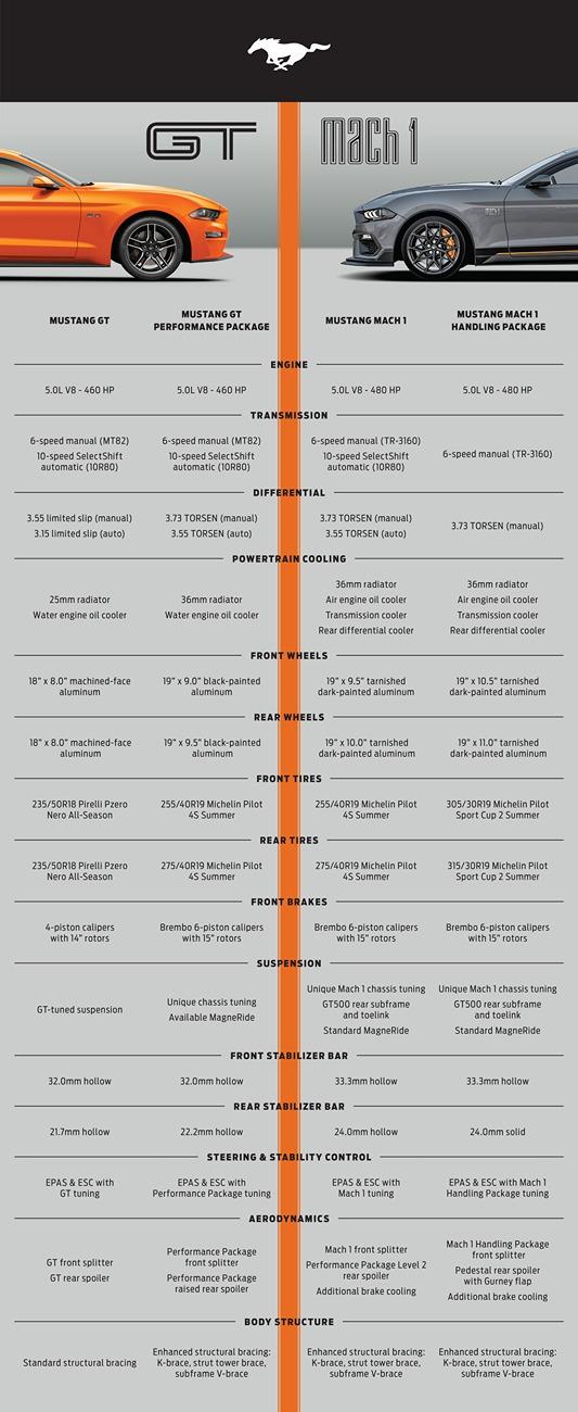

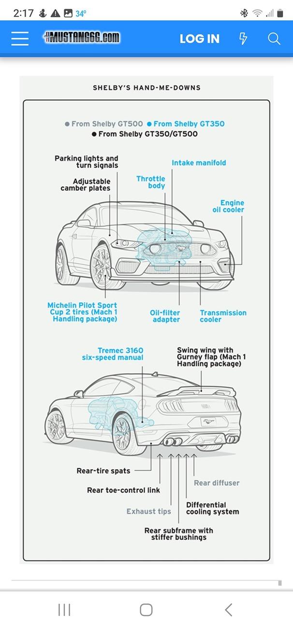

I haven't noticed a similar comparison, but I'm attaching some files published when the Mach rebooted; these highlight the main differences.
There are practical considerations, such as drivetrain components. For someone wanting a factory-built, warrantied, integrated system of performance components, the DH might be the best route. For someone tracking more often or building a race-only car, a DH might not make any sense at all. A stripped-down GT could be better, then purpose-built to suit their needs. It depends.
Then there are the subjective reasons, to include the uniqueness. It's why someone buys a Z0# or an 8-series when they'd rarely exceed the capabilities of a more available model. Countless reasons, most often specific to those individuals.
I cannot speak to pricing on the S650. I've never attempted to do a GT-to-DH $ comparison. Thirty large is a huge step up for any person, any make and model.
