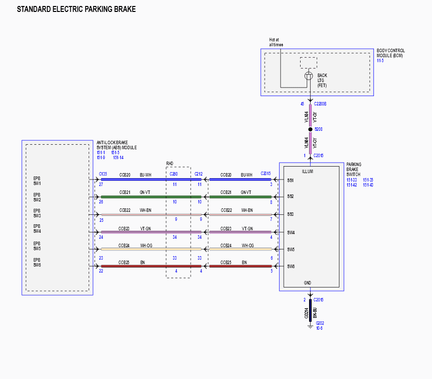

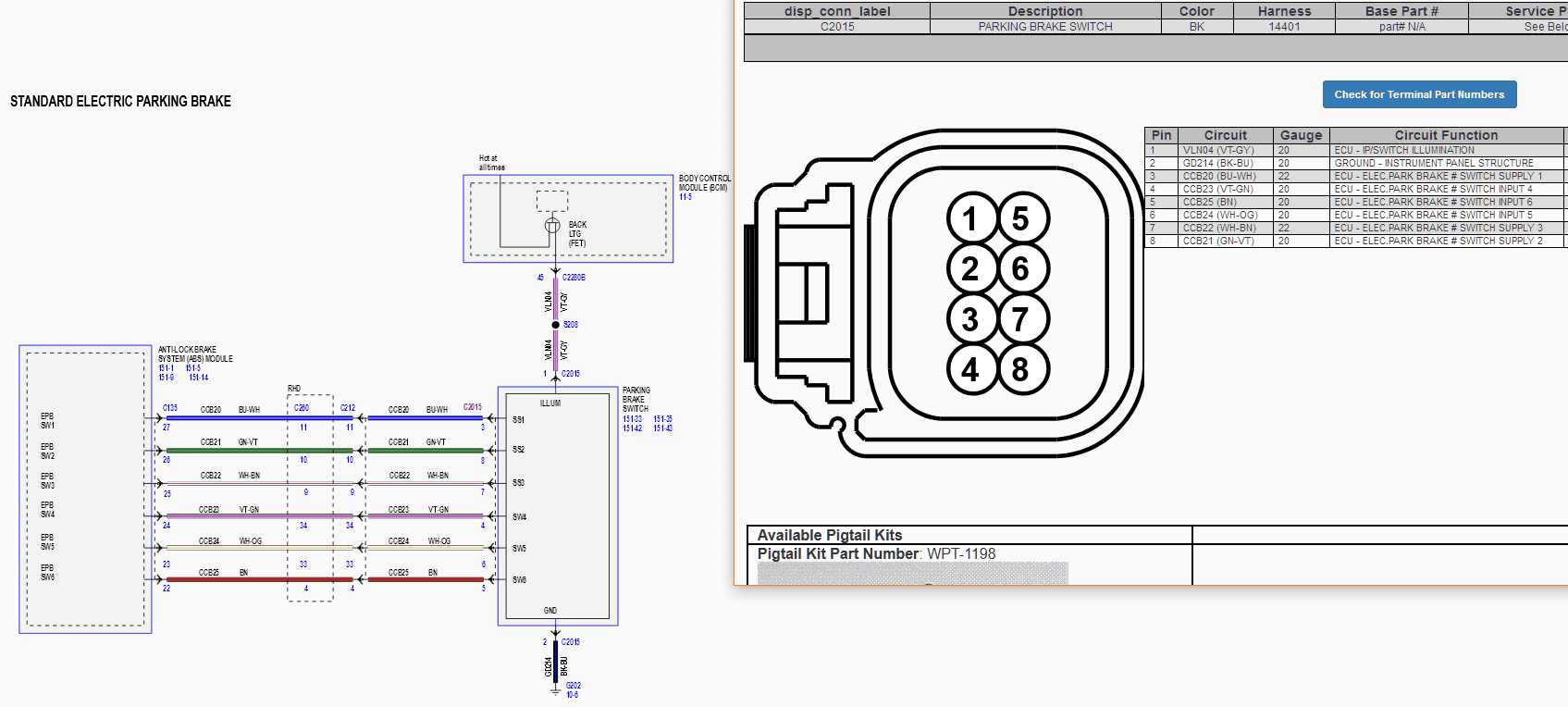

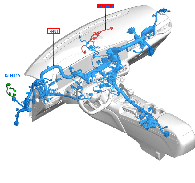

got some bad news for anyone who was looking to do the drift brake conversion. it's very hard. and expensive. the wiring harness that connects to the little switch has much different pinning compared to the drift brake, and that harness is a huge one that spans the whole dash and center console. replacing it is nearly $800 in parts and many, many hours in labor as doing it requires removal of the whole dash. the wiring in question is the blue one in the picture below

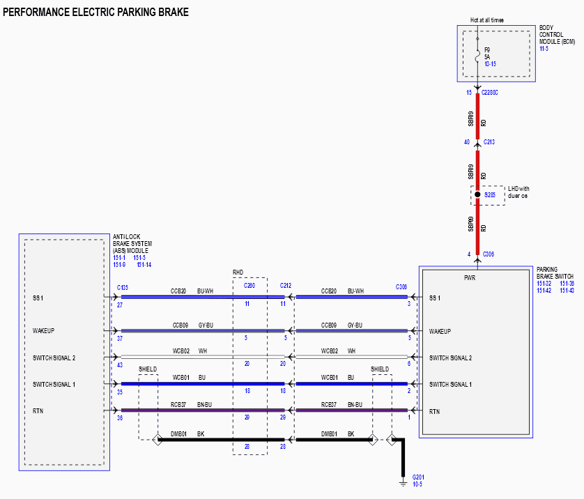

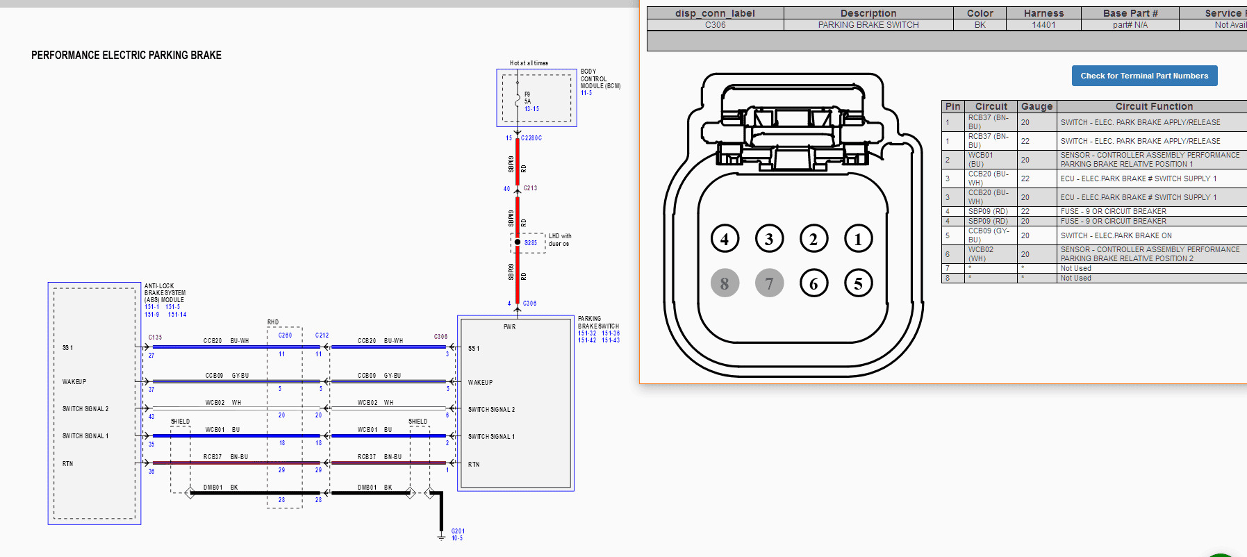

plus, the ABS module looks for specific signals from the drift brake, as can be seen in the wiring diagrams below
basically, unless money is no object and getting a different Mustang with the drift brake is out of the question, it's not worth it.

you got me thinking, so i took a look and it seems that all the main connectors have the same amount of used and unused pins with the same usages, maybe it could be re-pinned? in any case, here's some diagrams if you want to try that
