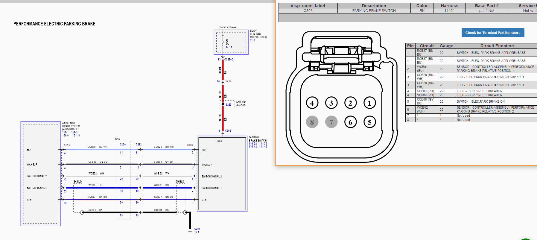

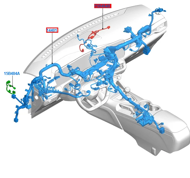

got some bad news for anyone who was looking to do the drift brake conversion. it's very hard. and expensive. the wiring harness that connects to the little switch has much different pinning compared to the drift brake, and that harness is a huge one that spans the whole dash and center console. replacing it is nearly $800 in parts and many, many hours in labor as doing it requires removal of the whole dash. the wiring in question is the blue one in the picture below
S650 Mustang Experimental Brembo Brakes Retrofit Kit 1707018020479

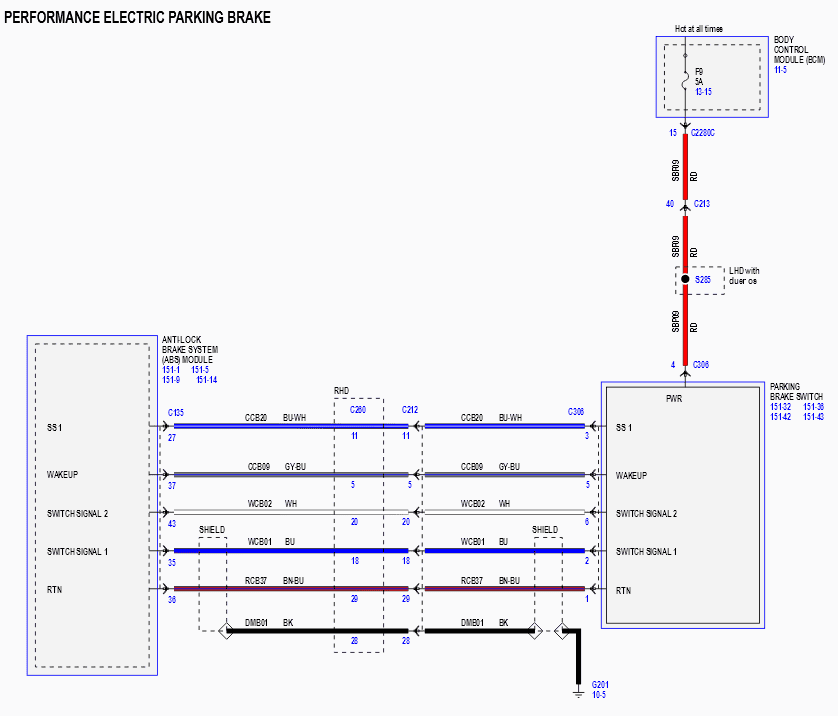

plus, the ABS module looks for specific signals from the drift brake, as can be seen in the wiring diagrams below
S650 Mustang Experimental Brembo Brakes Retrofit Kit 1707018170725
S650 Mustang Experimental Brembo Brakes Retrofit Kit 1707018196362
basically, unless money is no object and getting a different Mustang with the drift brake is out of the question, it's not worth it.

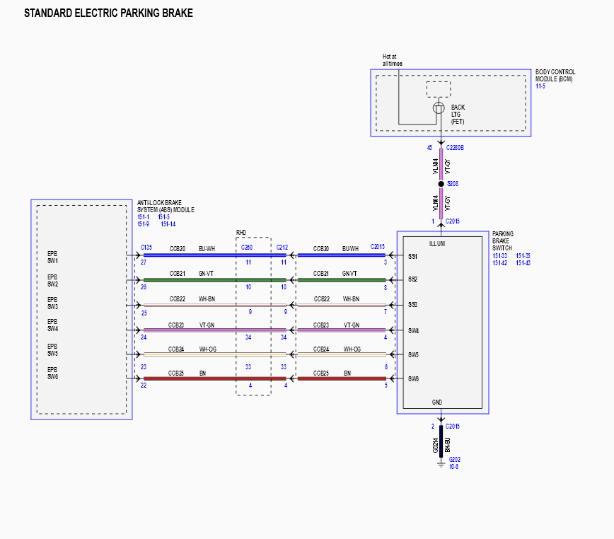

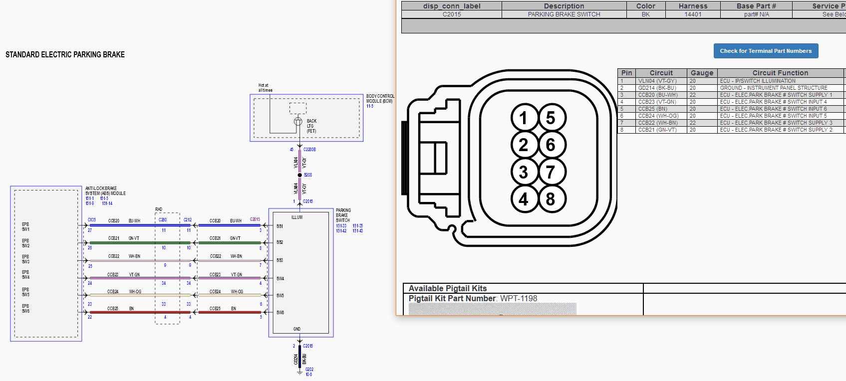

you got me thinking, so i took a look and it seems that all the main connectors have the same amount of used and unused pins with the same usages, maybe it could be re-pinned? in any case, here's some diagrams if you want to try that
S650 Mustang Experimental Brembo Brakes Retrofit Kit 1707201200393
S650 Mustang Experimental Brembo Brakes Retrofit Kit 1707201295275
as for where to find the diagrams, to my knowledge they cannot be found randomly online
Thank you for these, Going to give it some study. It just seems in this day and age of prewiring for everything and cost savings, for them to make an entire new dash harness seems a waste of resources. Typically manufactures would put this on a pigtail, where they only need to swap out the sub harness for the differing brake offerings.
I think the electronic parking brake switch is my one major annoyance of the car. I could find no manual 401a gt models with the performance pack and drift brake in my area.
I did find a black one with the brembo option, but normal parking brake switch. I almost picked it, but the vapor blue is such a better color. It had the same options minus the brembos.
Hopefully this conversion is doable, I don't see why it can't be done for a reasonable cost.
