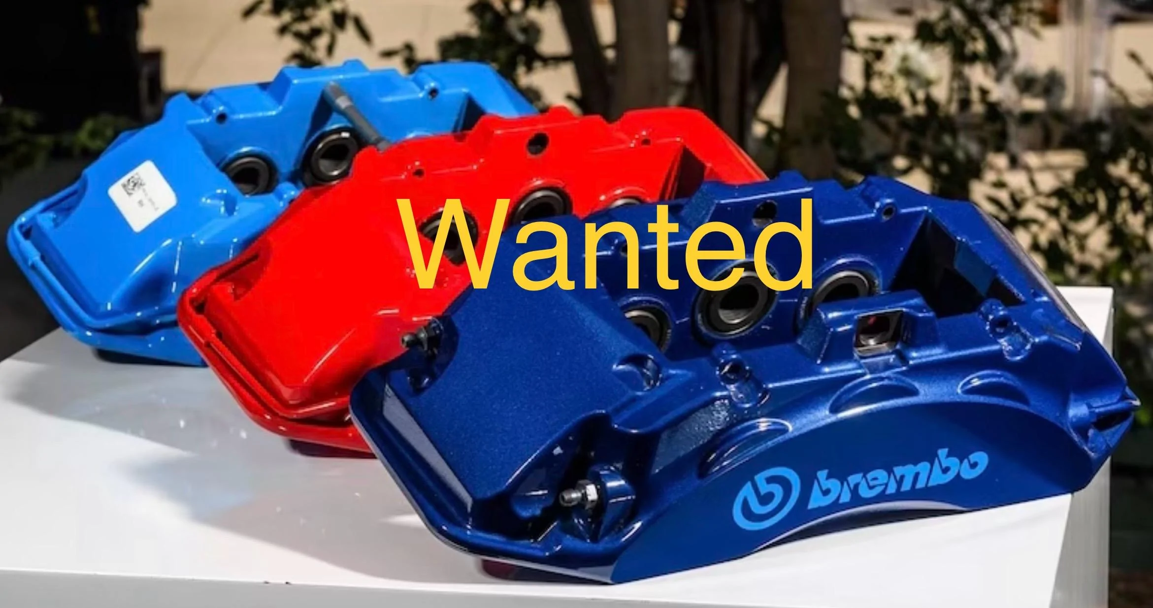

I’m looking for take off front 6-piston calipers and rotors if someone finds a vehicle set and only wants the rears.
Check eBay. I bought a pair for $300 w/ dust shields.
