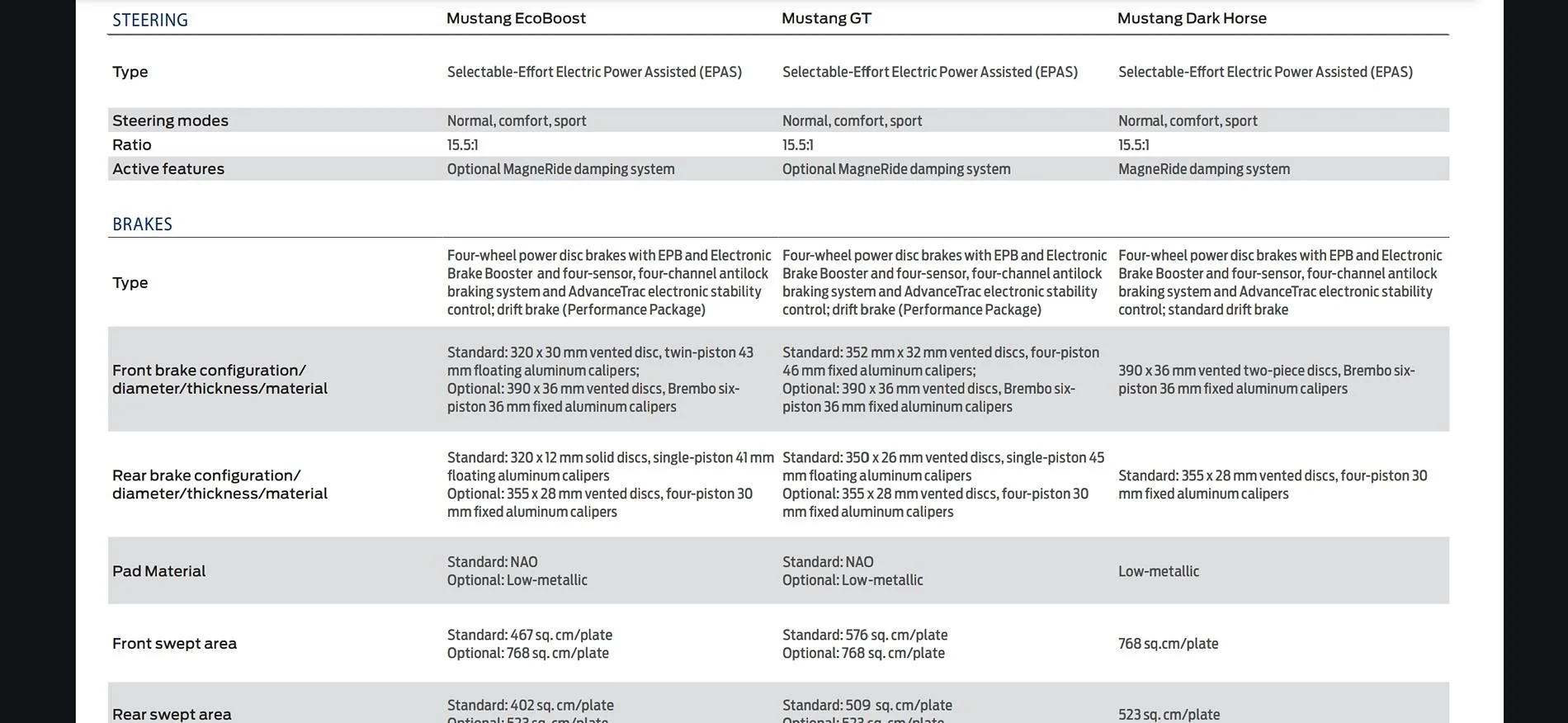

390mm 6 piston front 355mm 4 piston rears same brakes as the Dark Horse R
I don't think that would be an upgrade. The standard GT brakes are already 17" rotors.
The stock GT fronts are 14" 4 piston and rears are 13" single piston
No way, the upgrade from Ford is 15.4 fronts.
