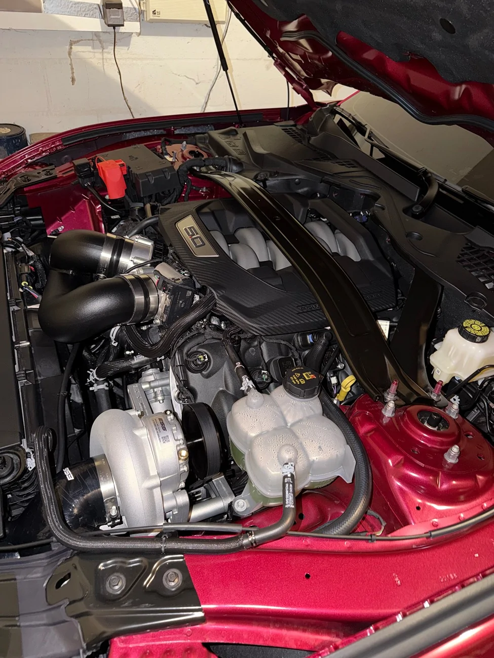

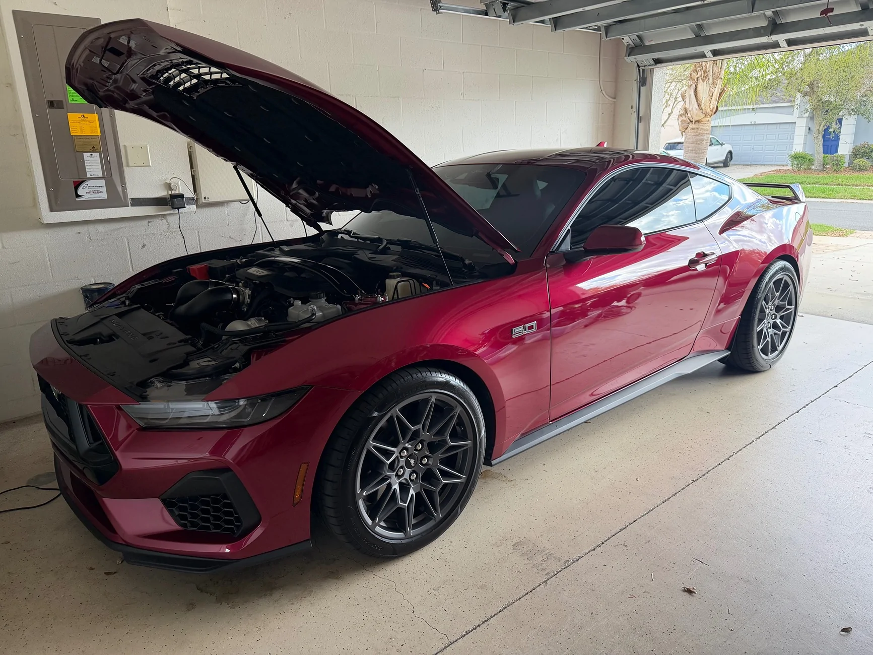

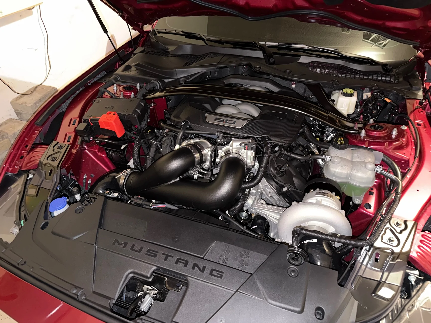

Yes after 10 long weeks, it showed up. I have decided to let a trusted shop do the install. They did my whipple Gen3 and it was perfect.
Install is Thursday. I already have my base tune written for it. I will be street tuning the kit all weekend.
The plan for this is to just do the base G3 kit with all the base options. No fuel system or injectors. Just as cheap as possible - on 93.
Once I get my base tunes for 93, I will see how far I can push the completely stock fuel system with e20/30 and if it will take it, e40.
Then I can start doing my ghost cam and pop flame tunes.
I figure the majority of folks will need tuning for the base kit on 93. After all this and some track testing, I'll order up Derel's fuel system and some ID1050x injectors and see what I can do on E85 with it. Should be fun@@
I'd like to run 9s on pure 93 with nothing but a drag radial or full drag pack. That would be a great formula for folks looking to get into the 9s with a modest investment.
Im sure like the gen3, this kit will be the top seller going forward. Mine was $6900 delivered from Graveyard performance. G3, 120mm pulley and all the default options.
UPDATE:
Going well. I’m tuning it slow on the street. It absolutely rips on a conservative tune.
