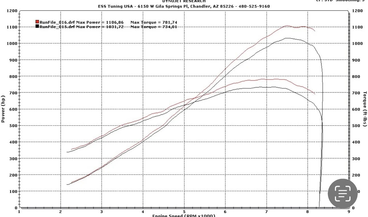

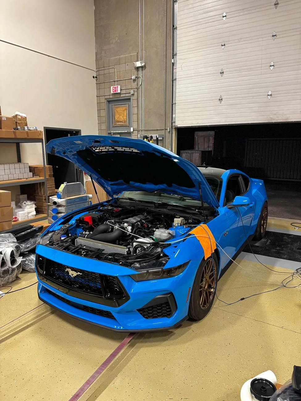

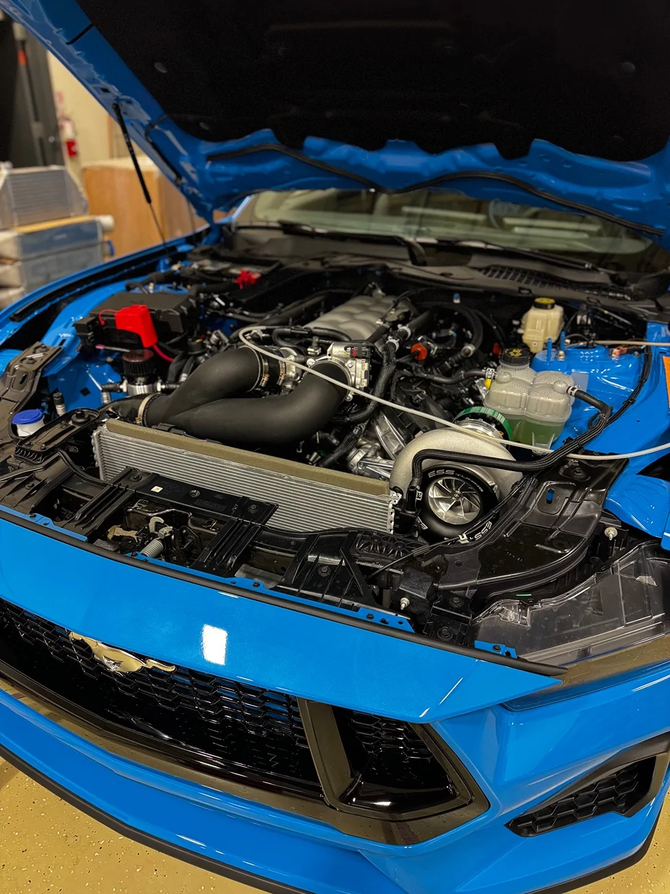

UPDATE:
We made a few changes to the S650 test car, this time around we added the following:
G3R head unit
Fore fuel system
Headers
8 rib drive system
This is still a 100% factory sealed engine! factory OPG’s and IMRC.
S650 Mustang First production ESS S650 kit has arrived! IMG_6049
S650 Mustang First production ESS S650 kit has arrived! IMG_6013
S650 Mustang First production ESS S650 kit has arrived! IMG_6014

I guess I should have asked in this thread, but I did not see it prior to the other one.
What fuel?
What PSI?

What was SAE numbers? I’m always confused on the differential between them
Definitely awesome!!

No inlet tube and no air filter. Would like to see what it makes the way 99% of us drive, i.e. with a tube/filter.
Most people won’t push a car this hard and especially not on a stock engine. This was just to show what it’s capable of in a race application. But throughout our testing it would make 30-50 less with the inlet and filter on it.
