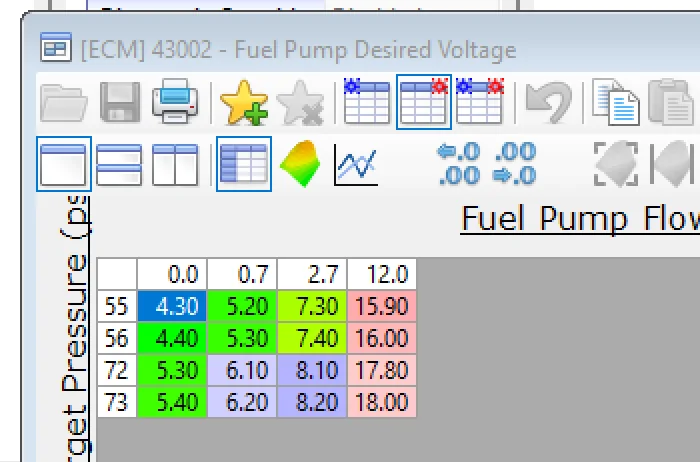

The more I refine out the tune, the worse the low side pump pressure gets. This is bad. @Brevin I think it should be mandatory you get a BAP or fuel system with this kit. I have been working this for a few weeks now and its crystal clear, this car does not have enough pump even with good injectors to support 93 with the 120mm pulley. Im still seeing good high side, but the pump is dying and on an aging car with an older pump, this is a catastrophe waiting to happen. I might try a BAP for now, but I think a fuel system is mandatory. Which is strange the whipple guys are getting away with it. I dont quite understand that. Maybe Im missing something?
Must be, fuel system is definitely overkill. A BAP is all everyone used for Gen 1, 2, and 3. Mine held great on the 120 and 93. Made 733whp. The whipple guys have been running 93 and 13-14 PSI for years now without a BAP and on 55lbs injectors. I’m not sure what the deal is.

Glad you’re having fun, she rips.
Just FYI, you don’t need a BAP for that setup, there’s a few things you still need to figure out that will help. We were able to keep pressure rock solid on that setup and it had room for more.
For sure Im still working on it. But its not looking good from what Im seeing. Trying not to lean into the stock pump with too much voltage though. Im sure it would hold if I push it to 18v, but should I? Lol might work for now but how about long term. As I said, its still a work in progress. But man its fast now. Very impressed
That’s a good question. I’m not sure what the whipple calibration does but they don’t even include a BAP for the stage 2 kit. They must up the voltage a fair amount.

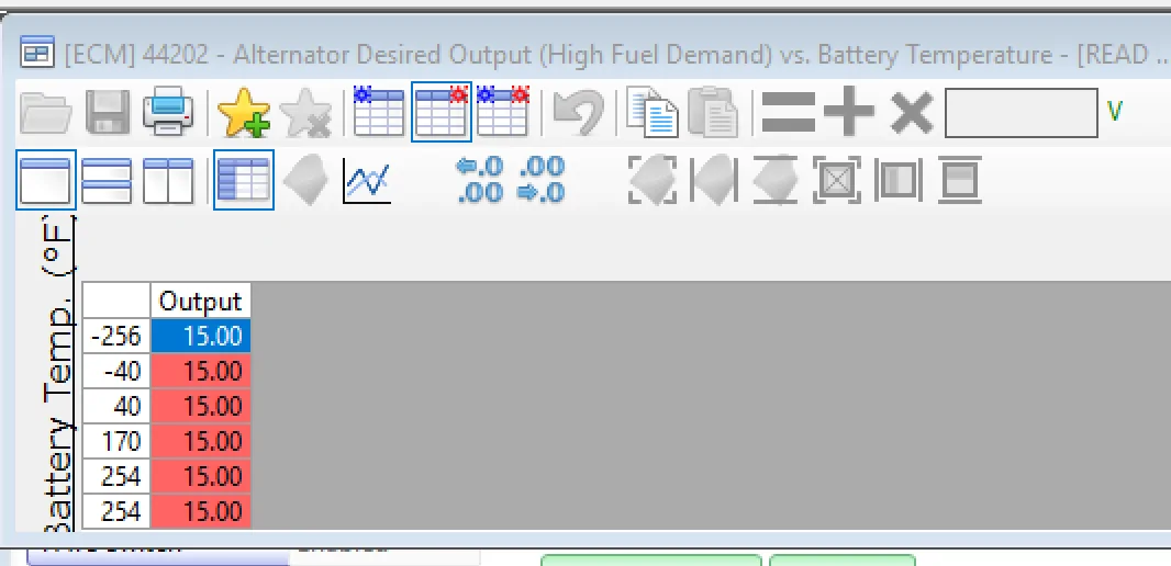

They do to 18 and they also push the alternator to 15v in all alternator scenarios. Thats a wow really thing I see.

did you end up doing anything with fuel supply besides upping voltage and installing the bigger injectors? i wasn't planning on going past the 120mm either.
No, just lots of tuning magic to massage up the low side to keep WOT pump pressures.
I still dont see the "tons of headroom" on the pump side that has been said here, but its more than fine at these levels with a good set of injectors. Once you unleash the low side voltage and allow for more duty cycle, it comes up nicely. My opinion is its good for the 120mm pulley but you'd need a BAP at the very least to get you over the next hurdle.
And for the $1500, Wengerd's fuel system is worth it. No looking back then with that and some FIC1000s or the ID1050x injectors. Then its pulley down and fill up on E and send it.
