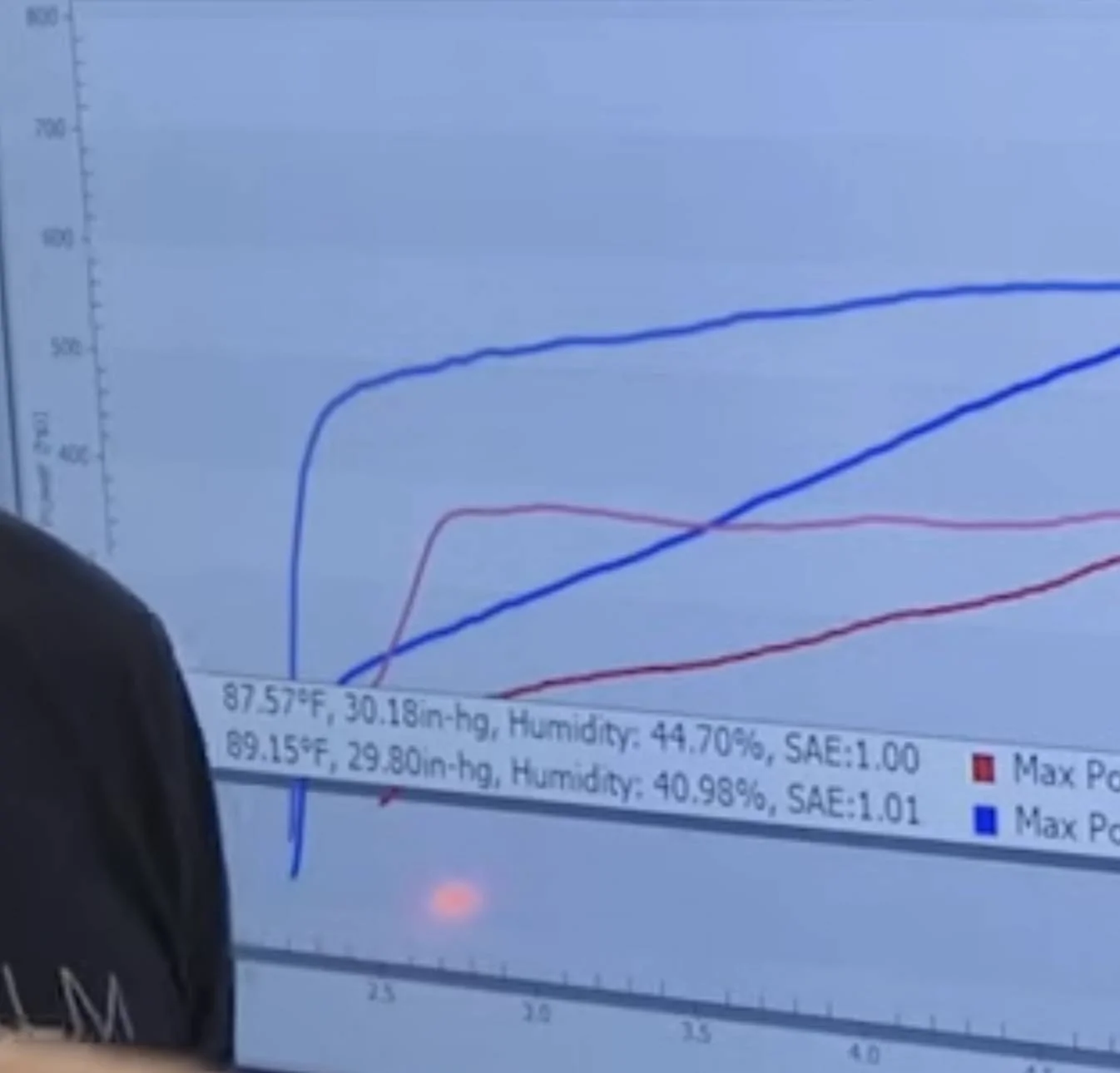

If you want me to back off and say "noticeable" torque increase, so be it.
150 to 300 is a jump. And please Mustang aficionados, I don't need to be schooled on centri versus pd.

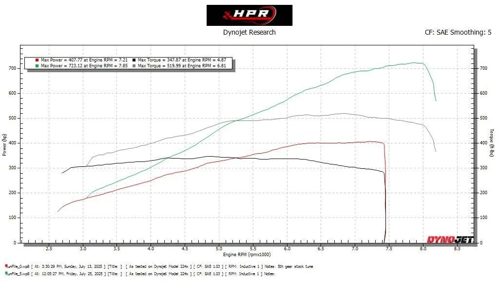

if you're going to compare numbers, at least be accurate.
Where is this 150 to 300 jump at 3,000rpm you're speaking of?
It's only adding about 50ft-lb at 3k
takes it from 305 to 350-ish
Edit: added a cleaner image from them
