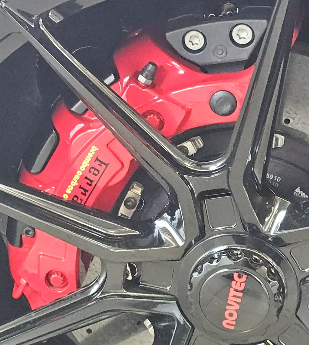

the reason why the parking brake is in the mini caliper, from what i can tell, is because parking brake calipers are restricted to being sliding calipers instead of fixed ones. this started on Fords with the 2017 Ford GT and spread to the 2020 GT500, both vehicles with 4 piston rear brakes but electronic parking brakes. as for why most electronic parking brakes are sliding calipers, i have no idea, but my best guess is the potential issue with driving multiple pistons with one motor plus the fact that you would need a motor on each side of the caliper to apply both brake pads on a fixed caliper. exotics do some trickery where they hide the parking brake caliper in the main caliper body, but it's still technically it's own thing. example picture from a Ferrari F8 Spider, ~$450k vehicle
S650 Mustang Dual rear calipers? I’m a moron 1760241584844-96
and also, from my understanding, the drift brake actually uses the main rear caliper via telling the ABS module to apply the rear calipers in varying pressures, hence why it requires the vehicle being in track mode where traction control is off and stability control is very passive
