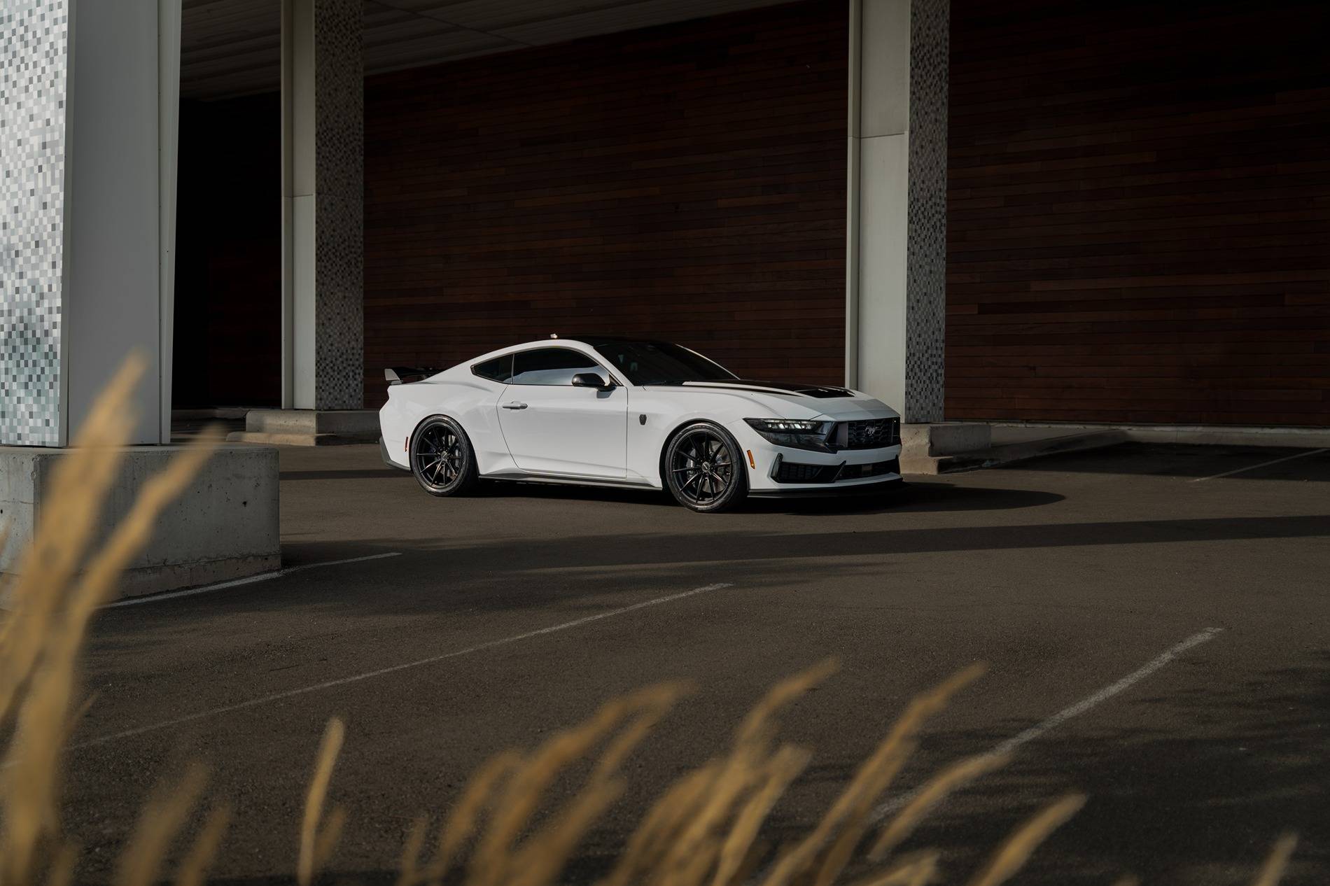

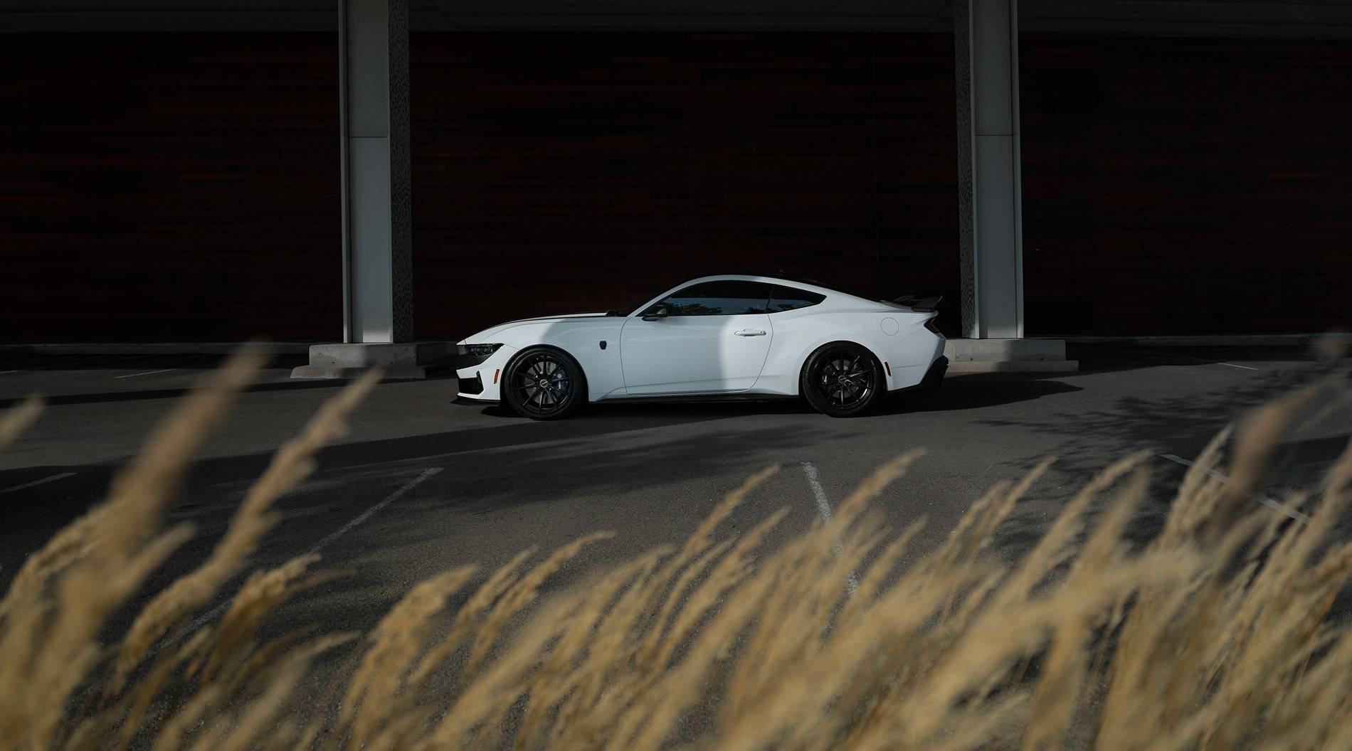

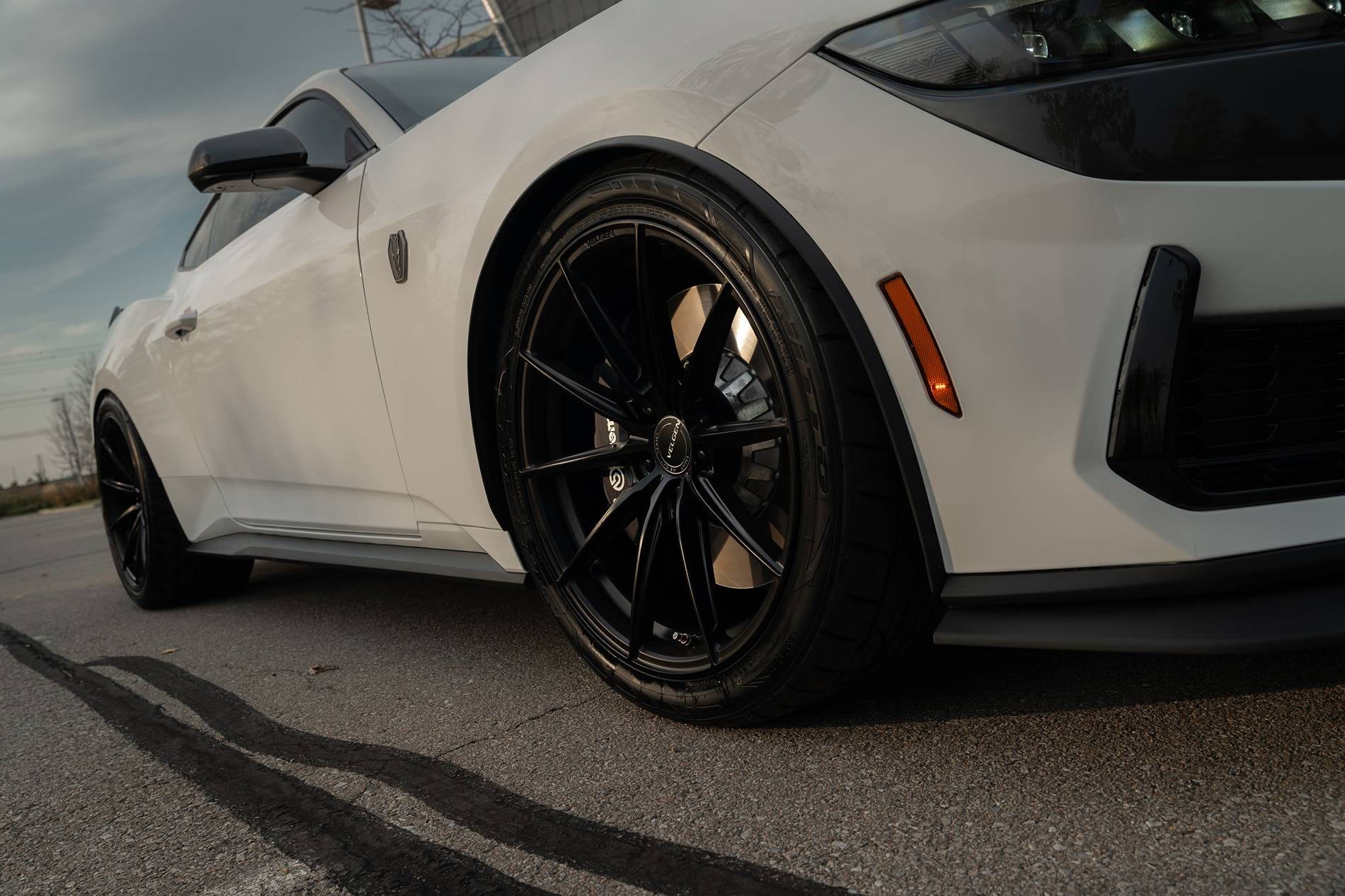

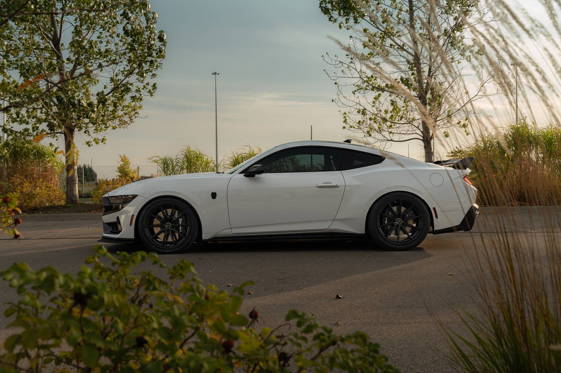

Here is how a Dark Horse (with HP) sits with Steeda Sport Progressives, 20" rims and 285/35R20 and 315/35R20 setup.
I haven't noticed any rubbing yet.
There is about a finger of gap between the top of the wheel (on both front and back).
Very clean setup and I've had many compliments on the results including random peeps doing rollers as I drive down the highway.

Looks nice, I’m running the ultimate dual rates so my front end will Be a little lower, what offsets are you running and rim widths?

Rim are 10 front and 11 back. As for offset. I’ll have to check my receipts from Velgen when I get home and see.

Fronts are ET34
Rears are ET52

The white is perfection for this Dark Horse - a favorite color for sure!
