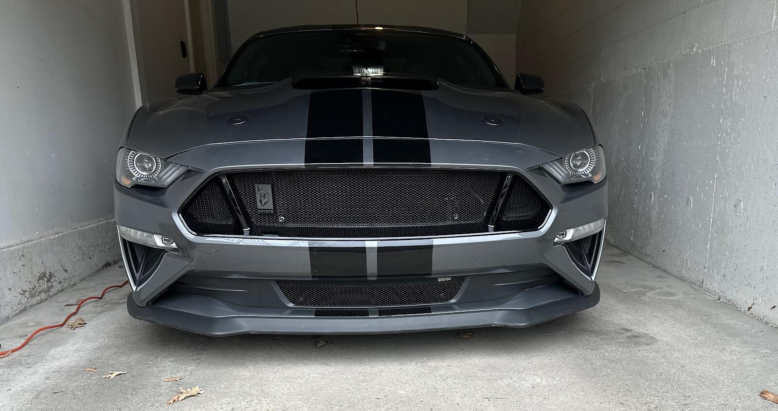

2021 GT Premium (with PP and Supercharger)
Had DUAL RATE ULTIMATE HANDLING SPRINGS

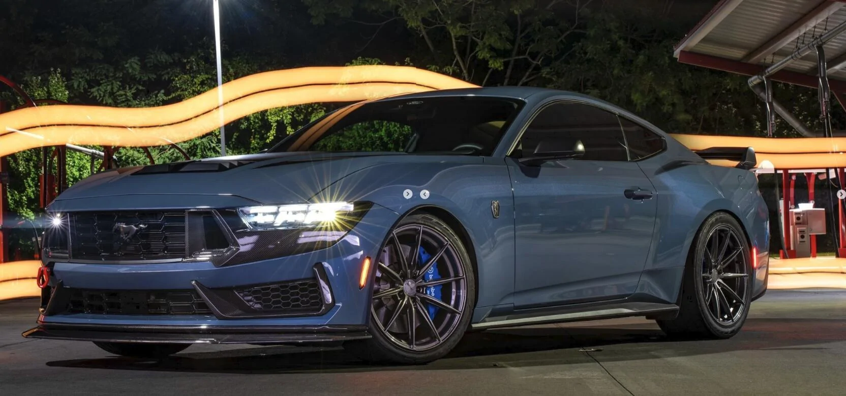

CHRIS C's DARK HORSE (spliced together from his Insta)
Has DUAL RATE UTLIMATE HANDLING SPRINGS

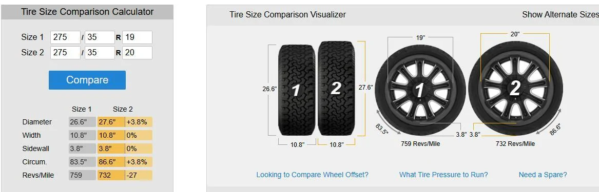

THE TIRE MATH
So basically....
- Drop the S550 0.5" on all four corners
- Not sure if the supercharger stuff would have made this a bit more or not. Maybe 0.6? 0.7?
- Never had issues with it hitting anything.
- Lowers the Dark Horse 1.3" in the front and 0.75" in the rear
- 275/35R20 in the front
- 315/35R20 in the rear
- Stance and Wheel fitment looks awesome!
THE TIRE MATH
So basically....
- The S550 had a 0.5" drop (may be more with the Supercharger kit installed) + a 26.6" tall tire
- The Dark Horse would have a 1.3" drop but with 27.6" tall tire
- a 1.0" height delta = 0.5" above the axle and 0.5" below the axle
- Net drop would be 0.8" which is only very slightly lower than the 0.5" (before Supercharger) on my S550.
